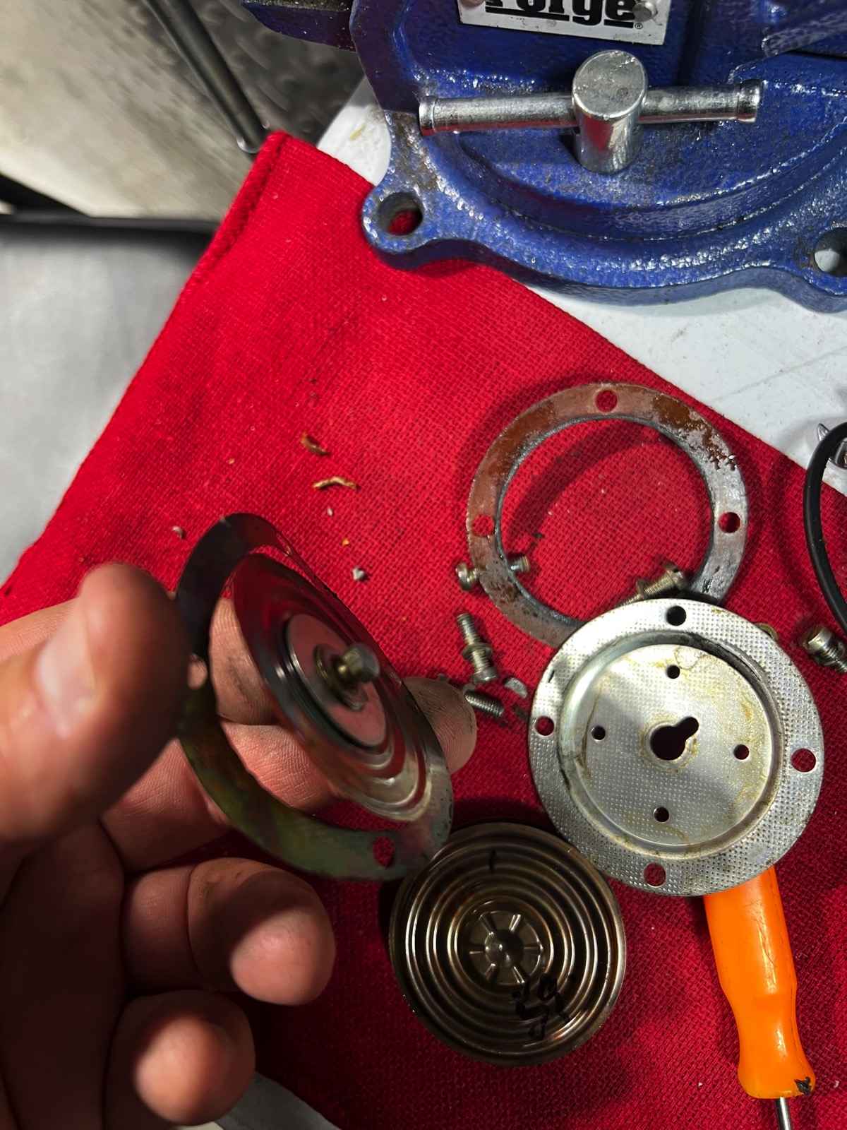

Good news. I ordered Tangerine's MPS rebuild kit. While waiting for its arrival, I tested mine for Vacuum. Zilch.
Took it apart (it appears to have been rebuilt before) and take a look at the diaphragm. A total loss.
So Thank you for pointing me in this direction, I think this will be a HUGE step to getting it running. I also appear to have had the wrong Head temp sensor, so I sourced what I believe is the proper one and will install this weekend, hopefully in conjunction with a rebuilt MPS.
Ill keep you posted. Click to view attachment

In your first post you said your “MPS holds vacuum”.
That later changed?
Robarabian
Yeah, I didn't give it long enough when I tested it. After a minute it bled down quick... When I went through Pbanders article like 5 times, I started slowing down and following it closer. I am novice at this part, so learning.
So when I disassembled the sensor, that diaphragm began to crumble in my fingers....
