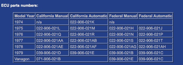

wonkipop
@rick_cv
this probably answers the question on ECU compatibility with other VW L jets.
from ratwell's bus website.
there is a bit of a mystery as to whether there ever was a 74 bus for california with L jet, despite CARB documents with approval for one.
but the california air resources board approval was granted for one.
manual only with the 022 906 021F ECU.
so who knows.
but ratwell says for 75
there are two different bus ECUs.
022 906 021H is for the federal bus with a manual gearbox.
022-906-021J is for the federal bus with an auto box.
i'm guessing the ECU must be different for manual v auto and is not interchangeable.
if they were they would just list the same ECU? confused24.gif so must be something different in the mix.
i can tell you that the 412 one listed as 022-906-021F was only ever in automatic gearbox equiped 412s. the L jet was only installed in auto gearbox 412s.
using bus logic of ratwell that F ECU isn't going to be good for a 74 1.8 (or in your case a 75 using 74 parts).
i do know my aussie colleague @nihil44 up in brisbane has been having a go at assembly of an L jet system on a 76 model he has using various bus parts, ECU ?, AFM? etc but i don't know if he has achieved success yet. he was having some trouble making it run properly.
if he reads this he might give you his thoughts.

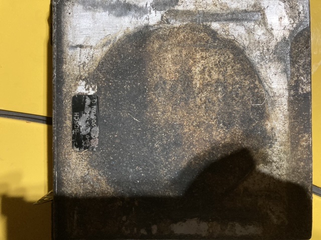

@rick_cv
Turns out I have the “G” ECU. No idea where it came from, since I had a 1970 which I converted to carbs many years ago. Anyway, it’s yours if you want it. Just let me know.

rick_cv
QUOTE(theer @ Sep 27 2022, 04:32 AM) *
QUOTE(wonkipop @ Sep 20 2022, 03:23 AM) *
QUOTE(rick_cv @ Sep 19 2022, 10:47 PM) *
Thanks for the info. I know 022-906-021G is the proper ECU for a 75 l-jet that I should use but still not clear if that works with the early 6-pin AFM. Maybe I will stumble across a complete system eventually and won't have to worry about this.
no mate.
that is a 74 Model Year ECU part # you are quoting. the 6 pin plug goes with that ECU. the 6 pin also goes into a 74 specific AFM.
the 75 model year ECU is part # 473 906 021. that goes with the 7 pin plug. the 75 AFM is also different and goes with the 7 pin.
but it will work on either a 74 or a 75 1.8 so long as you have the three things lined up.
the ECU, the harness connector and the AFM.
@rick_cv
Tom
That would be great! I will pm you.
