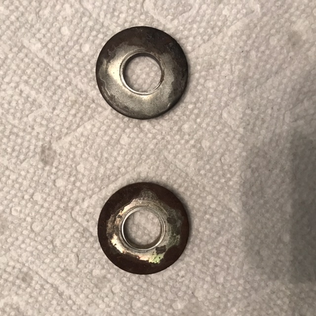

Another tact to my posting in the Classifieds for yellow zinc seatbelt anchor spacers might be to get the originals cleaned and replated.
Anyone here do such plating for two small parts? No need for a special run; can wait until a next scheduled run as I do have ones that will work, just not like factory OEM. smile.gif

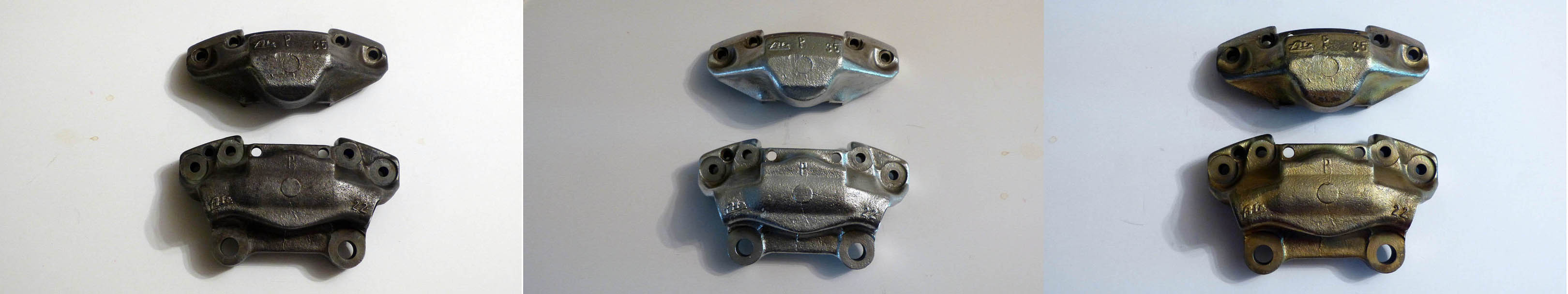

If you can't find any, I'd be happy to run them through my home-brew process. Been playing around with plating for a few months and still learning, so not perfect by any means, but hopefully good enough for use. Here's a brake caliper for reference. After cleaning, parts need a few strikes with zinc, then a dichromate dip for the gold color effect (and protection). Just let me know if you'd like me to give 'em a try.

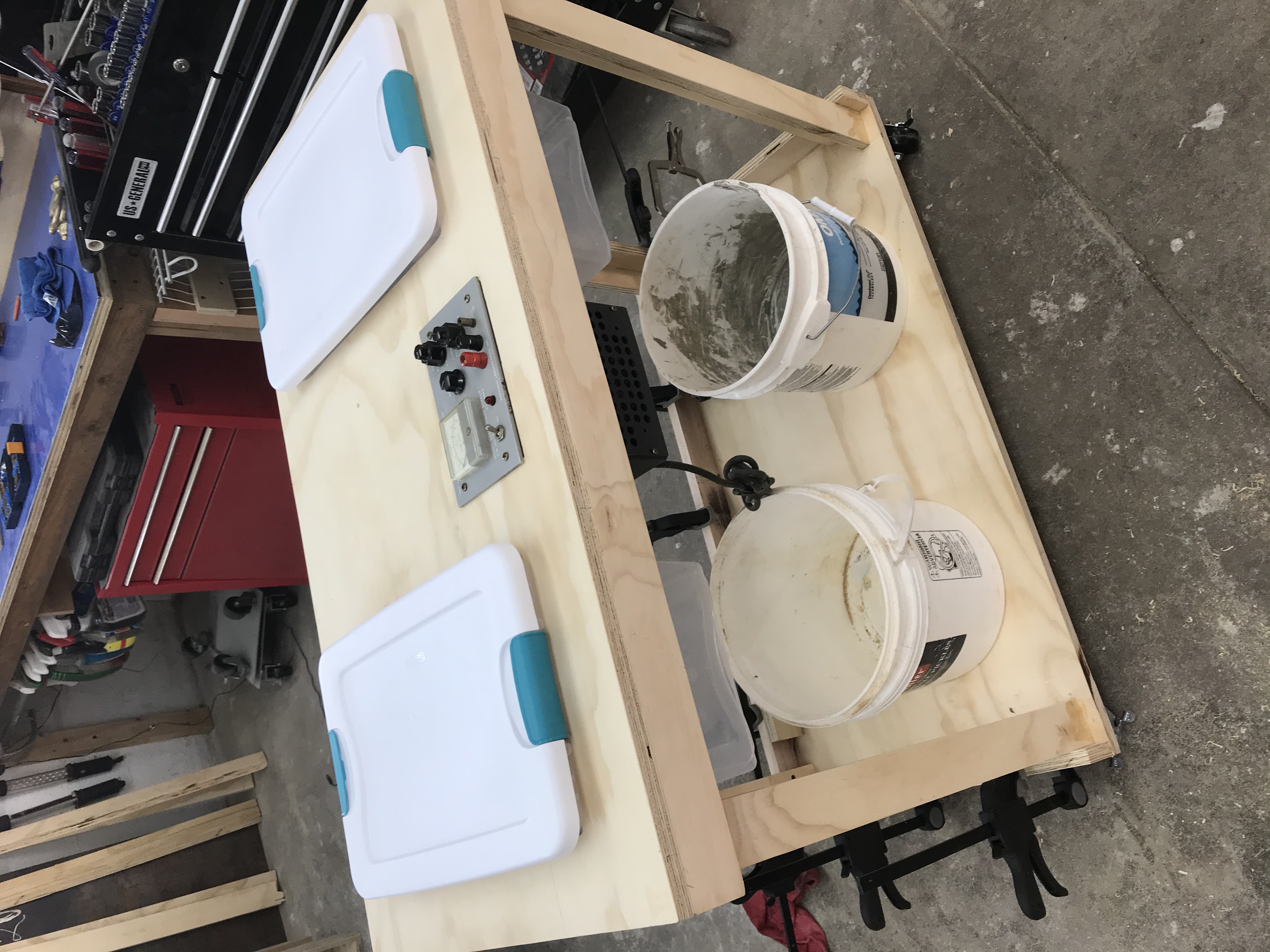

Built this plating system but have not perfected the process yet. I’ll let you know. I plan on doing a bunch. Click to view attachment

QUOTE(TonyA @ Nov 12 2022, 07:54 PM) *
Dan

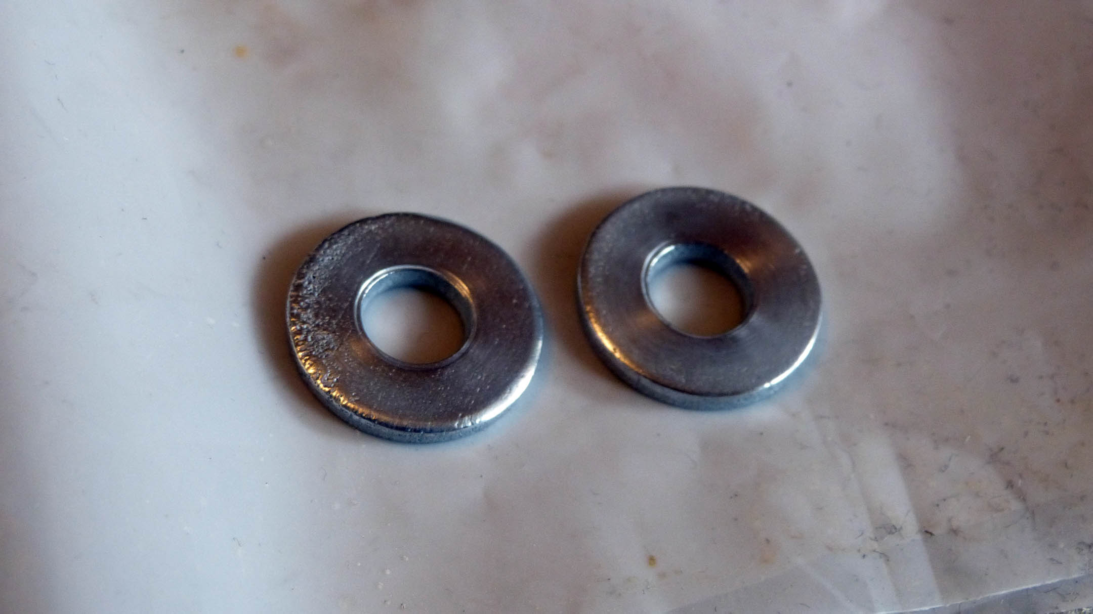

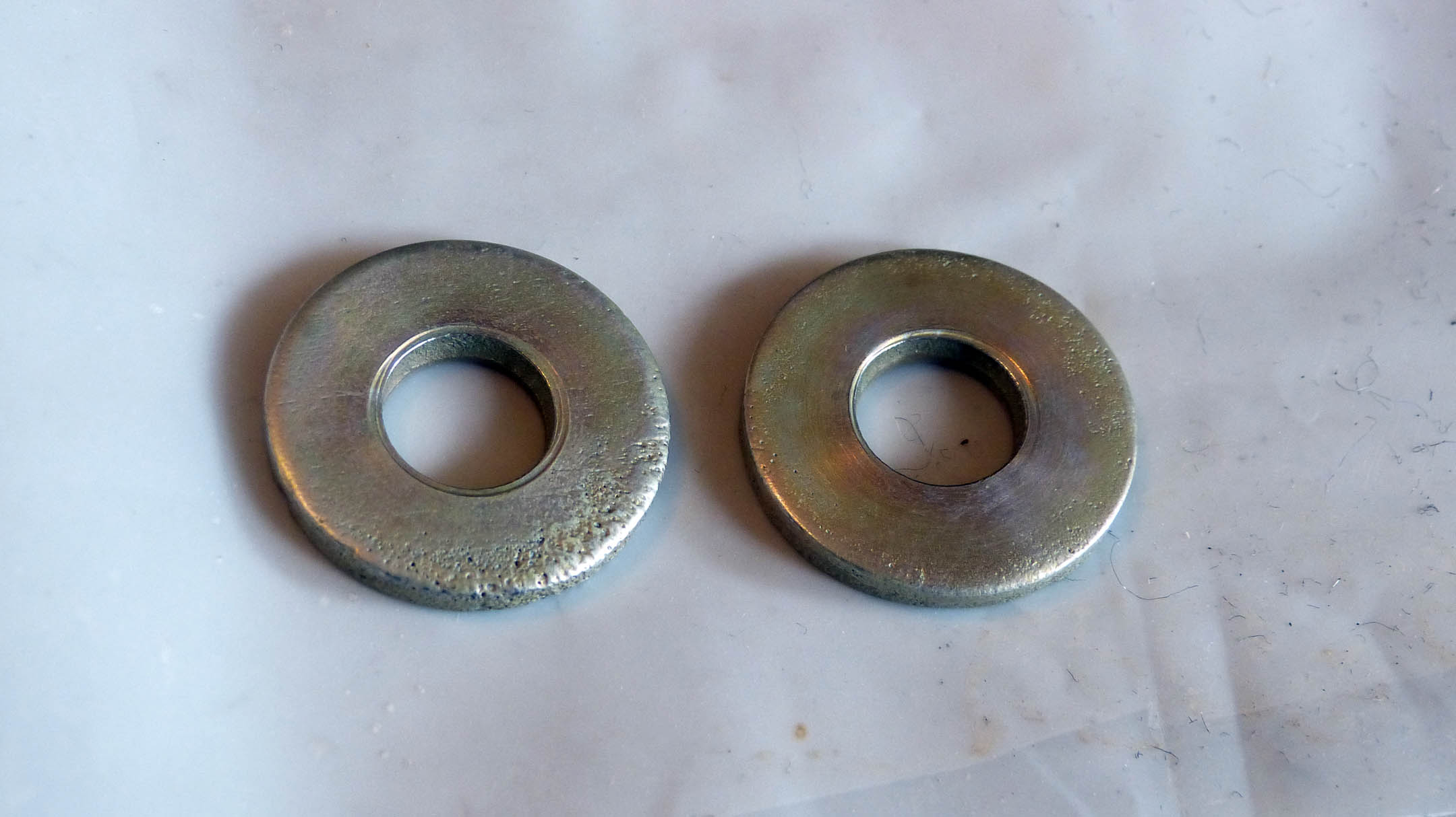

@mepstein Mark; any luck finding two nice ones (that’s what she said)? I found some near substitutes at the local hardware store and new ones are “significant back order”. The repeated ones turned out to be more pitted than realized. Thanks!

Steve allowed me to give it my best shot on these washers, but unfortunately after rust removal using diluted phosphoric acid, they were pitted badly. I did 4 layers of zinc, but it didn't help fill the pitting.
Unfortunately, with 914World dead, we had no way to communicate. I gave 'em a quick dichromate dip and just tried to get 'em back to Steve as quickly as possible. Really sorry they didn't turn out any better.
I really don't know a solution to pitting other than grind it down, or build it up with welding and then grind, but that's getting pretty involved for washers. Hopefully some new ones will be available soon.
