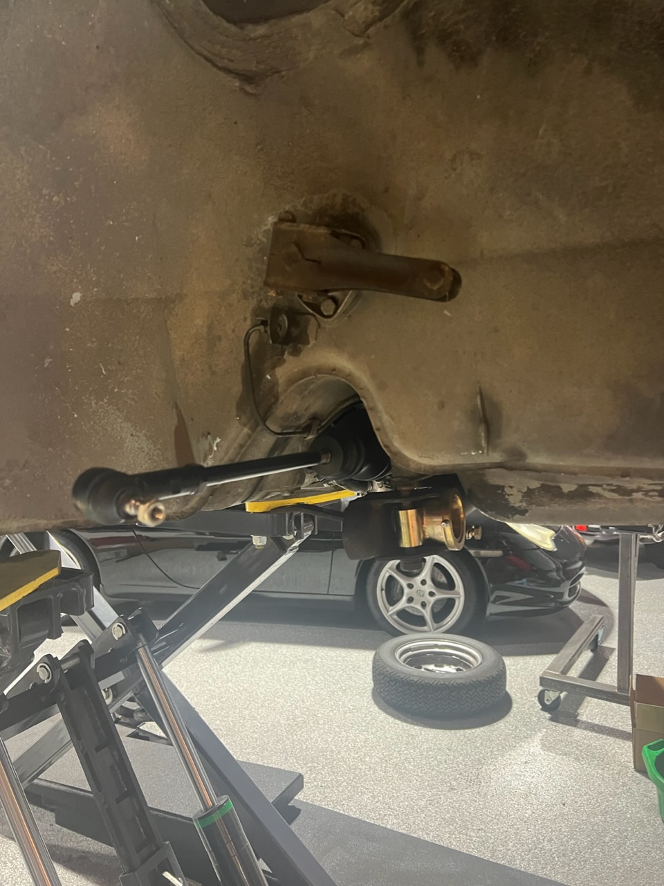

Motosan
Torsion bars were very stuck but turbo tie rods and a arms went on according to plan.
Motosan
Front end almost done, rear end started, and a very rusty/dented exhaust blasted/primed.
Couple of small bumps in the road but making progress!
