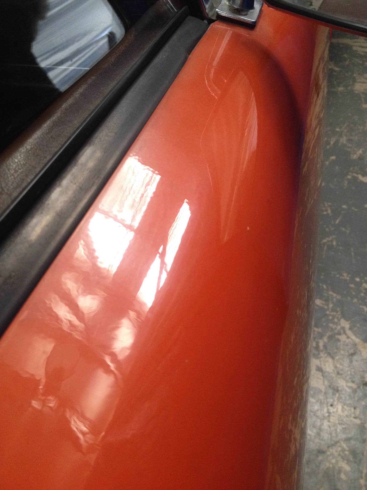

windforfun
There is virtually no orange peel on my 914. The paint is original.
wonkipop
QUOTE(windforfun @ Jan 5 2023, 11:28 AM) *
you are special then.
if you ever repaint it the painter is going to be happy too.
won't be tormented to recreate "shitty" moments in the paint shop at the factory.
truth is its probably been buffed out of your car over the years?
