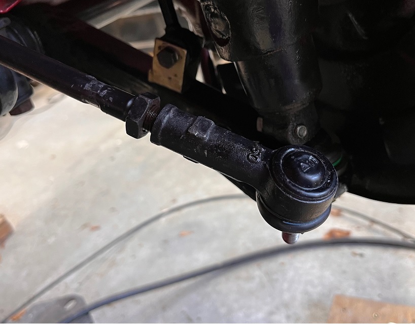

It's been well established that I am dumber than the average bear, but aren't the tie rod ends (on turbo tie rods) just supposed to unscrew off the tie rod? I'm not talking about getting the threaded end out of the control/pittman arm -- I've done that. I'm trying to replace the tie rod end. Heat, PB Blaster, but I can't seem to break it free. It's not easy getting leverage on the rod and the end at the same time, but I've put a fair amount of torque on there with no luck.
Any suggestions or thoughts?

What am i missing here? I've always used two long wrenches and you move them towards each other to break the end lose.
Both parts should allow for a wrench (forget which sizes, the two are different if i recall)
Can you post some pics of what you have?

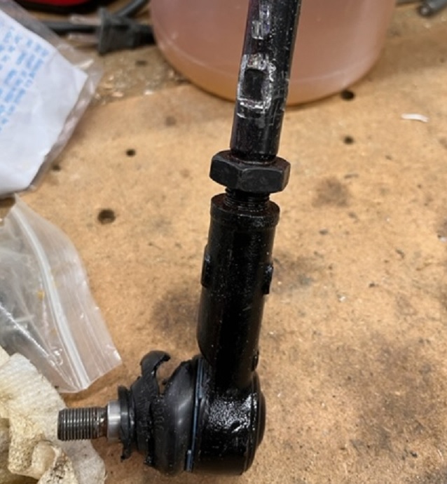

Here's the tie rod off the rack. The ONLY thing I can think of is if I put something like red loctite in there during assembly. But I don't think I did that, nor do I think I am that dumb. And I heated that b**** up pretty good trying to break it free.
More heat & more leverage.

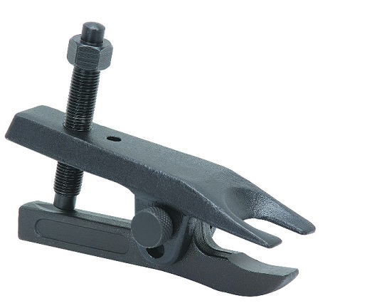

Currently waiting for delivery of the tie rod separator that kind of looks like the VW special tool (266h).
But I'm curious: car didn't even make it out of my garage. I torqued the nut to 33 ft lbs which I believe is correct. And that sucker is STILL in that control arm very tightly. It's a pinch fit, right? Is this normal? I was hoping I could coax it back out without too much force, but no luck without that tool I guess.

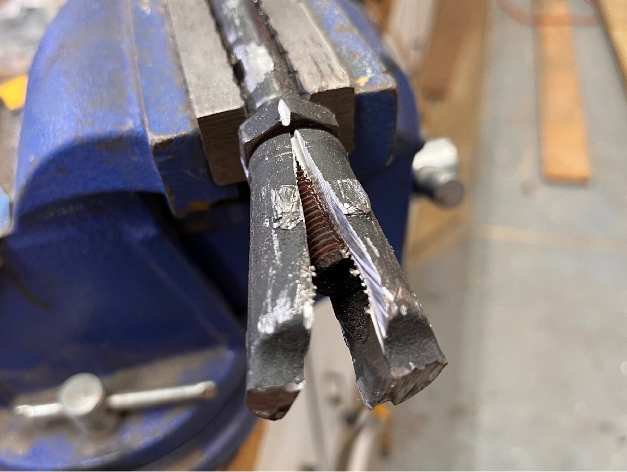

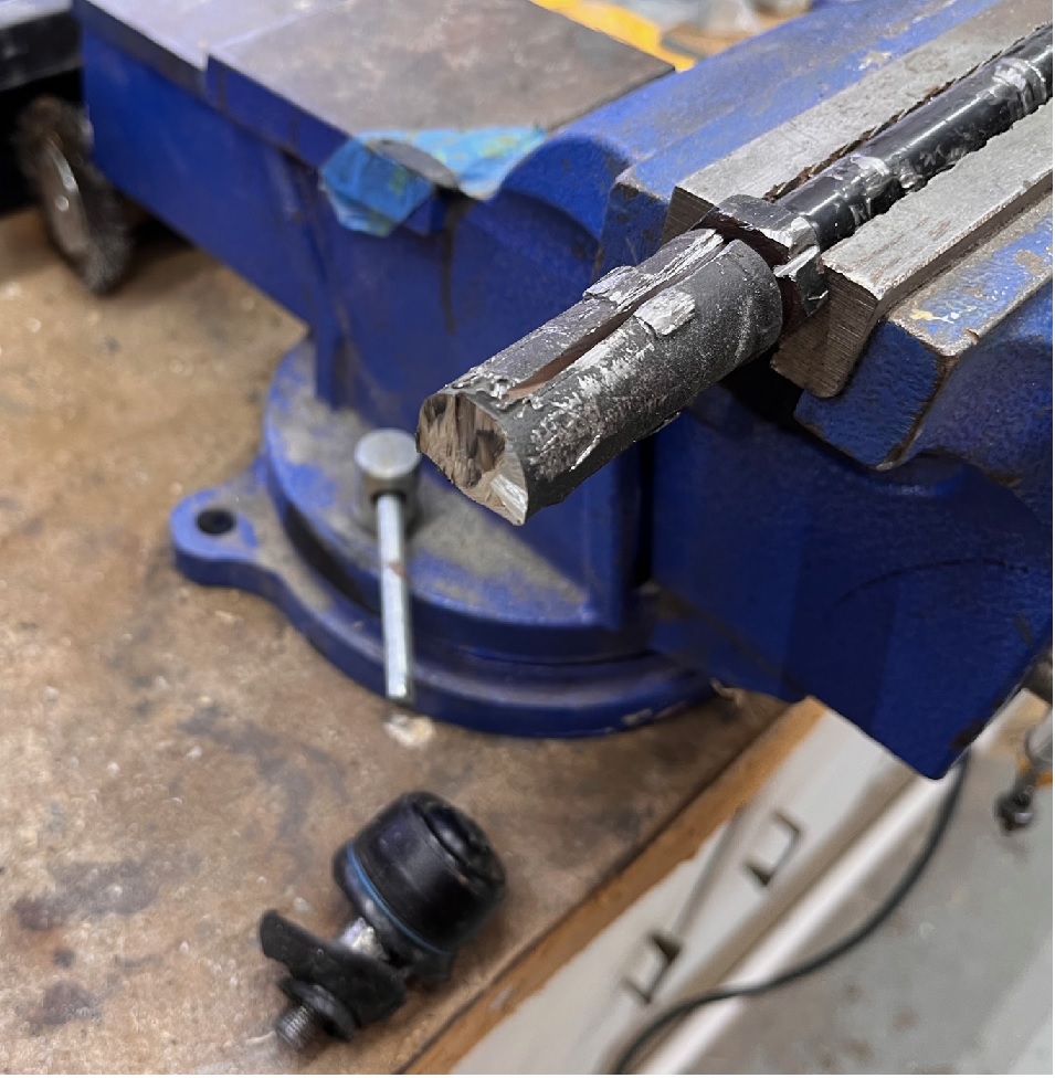

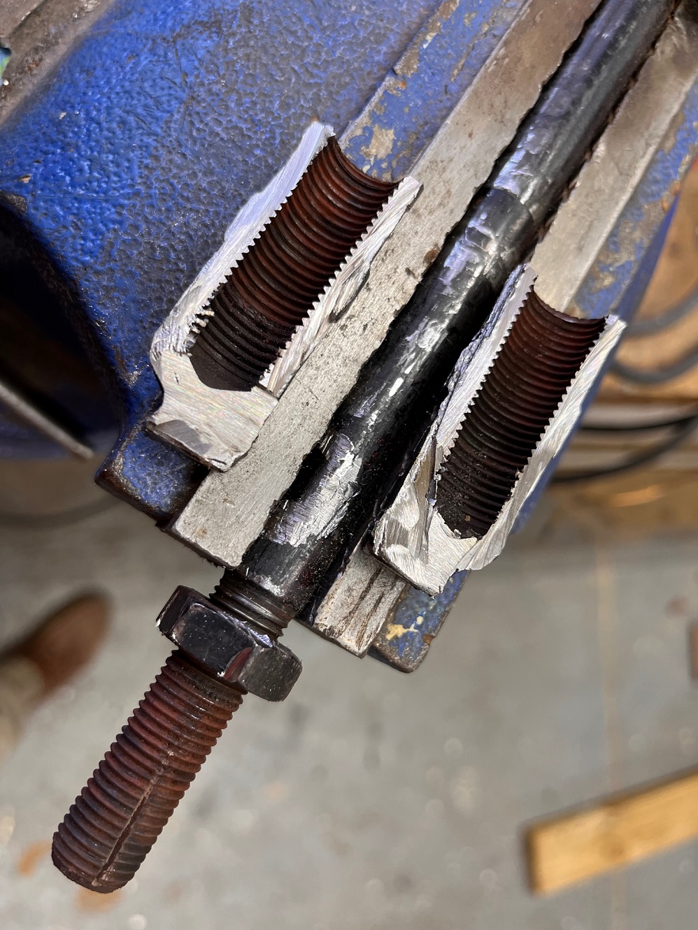

For those that are interested, I "unzipped" the threaded section of the old tie rod end to get it off the rod. Even with one side cut and banging with chisel and hammer it wouldn't come off. I had to slice both sides before it would give way. I don't see any obvious issues in the threads, so I'm still confused as to why it was so badly frozen on there.
rhodyguy
Rust frozen? It doesn’t look like the penetrant made it to the threads.

Wow. I wonder if the rod or the socket threads were raw (uncoated or unplated) and the rust got extra stuck.
I agree for the new stuff: some grease or ant-seize.

I’m late to this thread but to me it looks like original problem was that the threaded road was likely forced down into the ball joint far enough that it began to engage with the partially cut threads near the bottom.
Then add a smidge of corrosion after the original alignment had been done.
Not enough heat and not enough leverage to back the rod out of the ball joint.
Partially cut threads circled.
