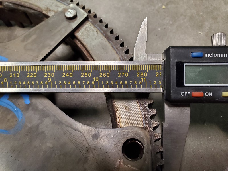

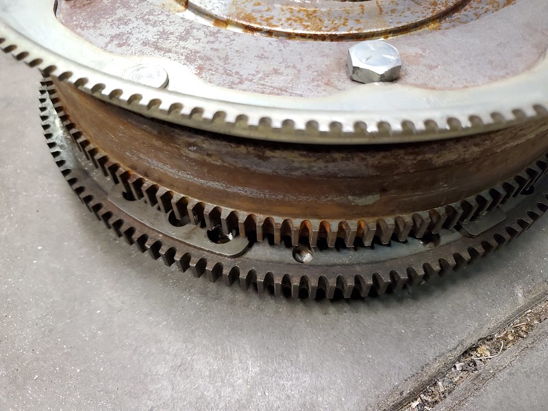

Same teeth but more of them - 135. OD 287mm
IPB Image
IPB Image
IPB Image
