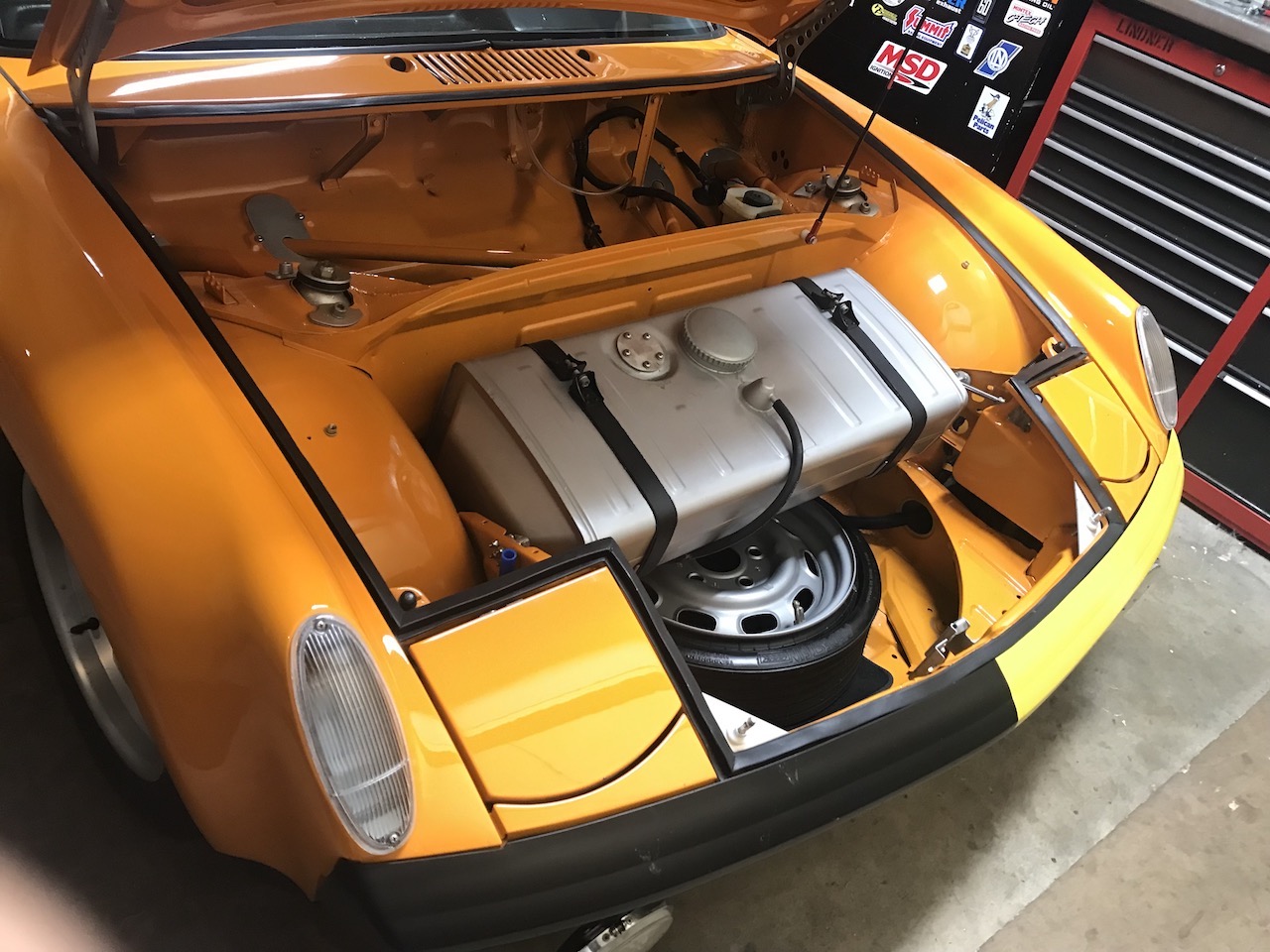

914racer, I went this direction so roll cage could go to the suspension points.Click to view attachment

I don't want to be one of those safety know it alls, but I'm not sure it's a great idea to move the tank to the crumple zone of the car like that. Is that an FIA cell with foam and a bladder etc?
BTW the build craft of that car is really beautiful.
