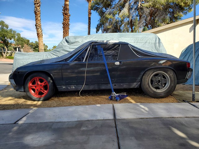

The Indy500 are a tad narrow at the tread which is good as the fronts are tight.
The rears are fine as I got a bit carried away with the roller.
IPB Image
IPB Image
235/70-15 anyone? w00t.gif

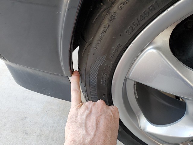

Chris, do you have a pic showing the clearance between the front tire at the rear of the front wheel? And yes, you did get carried away with those rear wheels. biggrin.gif
Chris914n6
Spacers:
21mm front (944 early rear)
21+5mm rear
Factory alignment. I figured the short sidewall preferred minimal camber.
