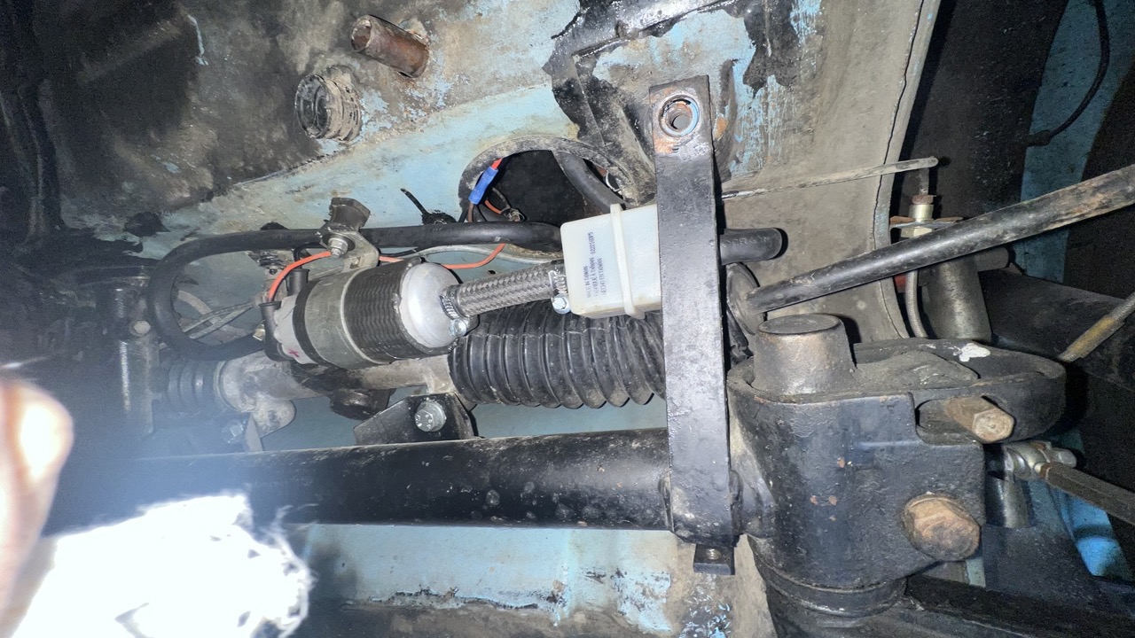

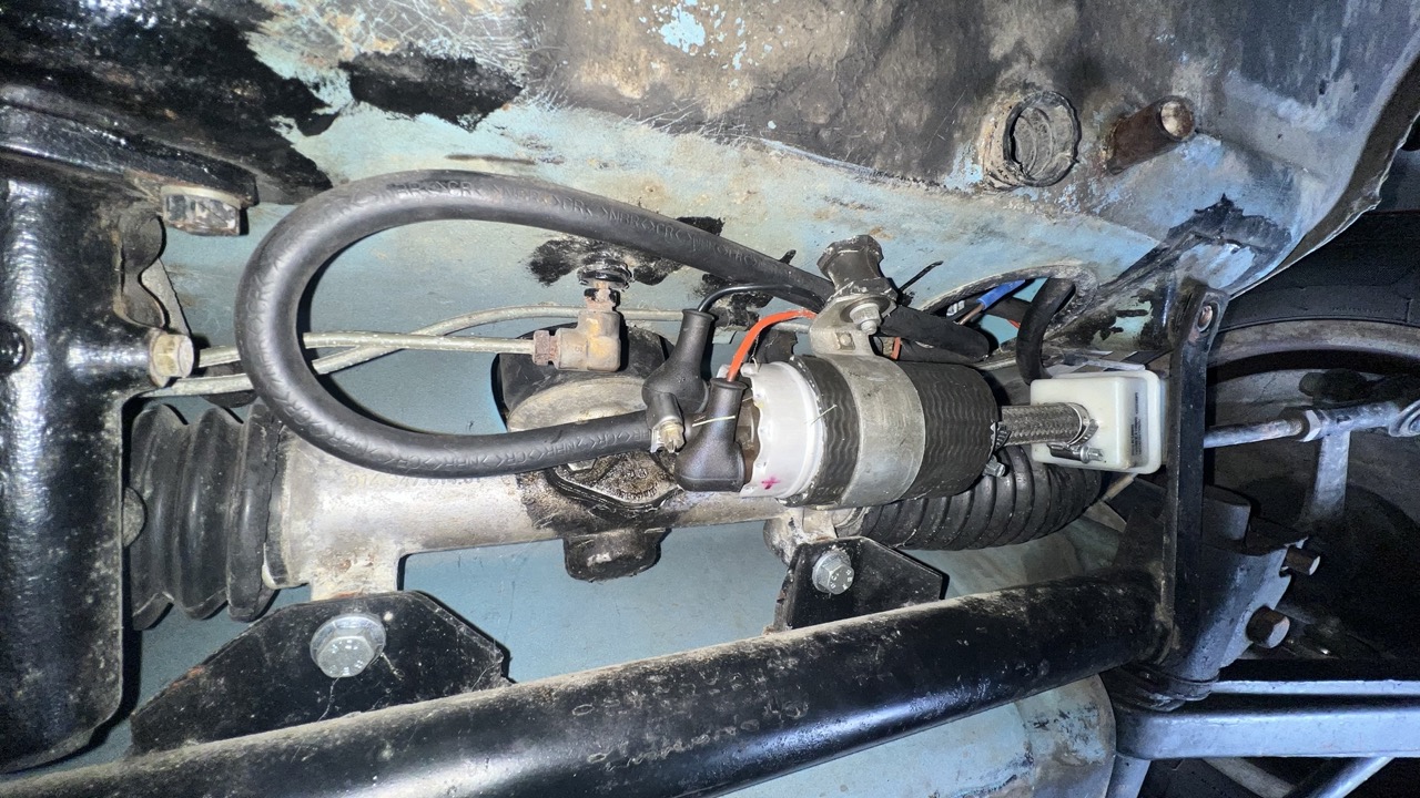

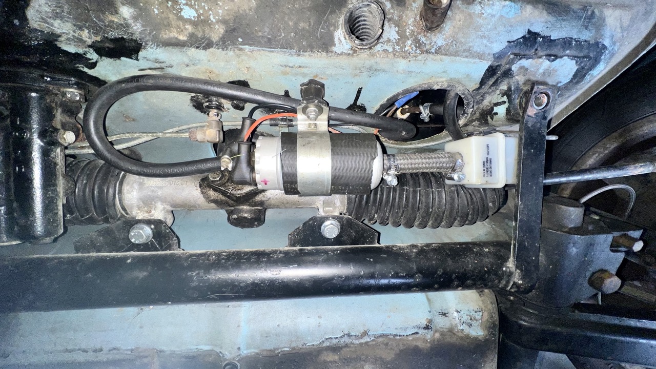

Anyone relocated the fuel pump and filter under the steering rack with to make it easier to change the fuel filter? Pictures? Thanks
FlacaProductions
Geezer914
Thanks for the pic.

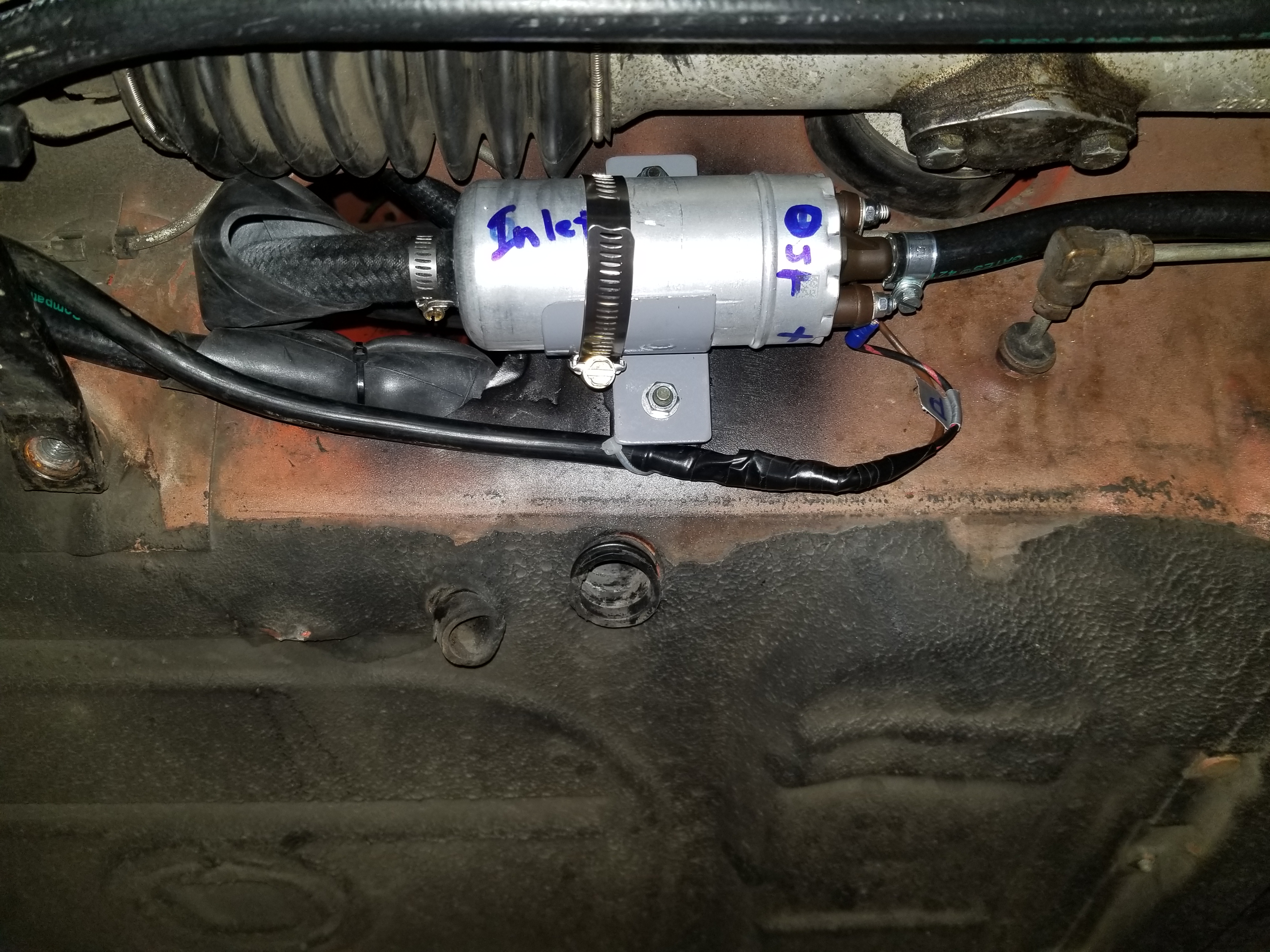

Literati914
I’m planning the same .. any more pics out there? A few different angles would help clear the mind tbh blink.gif smoke.gif
FlacaProductions
FlacaProductions
I know...I know....I don't like the blue crimp connector either but that's the PO's work. I'll get that corrected.

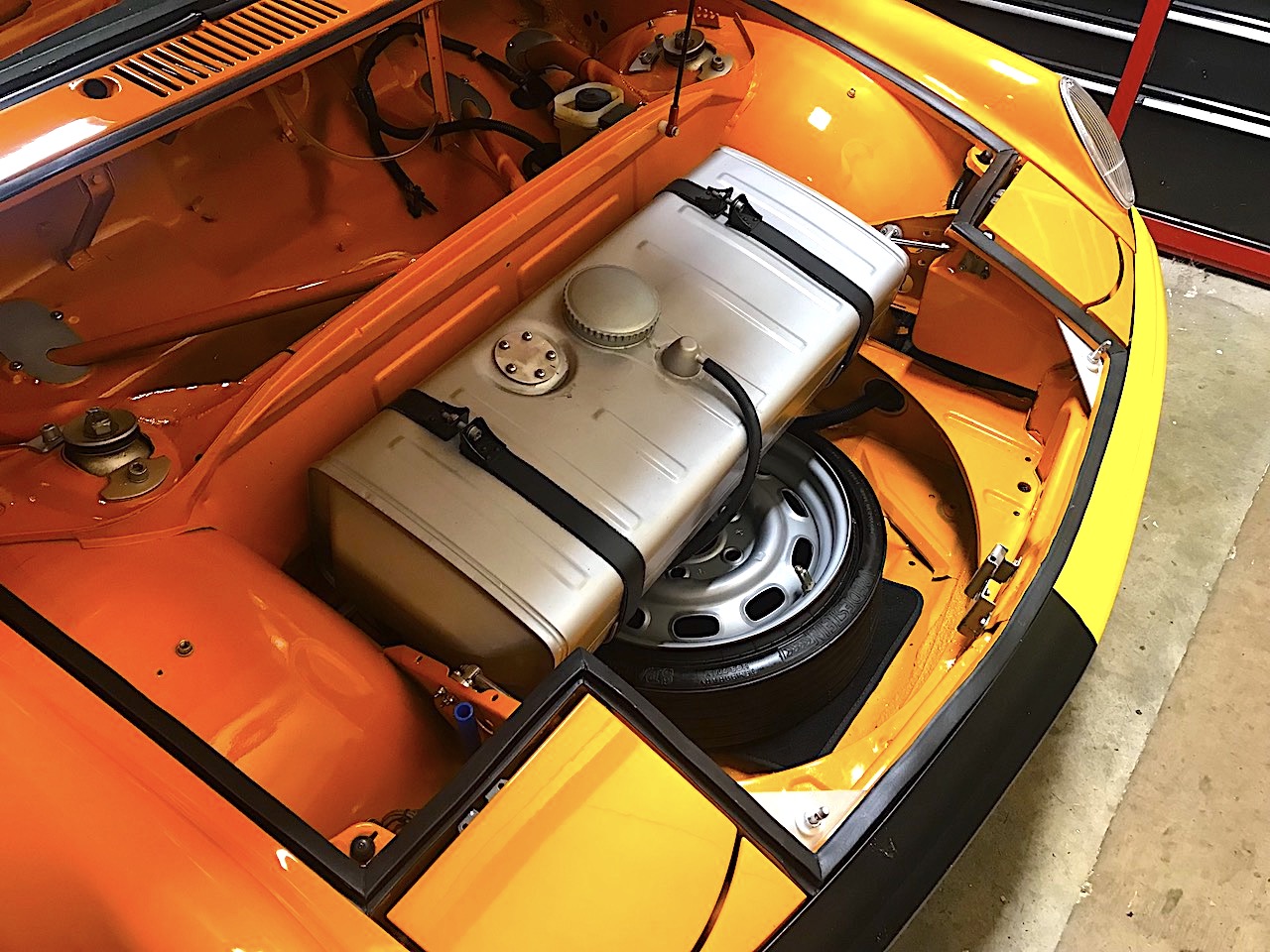

Geezer, not what your looking for but just to give you ideas. With my forward install fuel tank I mounted the filter and pump under the tanks for easy service. MarkClick to view attachment
roundtwo
QUOTE(mlindner @ Feb 4 2023, 10:13 AM) *
Hello,
Do you have a fuel filter before the fuel enters the fuel pump?
And is that metal bracket to cradle of the spare tire? Nicely done. Thanks.Todd
mlindner
Roundtwo, yes filter always first. And I just cary a small spare.Click to view attachment
rhodyguy
I would not like having to remove the rack cover piece to simply change the filter or service the lines or the pump. ESP potentially on the side of the road.
FlacaProductions
QUOTE(rhodyguy @ Feb 4 2023, 10:26 AM) *
I like how protected it is up there.
Geezer914
Rhodyguy, if the pump or the filter craps out, that is something I would not attempt to fix on the side of the road. With the fuel pump under the gas tank, it's a pia to remove the plate and maneuver the fuel pump with the 12mm fuel line to get the filter out , and stuff everything back in hoping you didn't kink a fuel line. Under the steering rack, you remove 4 bolts and everything is right there. I would like to install a small fuel shutoff valve to make it easy to change the filter.

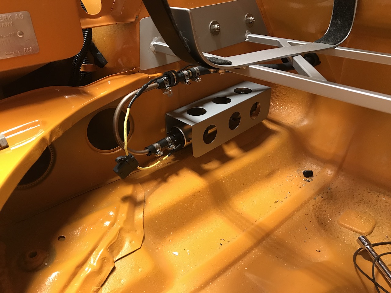

jim_hoyland
Mounted mine in the front trunk; ball valve >Filter>Pump>Pressure Gauge
Easy to trouble shoot, change filter as well as the pump
Made a Lexan shield to protect the whole thing
