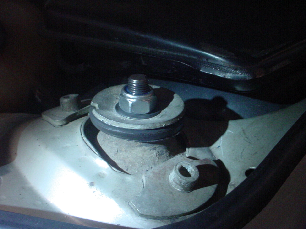

914 RZ-1
What is the torque spec for this bolt? The Haynes manual is not clear to me.
markhoward
I’m pretty sure its 57.4 foot pounds.
L-Jet914
