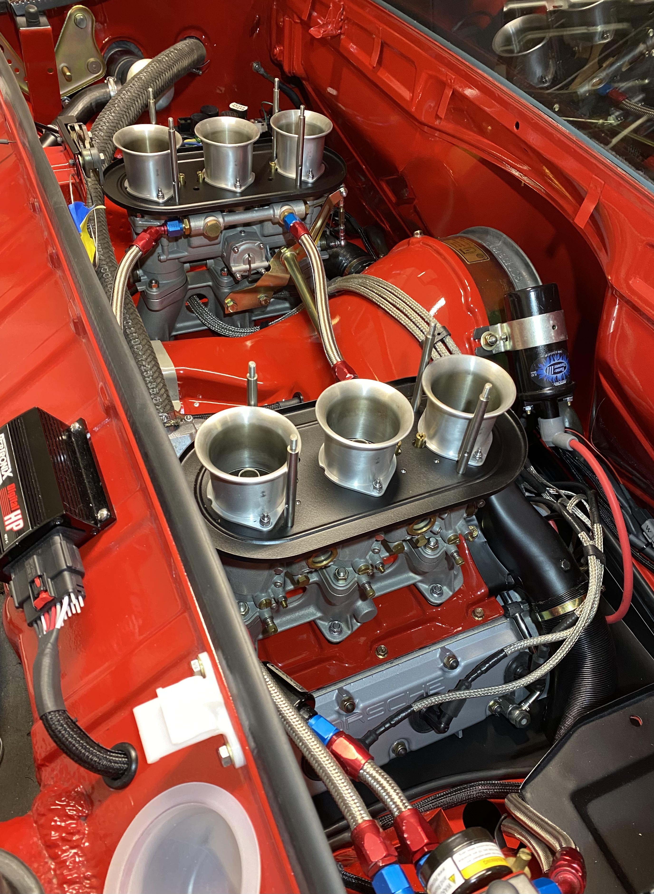

For the Jenvey carbs, is that price per, or for a pair? Ouch, that is pricey and I may have to upgrade my original estimate on price, a lot. Add a controller and all the other bits and bobs you need, it becomes very expensive. I do understand the allure of EFI though, especially after a face full of petrol.
The Jenvy throttle bodies are designed to look like carbs. Most throttle bodies are way cheaper, but they don't look like carbs.
PMO throttle bodies are blatantly throttle bodies and do nothing to hide it. They are probably better throttle bodies than the Jenvey ones. What you are paying for with the Jenvey ones is the stealth factor.
We sell both the PMO and the Jenvey. Both are of the same quality. Jenvey is top notch.
Also the Jenvey will fit common IDF/IDA air cleaners, run standard IDF/IDA linkage, fit IDF/IDA manifolds, has PICO fuel injectors included, had TPS (throttle position sensor) included, has fuel rails included. We went down this road with Borla as an example... once you got all of the other parts, the price shot up there and, custom air filter bases had to be fabricated.

QUOTE(Eric_Shea @ Mar 8 2023, 11:03 AM) *
ALSOOOO... here's a lower cost set if you already have the manifolds and linkage:
https://pmbperformance.com/products/jenvey-...-ida3-42mm-pair

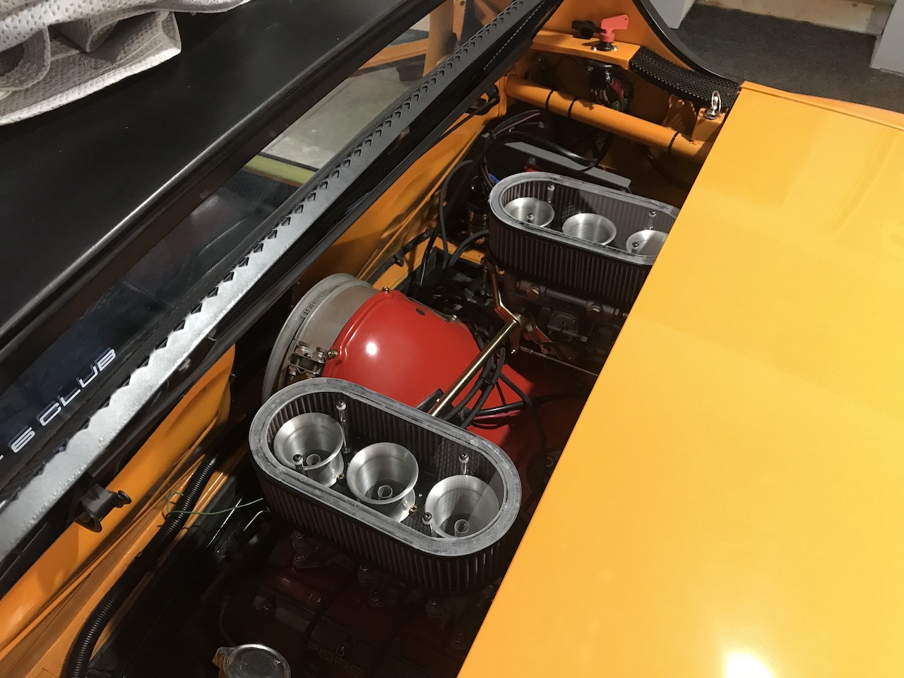

Eric, have you done this under a factory airbox/filter housing yet? Already have crank-fire ignition, so this is pretty interesting.
Eric_Shea
Not yet Pete. Bob's was the early Sport air filters. These will bolt right up under a stock box though. Mine will probably be the first for that fitment. Putting together a system for Larry S. as well, just triple checking components. You'll still need a custom harness, ECU, Wide Band, etc. With the Holley, it will control the ignition and do it "extremely" well... something else to consider. Welcome to 2023. wink.gif
