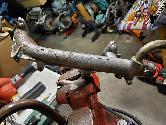

I need to clock the steel tube to clear the trunk.
I'm guessing it's pressed into heated aluminum, maybe with a lube that turns into a glue?
Anyone know for sure? @Superhawk996 maybe?
I have a 1500F heat gun to work with.

Superhawk996
Not sure what part this is. Subaru coolant crossover pipe?
Without seeing the part from other angles or knowing exactly what it is I’ll take an educated guess.
Assumption:
Cast aluminum tube with steel elbow
I’m going to say the steel elbow is likely to be cast into the aluminum and probably has an anchoring and/or anti rotation feature within the casting.
Rationale:
Looking at the picture, it seems like there is no machine work visible to square off the aluminum casting right below the “bead” around the base of the steel elbow. I also don’t see any hint of a chamfer or machine work that would be wanted if the steel elbow were pressed into the aluminum after the aluminum was cast.
Heat shrinking and a press fit would leave some opportunity for difference in thermal expansion to cause a leak or to allow the fitting to slip. I suspect the steel elbow has some features like a knurled serration or multiple beads like the one you can see, around the steel tube to allow the casting to grip it permanently and to seal it.
Casting steel features into aluminum castings is pretty common. Example cast iron liners cast into an aluminum block. It’s certainly not uncommon to cast in metal sleeves and nipples into things like water pump housings.
Being limited to a heat gun probably means you are going to struggle to get the aluminum hot enough to even try to swivel the elbow. Aluminum is a great conductor of heat and it’s going to suck the heat away from the local area you’re trying to get hot. You can try - not likely to hurt anything.
I agree with post above. The easiest approach is to remove the elbow, drill out a remnants of the steel tube, and then tap it for a fitting.
You could also cut the elbow off, orient it as you need it, index the parts, and then have someone weld the reoriented elbow back together. This would be my approach if I were in your situation. I don’t like fittings that can leak if that can be avoided.
The n in 914n6 stands for Nissan poke.gif but yes it's a coolant crossover pipe.

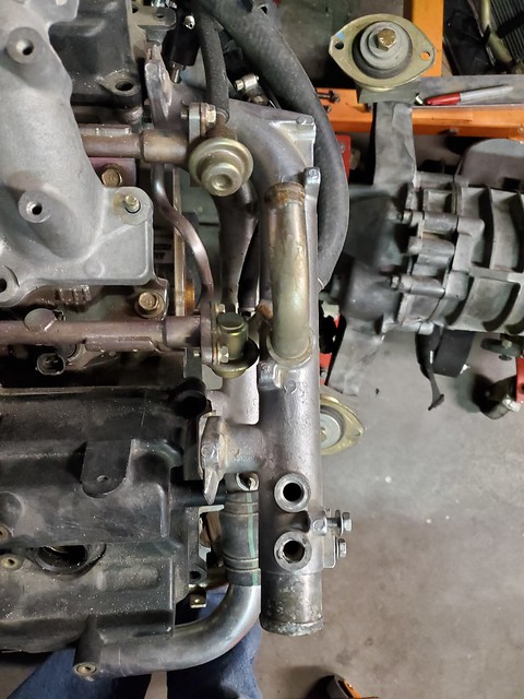

The hole surface has radial machine grooves, as all the others (gauge & ecu temp senders, etc) like a special cut drill bit, then I would assume threaded after.
If I can clock this it would be much better than piecing together a bunch of NPT fittings. This is heater out @ 5/8" and feed to the VW coolant reservoir @ 5/16". Steel pipe is actually 19mm OD.
I thought a double banjo stack would be sweet but no luck finding all the pieces, plus I doubt I could get it threaded straight anyways.
I'll look into ORB fittings next.

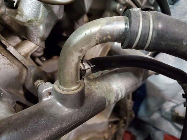

Update: surprisingly easy. Used the old deteriorated pipe to experiment with.

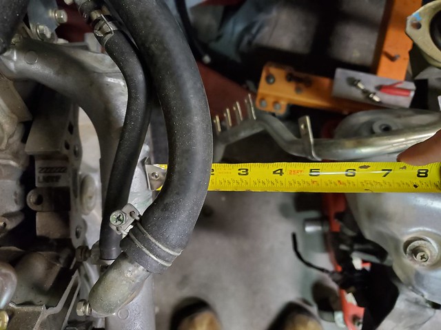

FYI- steel tube is only .060 so too thin for me to MIG, plus without fresh plating it would rust apart in no time.
This mod and replacing the heater return pipe and removing the no-longer needed vacuum tubing spaghetti knocks 2" off the rear / trunk side.

So you were able to rotate it in place?
Chris914n6
QUOTE(Superhawk996 @ Mar 9 2023, 08:03 PM) *
Yep. Got the joint area about 180f per the temp gun, decided to try it and around it went. Cooled down to about 120f and it was stuck again. Kinda concerning because the engine likes to be at 215f.... huh.gif
Another one of those things it would have been nice to know 20 years ago headbang.gif
Superhawk996
Hmm - I’d have the same concern regarding thermal expansion and operating temp.
Can you see any hints of it being machined so that the elbow with a o-ring can be pushed into it?
Really interesting. Regardless, I’m glad I was wrong on my initial assessment and that it was easy to reorient without welding.
