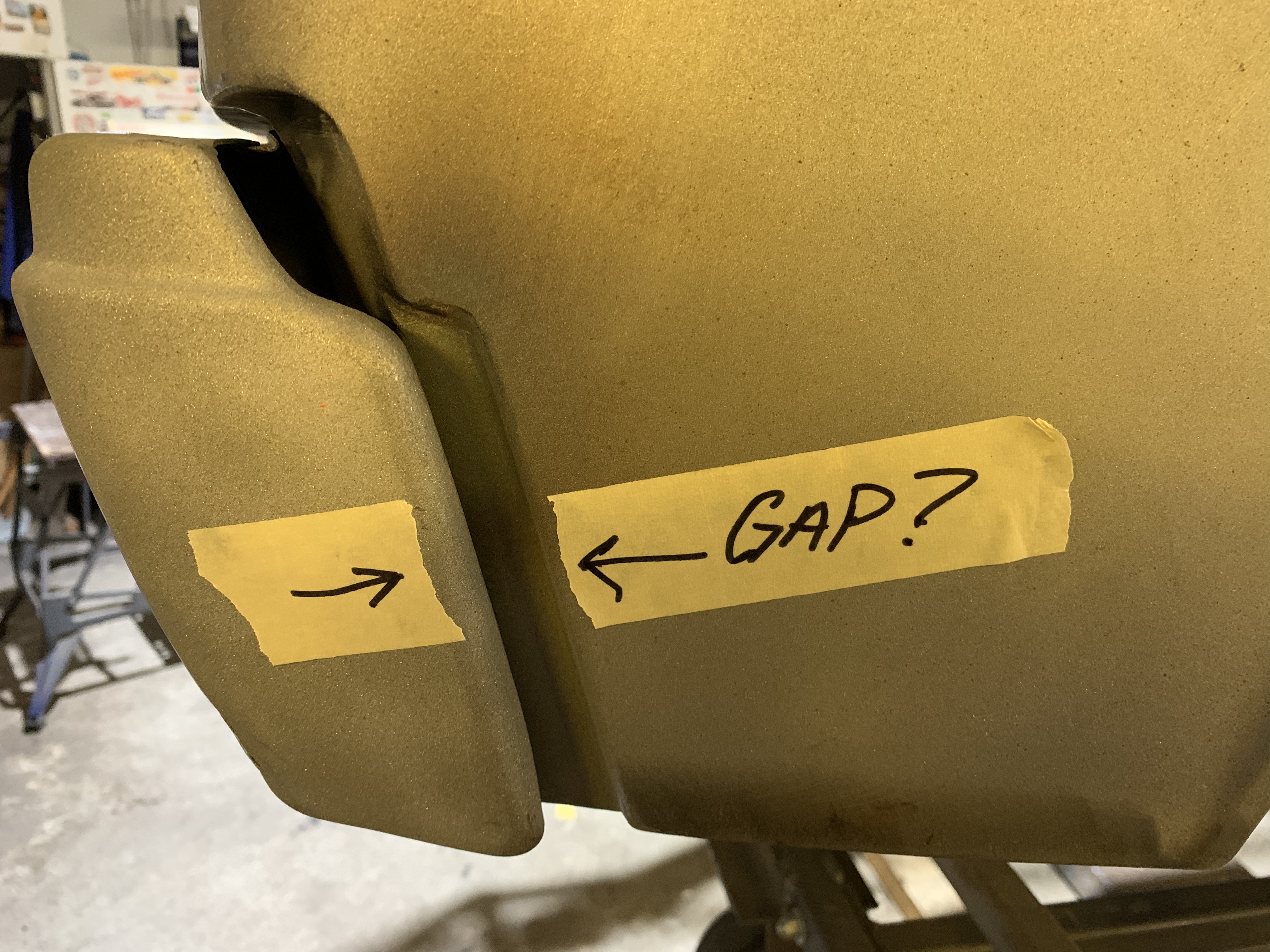

Hi was wondering if someone could help me out with the rear bumper gap measurement Click to view attachment

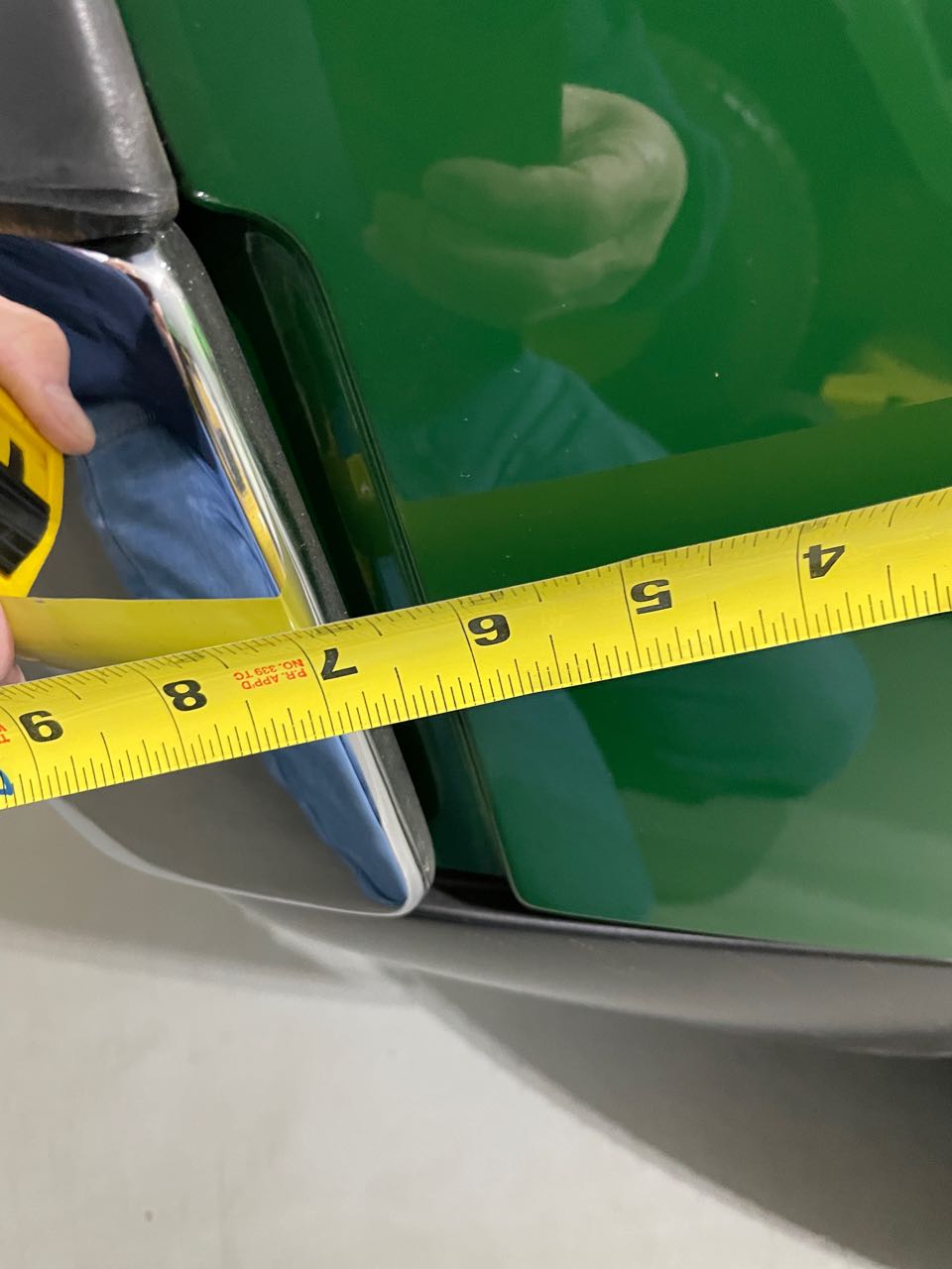

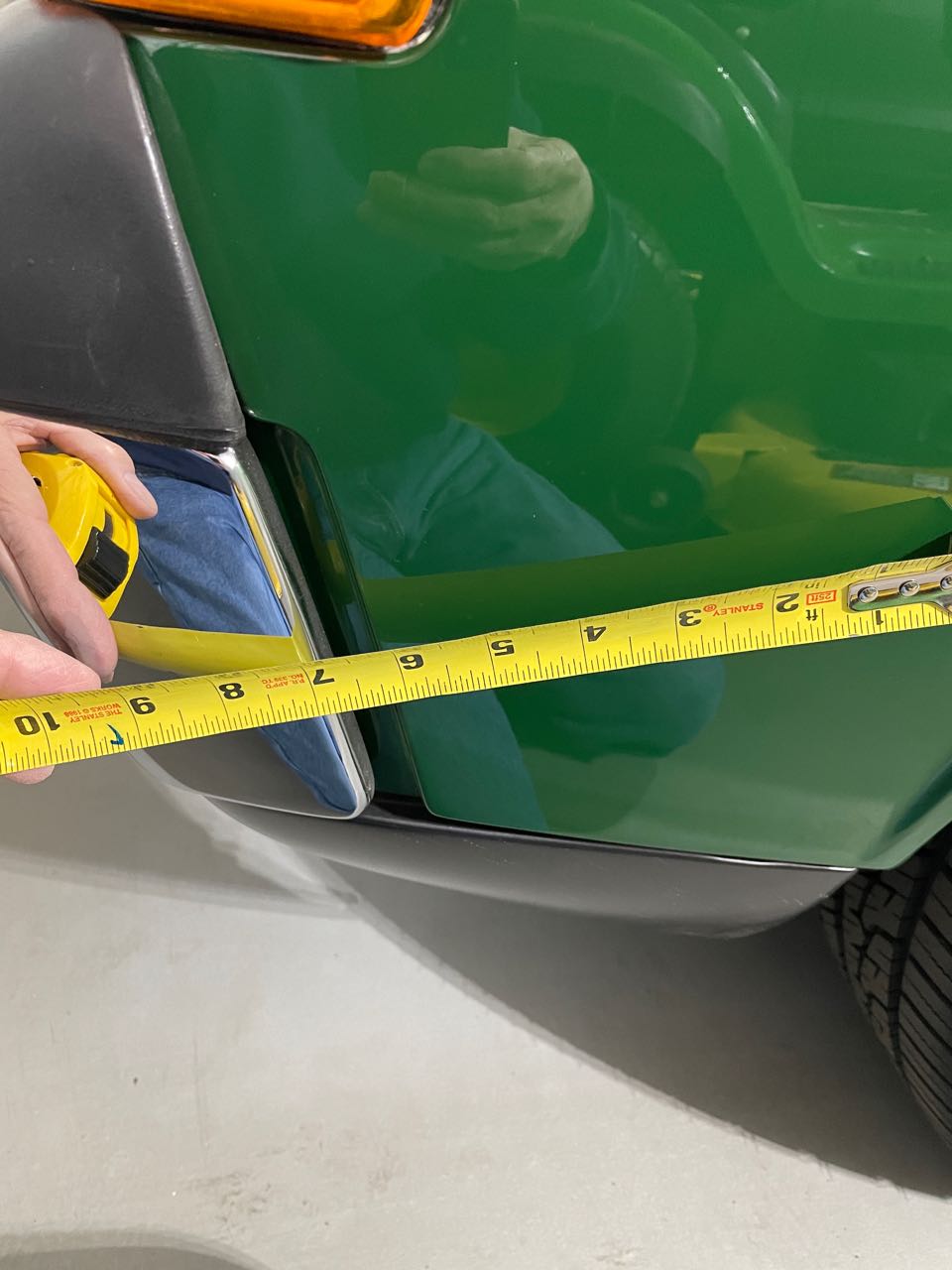

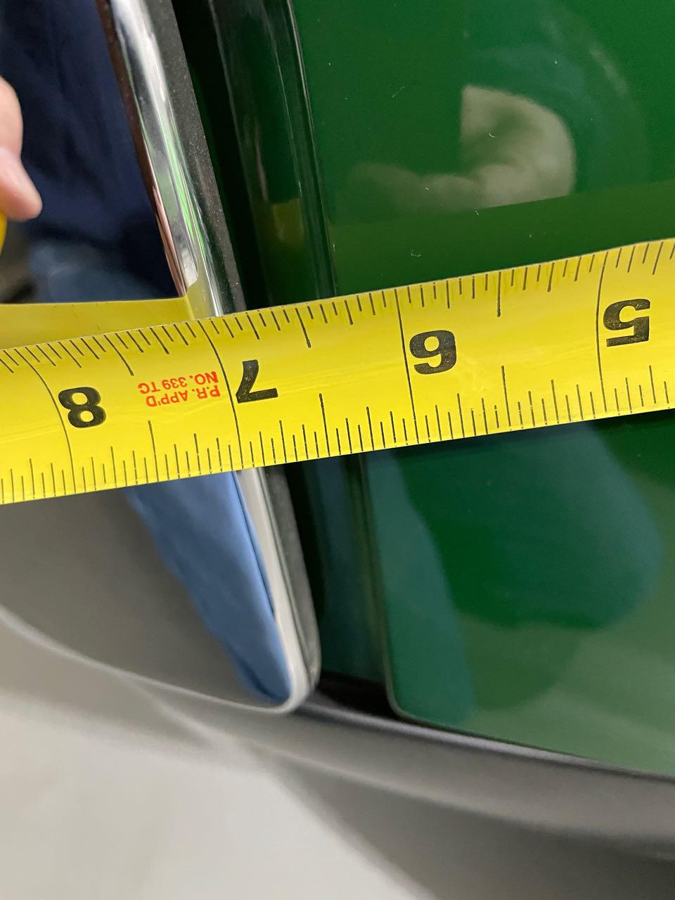

@flyinlow I went and measured mine, it looks t be 1/2". Here are some pictures:
Looks normal.
dr914@autoatlanta.com
914s vary but are uniform on both sides and top and bottom are the same distance, can be adjusted with the original soft dogbones and bolt tightness
