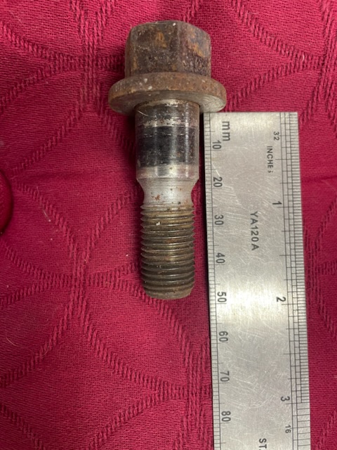

T.Rick6
Here’s a picture, looks close to 50mm
technicalninja
QUOTE(T.Rick6 @ Mar 16 2023, 02:52 PM) *
Shank/washer style. Double headed weird shank/washer...
World's smallest shank!
I can see why they had the wheels modified for cones.
