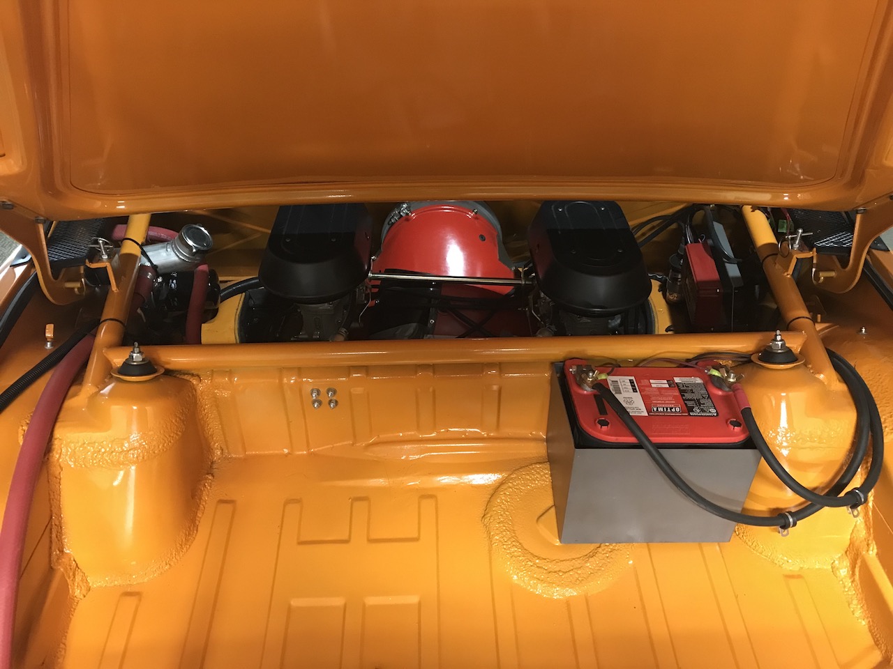

I've had Optima's for the last 20 years, never an issue. In the 914-6 GT Tribute for the last three. Best, Mark

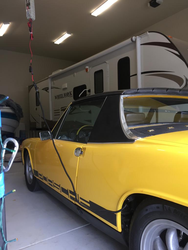

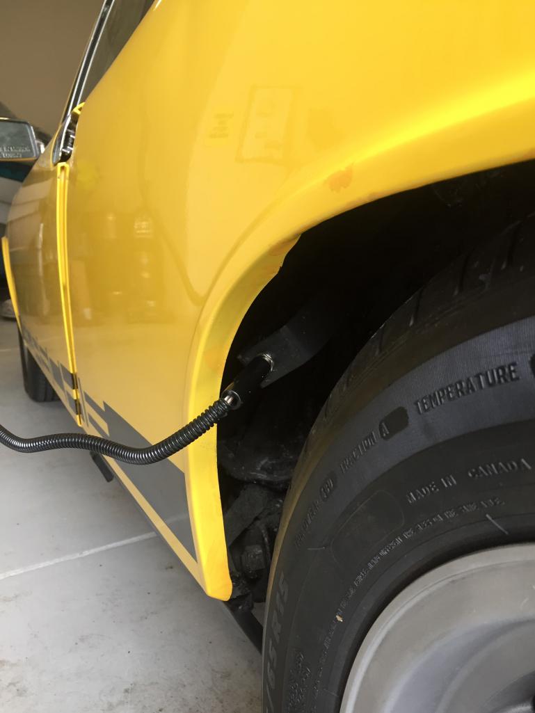

oakdalecurtis
Mar 18 2023, 02:46 AM
QUOTE(oakdalecurtis @ Dec 16 2021, 09:47 AM)
i use an Optima Red, got about 8 years out of my last one, maybe because of this modification. Since I drive my teener in fair weather only and often on short trips, I put a tender on it whenever it's in the garage. I got tired of opening the engine cover and attaching it all the time, so I did the following modification. Now I pull in the garage and "plug in" the car...
http://www.914world.com/bbs2/index.php?sho...&hl=batteryClick to view attachmentClick to view attachment

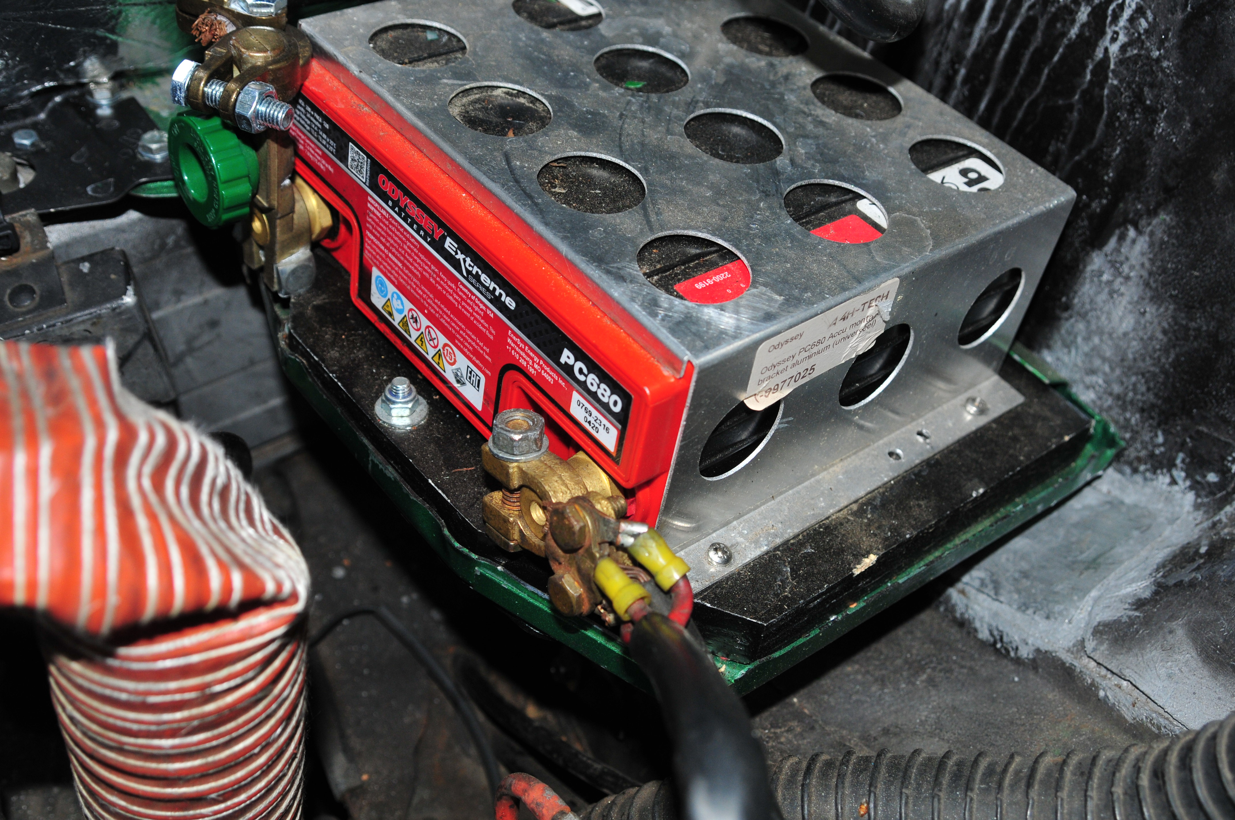

I have the PC680 since 2 years now. It's very light and the car starts every time from the first time. But I always disconnect the battery if i don't drive the car for more than a week and from time to time I use a battery tender since the weather here in Belgium is too bad to drive a lot during wintertime.
To disconnect the battery I have the little green wheel at the negative of the battery. Very easy to install and very cheap. I also had to buy a bracket to hold the battery in place. Until now , I'm very happy with it. I have no radio and no AC, probably you will need a bigger battery or a really good alternator if you have them and use them a lot.
I only did this to reduce weight and I think the AGM's keep their charge longer ( when disconnected).
nditiz1
Mar 18 2023, 11:11 AM
Slotty from this angle it looks like that positive terminal is so close to the metal tray. I'd feel worrisome, but it's probably further away in actuality.

slotty008
Mar 18 2023, 11:48 AM
QUOTE(nditiz1 @ Mar 18 2023, 06:11 PM)
Looking at the pic, I was thinking exactly the same thing, but in reality it's not that close. Maybe I'll put some insulation in between, just to be sure.

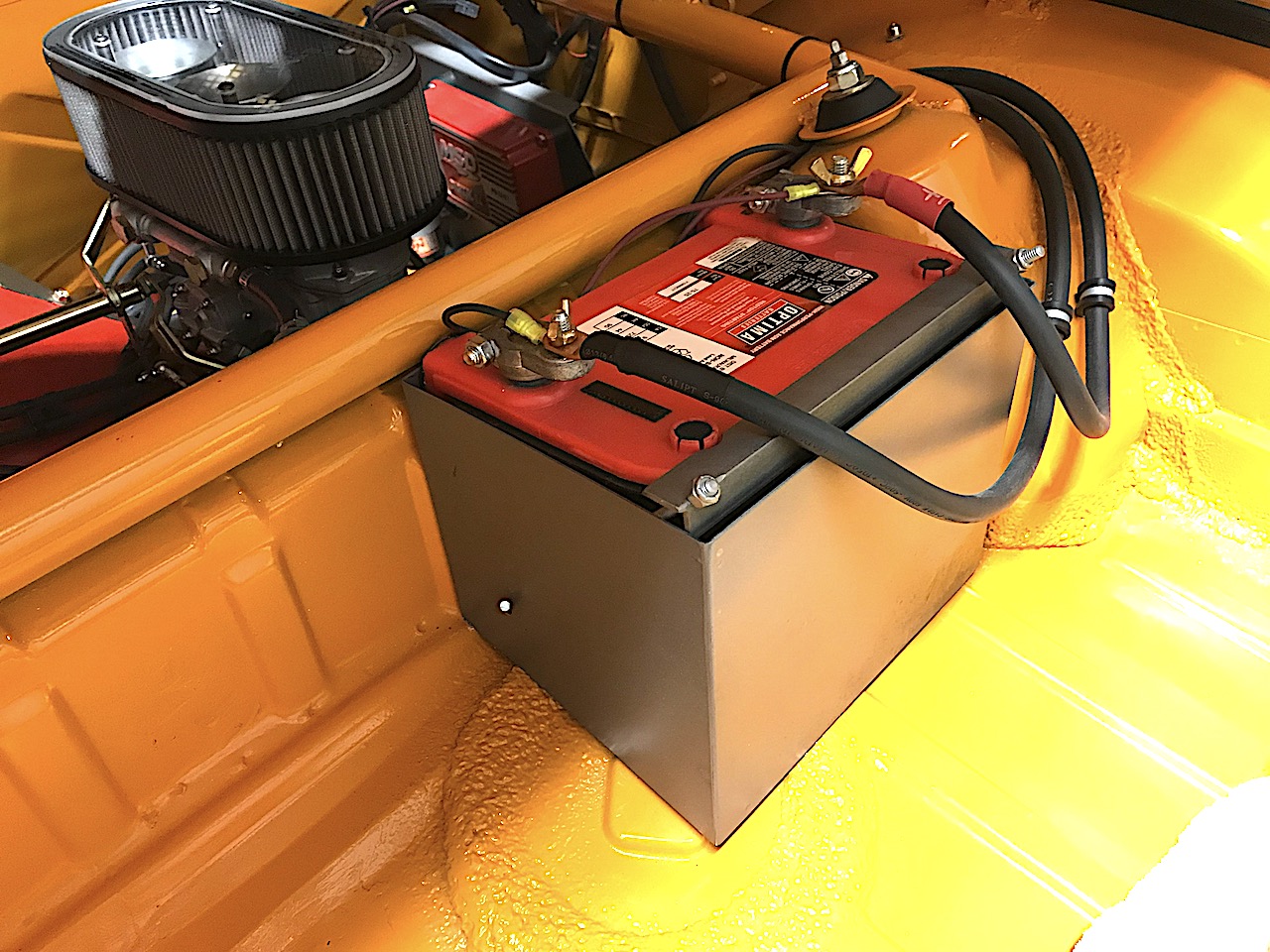

Have had Optima red tops in my 914 since ~1992.
I think I have only had 2, maybe 3…so easily 10 years per. The big attraction back in the 1990s was avoiding hell hole rust. But they are heavy, so I think about an Odyssey or Anti-Gravity. Or that new orange top from Optima. For both of my fun cars, as I value less weight over more hp.

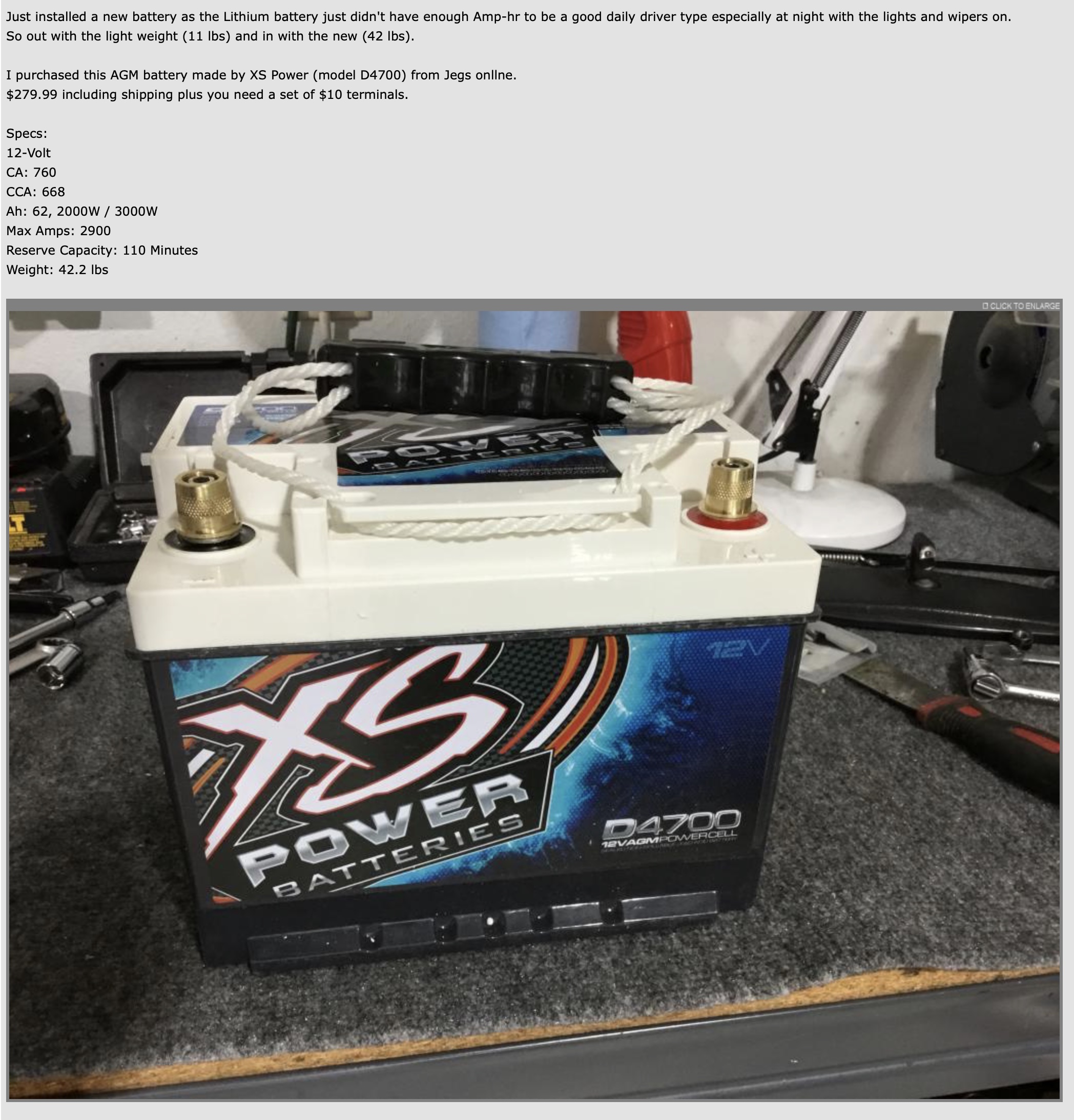

@VaccaRabite Zach, what battery did you end up buying? Was it AGM? I need to replace my Optima red top. After 20 years the first start up of the day is very slow.
I went backwards. Standard lead acid AC Delco. I’ve not bought a Red Top in about a decade. I’m sure that they have fixed thier issues from 10 years ago. But modern batteries don’t really leak anymore, so I don’t see the point in spending the extra money.

QUOTE(Spoke @ Nov 26 2023, 09:51 AM)
QUOTE(VaccaRabite @ Nov 15 2023, 07:31 AM)
I had a PC925 in my car.
I went back to a standard battery.
The PC925 just cant store enough energy if the alternator doe not perform at its peak for some reason at night. I got left stranded on a 20 minute drive when the alternator was not charging at full power. The PC925 was at full charge when I left the house. it lasted 15 minutes and died.
Standard or Gel batteries are heavier, yes. But most of the can sustain a car for 30 - 40 minutes in the event of a charging issue to get you home or to somewhere safe.
I would NOT put Lithium batteries in my car without special chargers built for them specifically. Also, I'd look for LiFePo4 batteries instead of L-Ion batteries.
Zach

infraredcalvin
Nov 27 2023, 09:37 PM
Another optima guy here, I’ve been using since late 90s, I replace them at about 7 years, still have one from 03 and another form 06 still going strong, they are backups.
I’ve used battery tenders with no issue previously, but now have an optima specific charger, it brought a dead lead acid back to life when nothing else worked.
I use a 3 cell yellow top in my track car, I disconnect when not in use, it’s been over a month since I’ve started it, still at 100% when I throw the smart charger on it.

rjames
Nov 29 2023, 02:24 PM
QUOTE(GBX0073 @ Nov 27 2023, 08:28 PM)
Napa Did not exclude batteries from Cyber Monday 25% off so picked this up.
plus earned another $10 off in rewards.
Get the right battery tender for your Odyssey. Here's the list I found online:
Click to view attachment I have the BatteryMinder 2012-AGM and have been happy with it.
Using one that doesn't meet the battery's requirements of a charging voltage of 14.4-15v may prematurely shorten its life. This did give me some concern after I purchased my PC925 as I'm betting the stock 914 alternator may not be putting out that much, but so far so good, and I always put the battery on the charger when it's in the garage.
