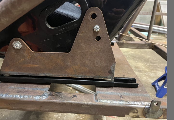

Spent the day welding the final seating mounts and harness tabs, as well as tabs for brake lines.

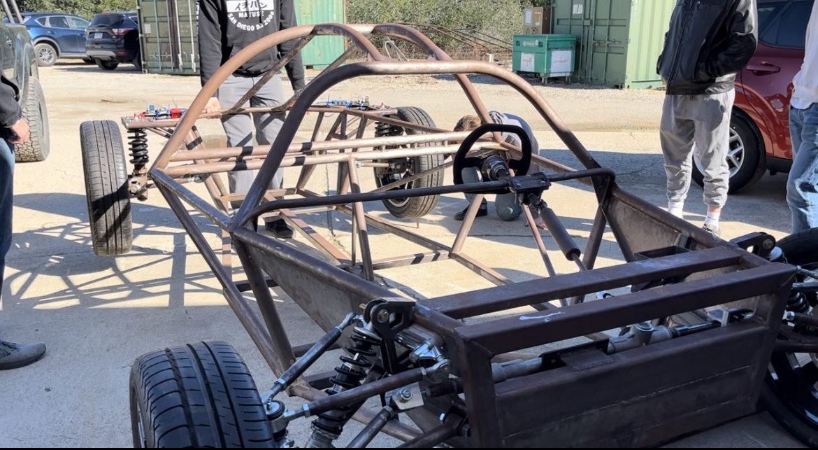

The chassis is back from the powder coater and it is looking sweet - pulled a few long night welding sessions with my buddy to finish it before it went off.
Or so I thought. Was then told by a member of our Aeroshell division that there is a giant plate that must get welded in. headbang.gif. Well I've heard POR15 is a pretty good match for satin black. dry.gif

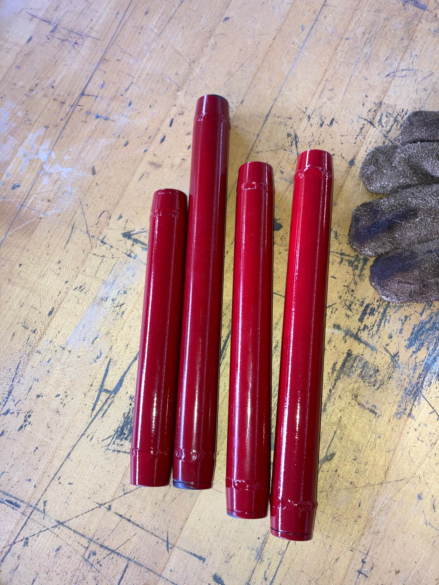

While it was away we took the opportunity to powder coat a few small parts ourselves - control arms, support plates, and other odds and ends.
If I had known how easy powder coating is I would have said we do the whole car ourselves! lol-2.gif If only we had a furnace that would fit the chassis....

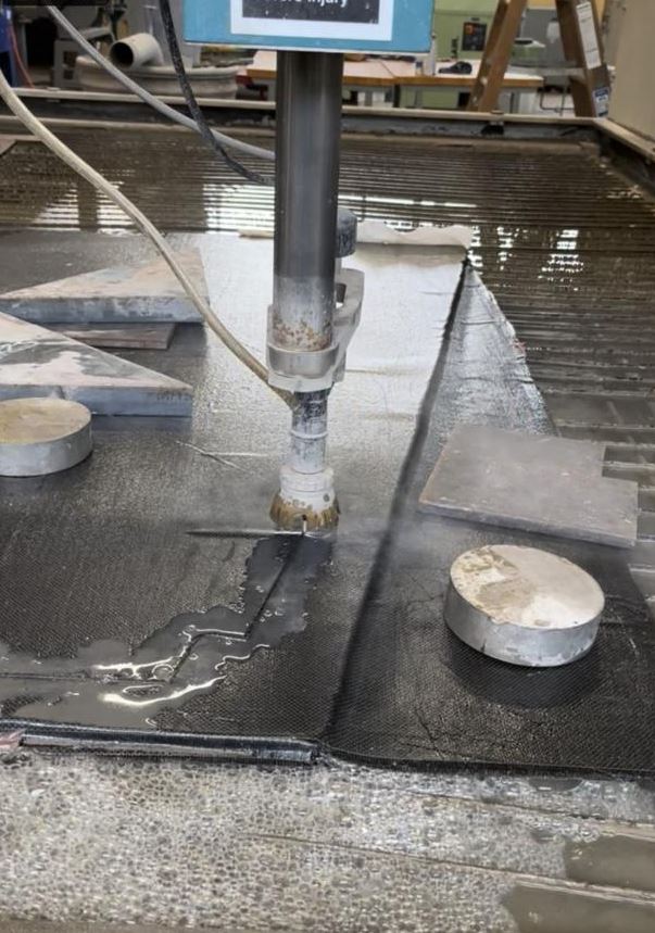

The shop's waterjet was utilized to cut the carbon layup for our primary battery structure (I will be honest I don't quite know how that thing is going to work) - I am almost done with my certification to operate the monster.
