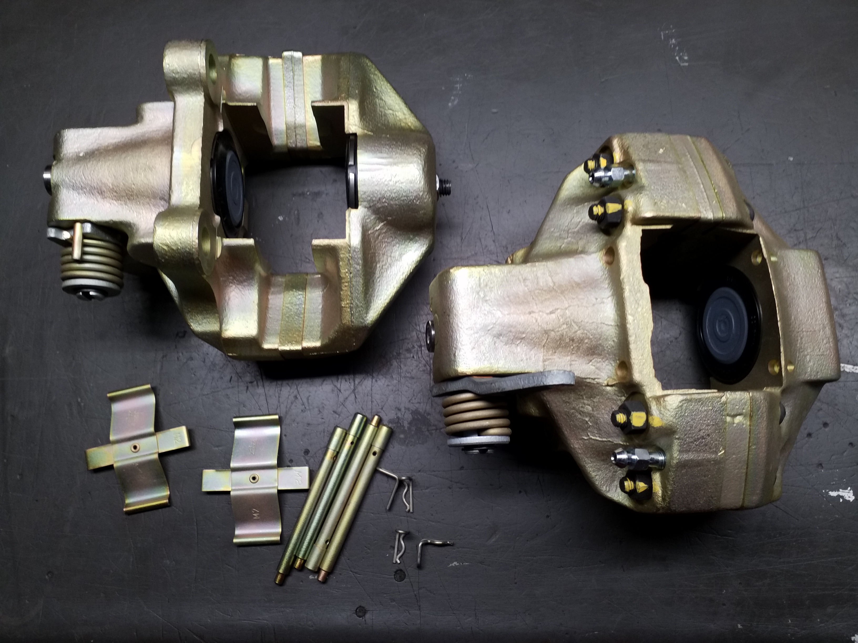

Here are my 308 calipers. I had a machinist add the second bleeders so they are on top when mounted on my 914/6 conversion. Fresh from restoration at PMB last month.

And some casting variations with mine. @Superhawk996 . I bought these from a Ferrari repair shop. They told me they were off two different cars. I didn't care since they were $100 biggrin.gif

Thank you for the alternate views.
Nice score for $100. Lucky the didn’t call the cops after you stole them like that! aktion035.gif
