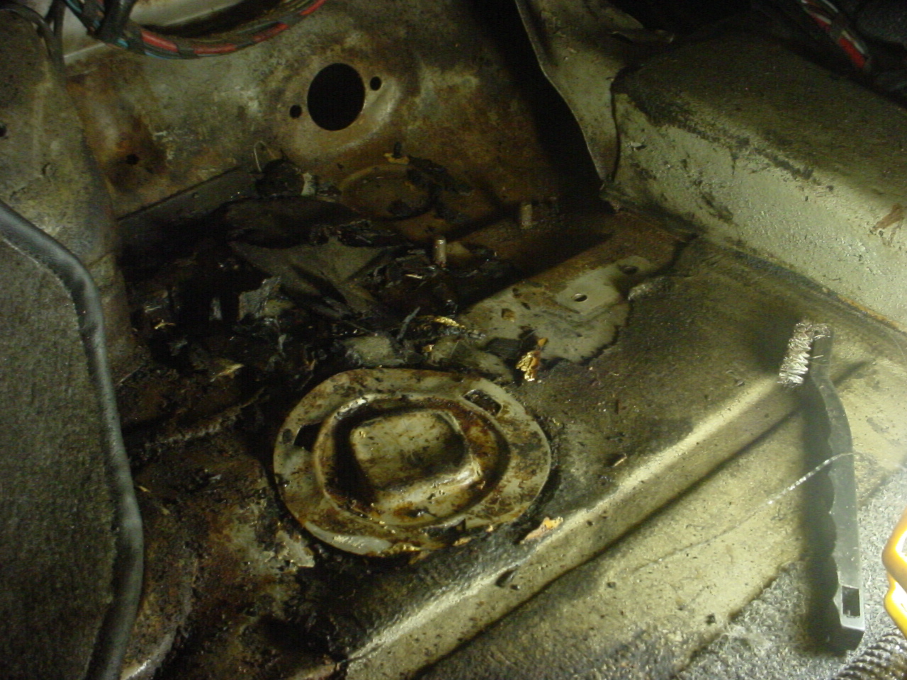

The M/C leaked all over the floor plan. There's some rust as well. Before I put back everything I thought I would clean it all up.
1. What is the best way to get all the coating off the floor pan? It looks like some sort of asphalt/tar paper. It seems to be peeling off okay with a putty knife. I'm guessing I use some sort of solvent to get the remaining gunk off? Heat gun?
2. I have a kit that has cleaner/degreaser, metal prep and POR15. I also want to reseal around whatever that is (plug?) in the middle with some seam sealer. What order is this all applied?
-cleaner
-prep
-POR15
-seam sealer
OR
-cleaner
-prep
-seam sealer
-POR15
Or some other order?
3. I was going to leave the POR15 as the final coat, but do I need to paint over it? The car is silver/gray, the POR15 is gloss black. It's under the carpet and under the floor mat, so it will not show. I'm more concerned with keeping the rust at bay.
4. Where should I stop the painting? At a seal? At one of the changes in contour of the floor pan? Please note that the car was in an accident many years ago (before my ownership) and was repaired, but the floor pan is still a little uneven. My concern is that the paint will wick under the tar paper, but is that even an issue?
Here's a photo, since I know we all like pictures. There is a pile of tar paper on the left:
Thanks!
-Jeff

How much rust? And how far do you want to go?
If any more than surface rust, then the "right" way to repair to to cut and replace all rotted metal. If surface rust, you can make an adequate repair with rust treatment.
To remove the factory tar sheet, people use all kind of methods. A popular way to to apply some kind of deep freeze to make it more brittle and easier to chip off. Otherwise just use hand labor.

I was able to find more threads on tar board removal, especially since I was searching for "tar paper "and "floor board" and not "tar board".
Seam sealer will go on AFTER POR15.
This is all surface rust, so no floor pan removal.
I plan on wearing a respirator and having a fan on and the garage door open. The car is on jackstands, so moving it out is not an option. I will scuff the surface for paint. What paint? I just need something to cover it. I was thinking gray paint that I could brush on. Thoughts?
Can anyone answer my last question: Where should I stop the painting? At a seal? At one of the changes in contour of the floor pan? Please note that the car was in an accident many years ago (before my ownership) and was repaired, but the floor pan is still a little uneven. My concern is that the paint will wick under the tar paper, but is that even an issue?
I'm thinking I can use seam sealer where the tar board ends. Seems the paint is basically glue, so maybe if it does wick under the tar board, it will harden anyway.

In my opinion, you’re over thinking it.
It’s all under carpet. No one sees it.
Don’t sweat a little paint or POR wicking into a sheet metal seam or under the tar. The tar sucks and is basically a place where rust begins to grow under it. No matter what you do short of removing it all, it’s not going to look pretty.
As far as paint, you could leave as just POR (no UV exposure). If you want to paint over POR, it gets trickier - spray paint mist will drift and get on carpet and interior. For a quick fix, you would be better off using a brush. At that point I come back to just leave the POR.
What type of paint? 2k epoxy/urethane would be great but it’s pricy. A decent single stage enamel over the POR and/or seam sealer would be fine. Find what you can at FLAPS or get a pint of paint mixed from local PPG distributor if you want to try to color match. But again no one sees it under carpet.
