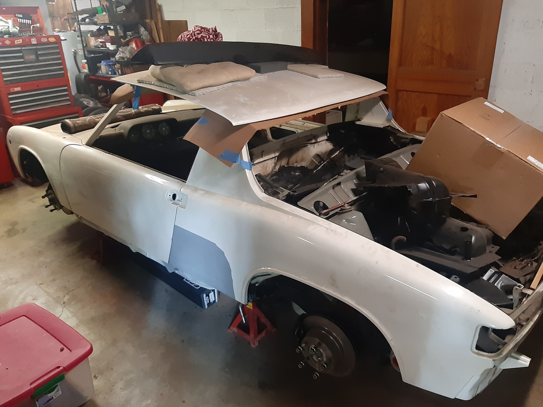

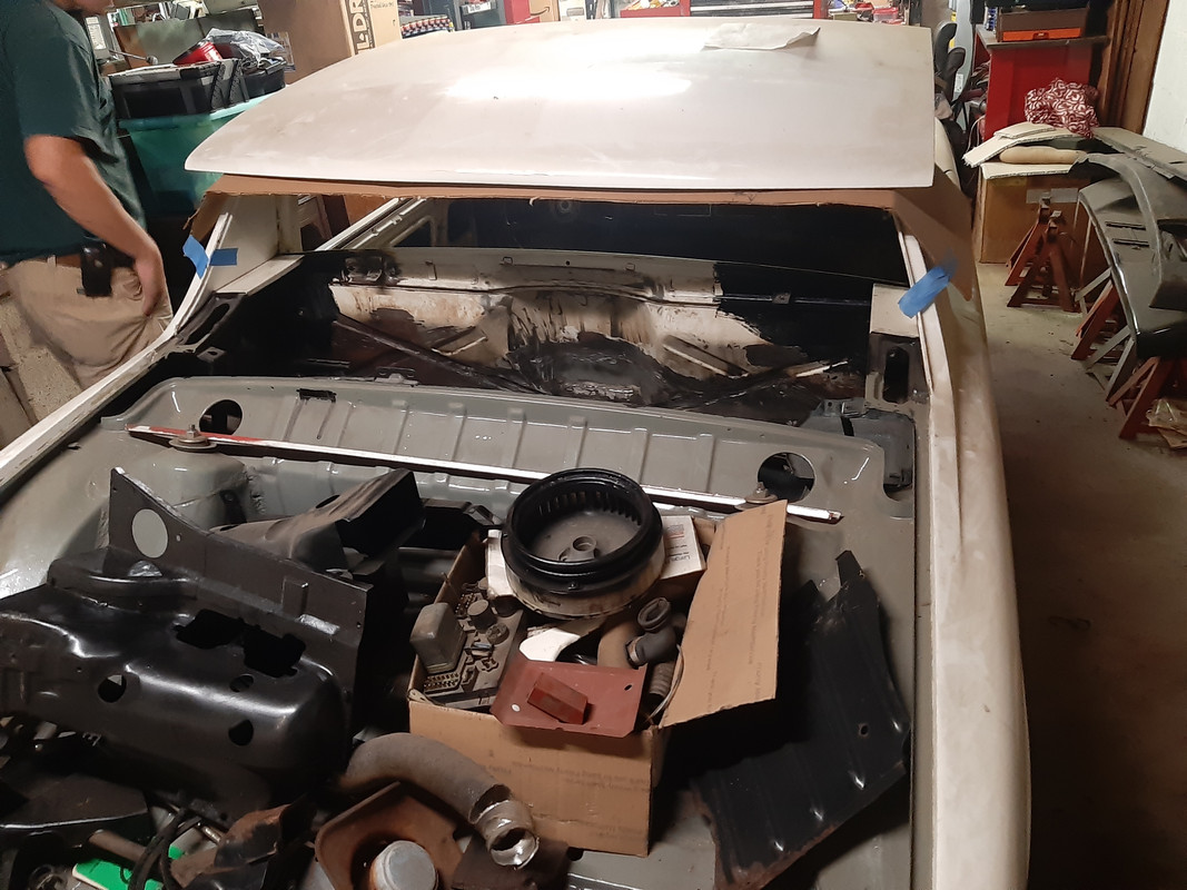

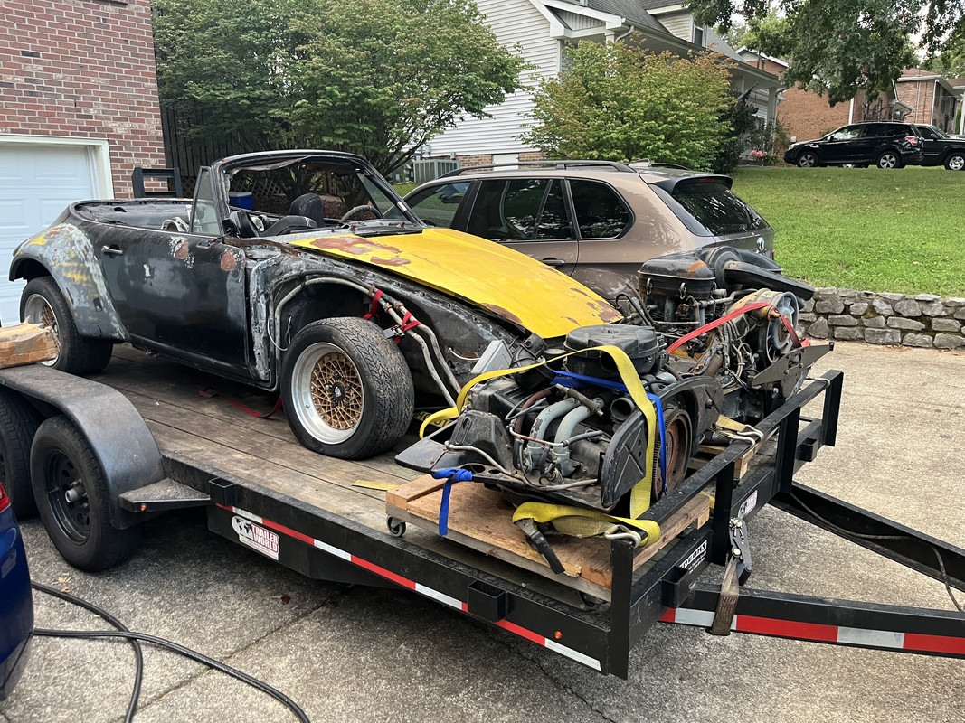

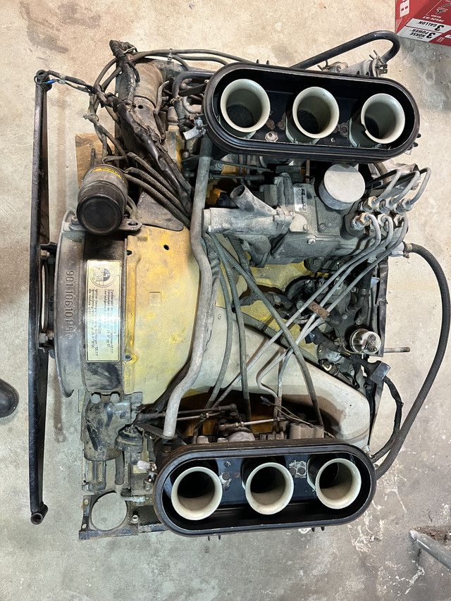

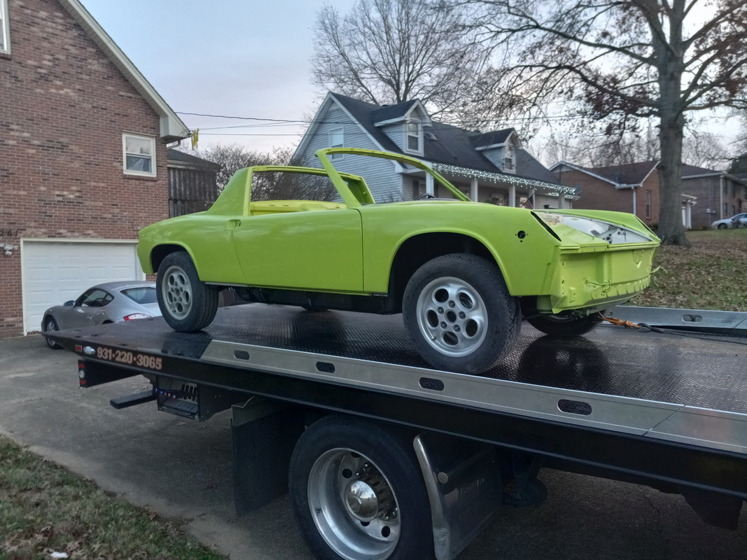

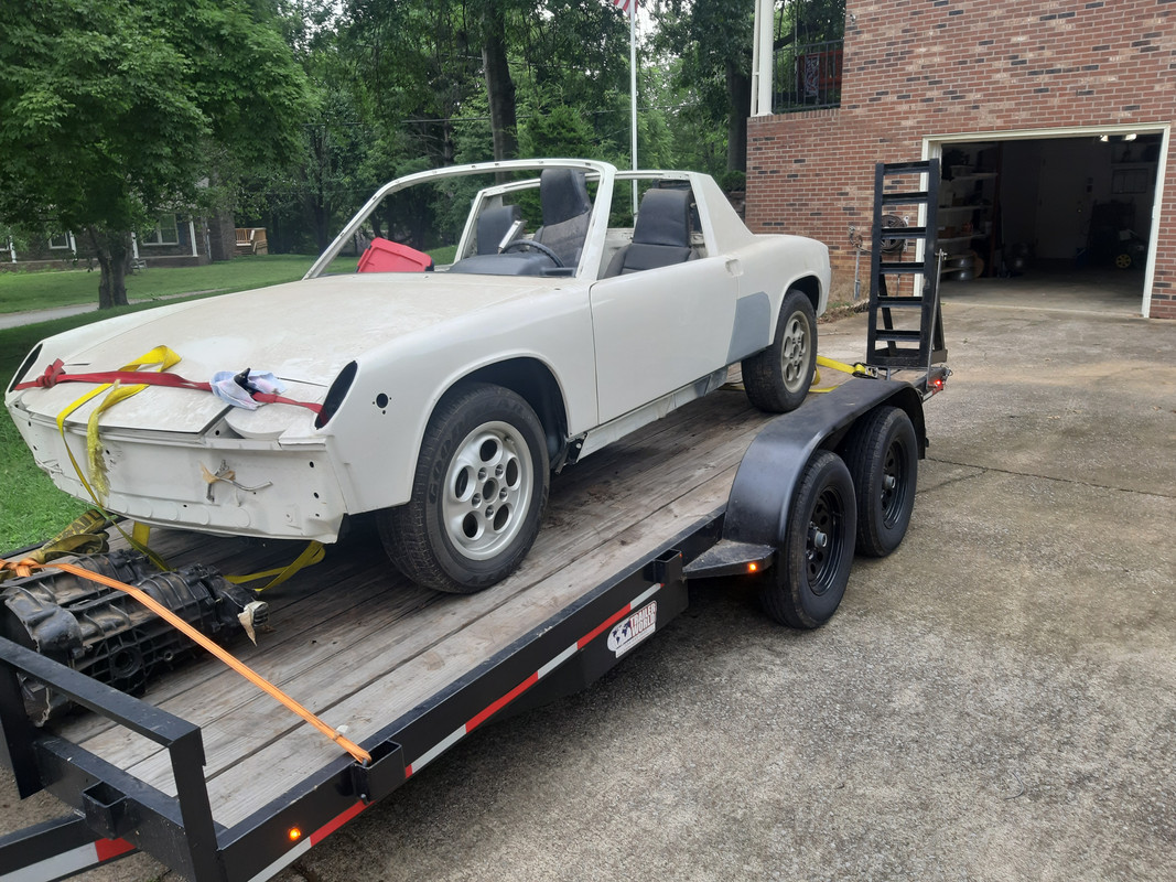

This will be a build thread for my 914 build. The build is ongoing, I will post updates here and hopefully keep progressing! I posted most of these pictures before, just trying to put it in one spot for a continual thread.
The end goal of the build is to have a fun autocross car that is nice enough to drive for date night or cars and coffee. It will not be a concourse car or race competitively, just out to have fun.
This car was a stalled project that I purchased as a roller and a pile of parts. I purchased a set of wheels for my Cayman and the seller had a 914 in his garage. After going back and forth for a bit I finally convinced my wife to let me buy it. It came with a ton of spare parts and the first couple months with the car was mainly just figuring out what I had and what I needed.

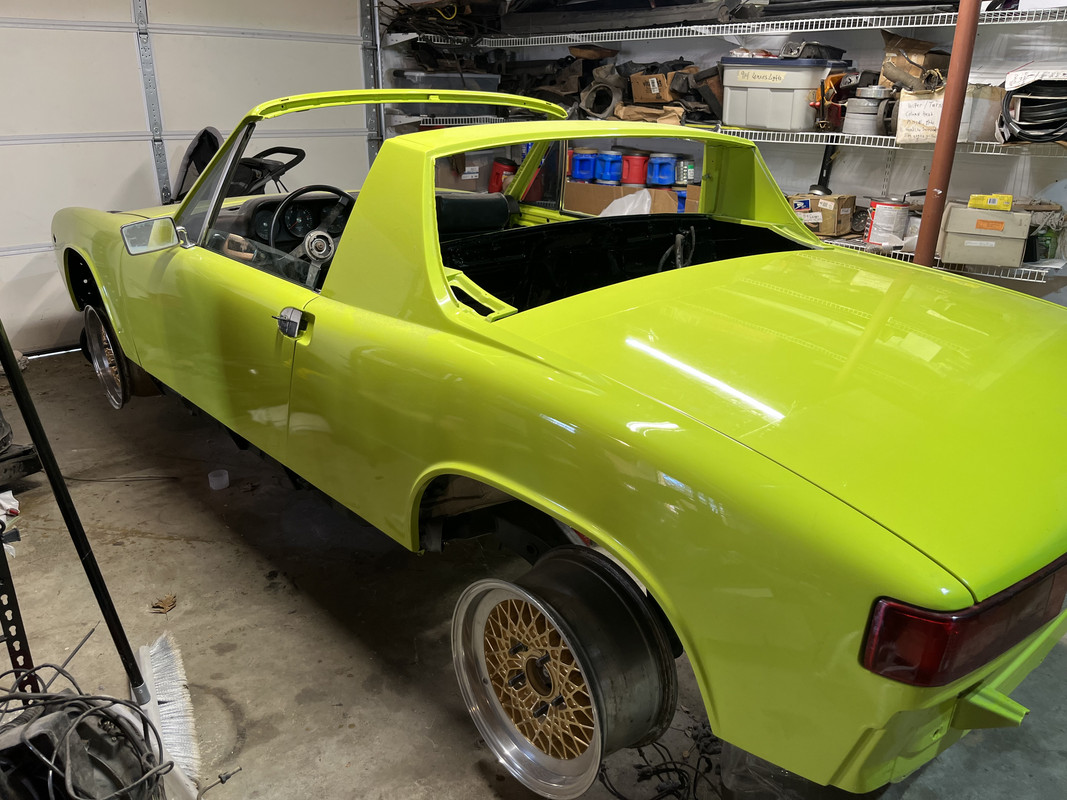

Part of the deal was my wife got to pick the color. She picked Ravenna Green and it turned out good! I spent more than I wanted on the paint but less than I should have. It looks great from a distance, OK up close, and a PCA concourse nerd would throw me out.
Found some cool wheels online and got the windows, door handles, hood, and trunk mounted up. Unfortunately progress stopped for a while after this due to work requirements which had me away from home for a while.

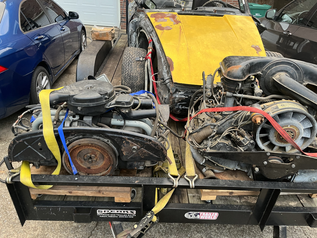

Got a few weeks back home and scored some more parts off of ebay. Got a wrecked 911, a 914 motor, and an MFI 6 cylinder. I sold the 911 and left the MFI engine with my helper to figure out.
Got back home 6 months later and was shocked to find my 2 year old had made no progress on the build. However, I had a huge pile of -6 conversion parts from Ben and others waiting for me so its time to get after it! I will keep posting as I make progress.

B3owulf
Apr 18 2023, 04:32 PM

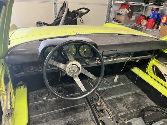

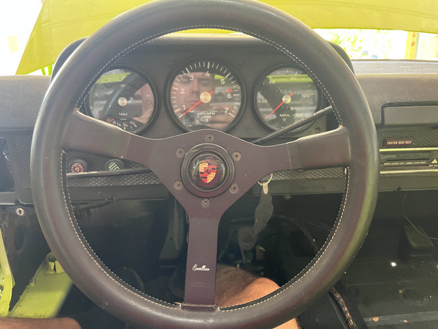

Made a little progress over the last couple weeks. Took on some easy stuff to get momentum again. Dug through my parts pile to find everything I needed to install the steering column, ignition, and turn signals. What made this challenging is that I was not the one who took it apart. Lots of referencing pictures and manuals and I was able to find everything though:
Roller had a factory wheel loosely installed with no signal or ignition

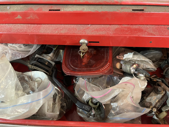

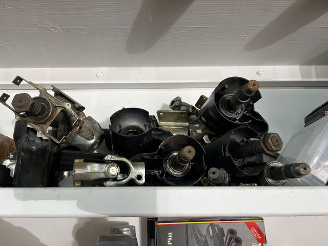

Had a whole pile of steering column parts
Found the ignition and turn signals in the tool chest of small parts.
Turned out good i think!

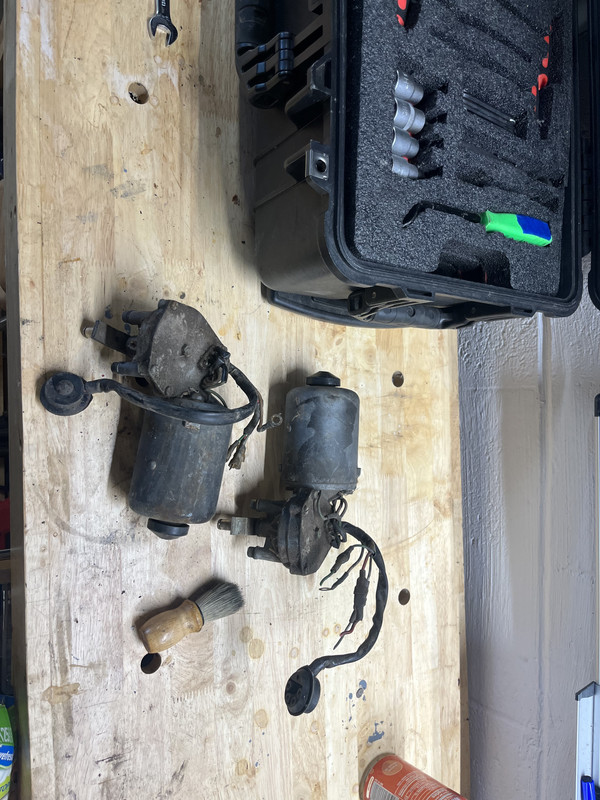

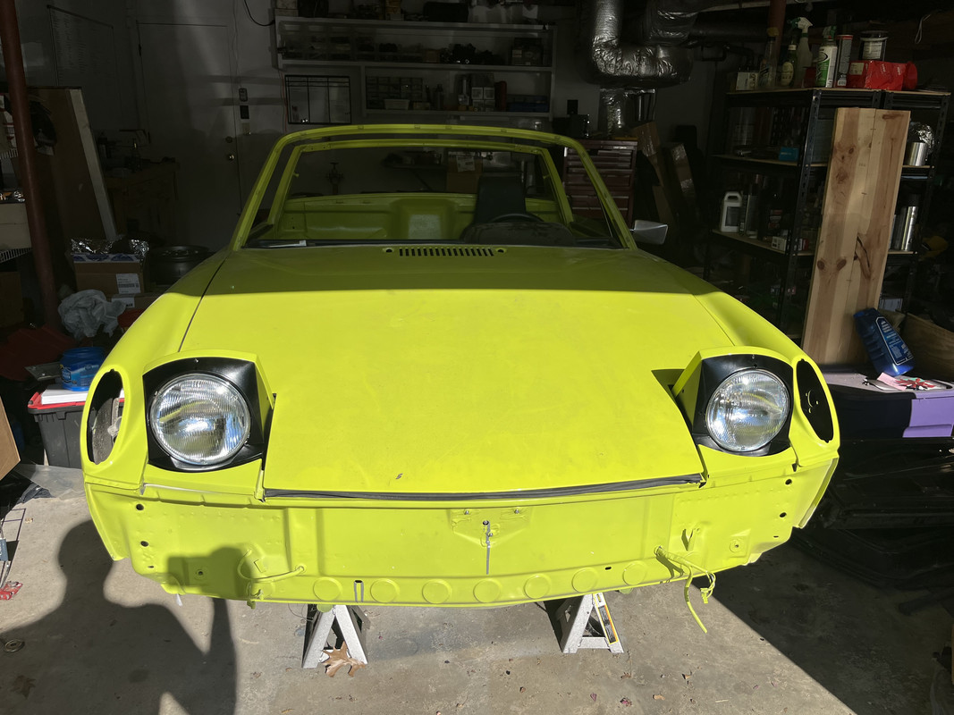

Also got the headlight motors, surrounds and lights installed. Watched Ian Karr's Youtube videos which were super helpful on this.
Motors were filthy but tested out good. Got them cleaned up and installed

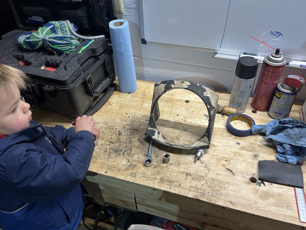

Got my little dude to help sand down the headlight surrounds, still needed more than a few layers of primer to smooth everything out.
Happy with the final product:
Also added my new front trunk rubber, didnt get any pictures of that except the key part of adding the sticker to my tool box

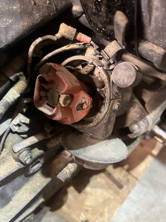

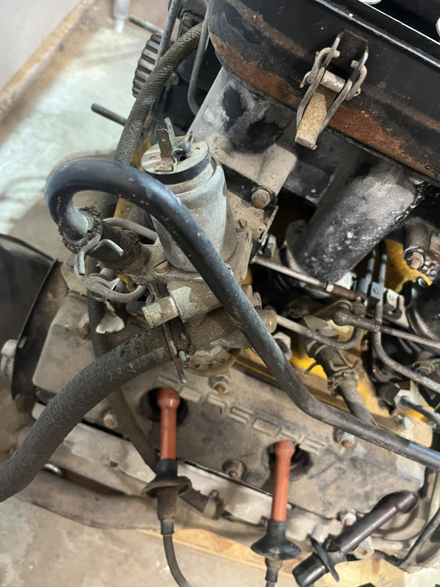

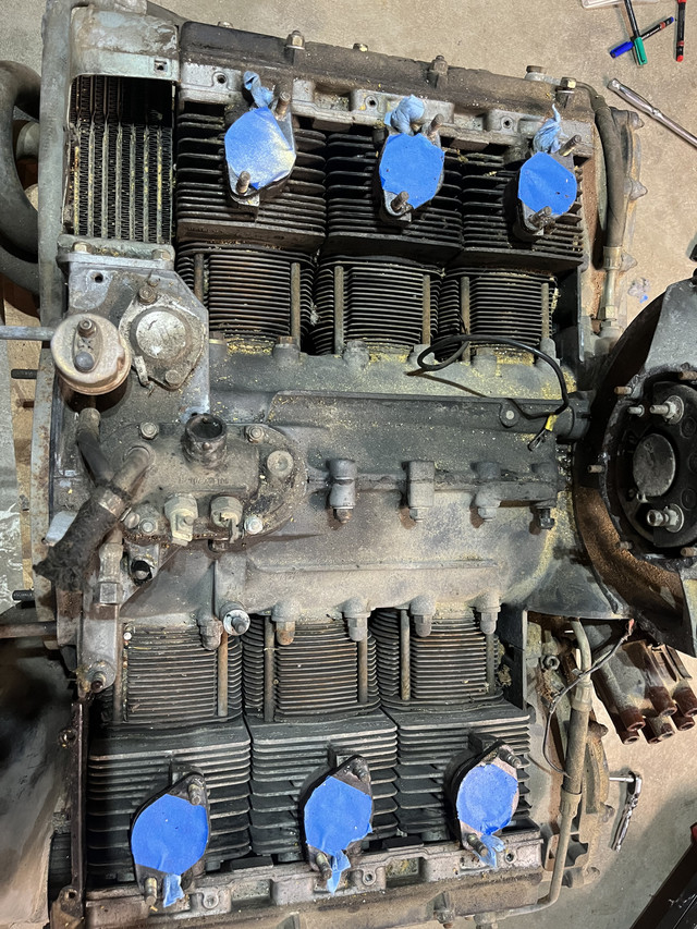

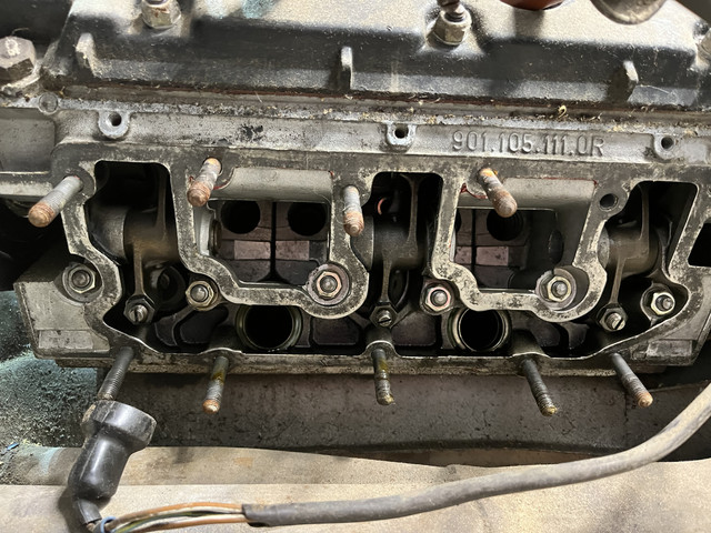

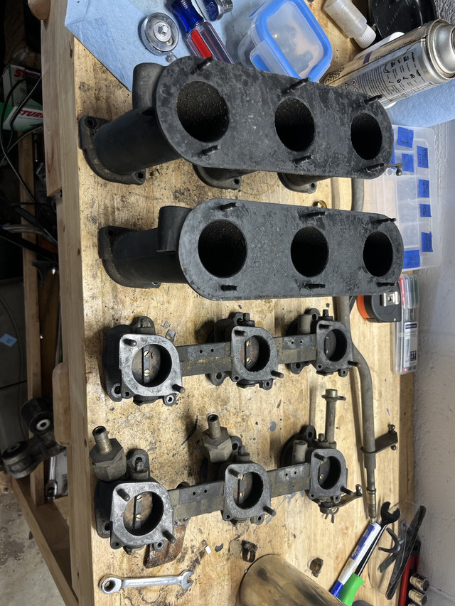

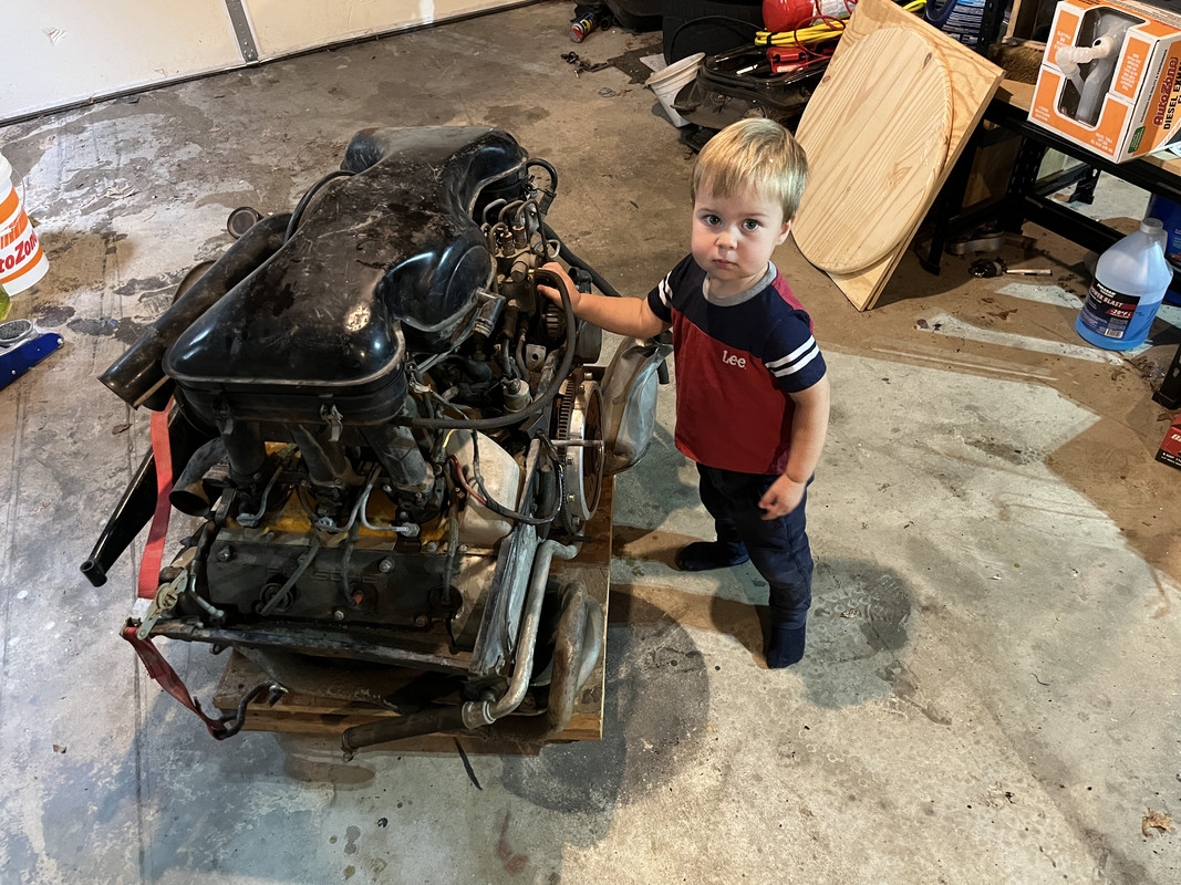

Got down to the long block, very encouraged by what I saw! Going to have to order some parts but definitely feel safe going forward without a full rebuild. Oil looked old but smelled and felt fine, no sparkles.
Before taking anything off I identified I will need the MFI pump drive belt, one throttle linkage, one throttle link is missing, alternator pulley and belt are missing, one TB trumpet is damaged. However all throttles move smoothly and no obvious external damage
Under the cam covers everything looked clean. No loose head studs or obvious valvetrain damage that I saw.
Distributor doesnt look terrible but I think I will proactively replace it. Last thing I want when I'm trying to figure out how to get the MFI working is old worn out ignition components causing trouble.
Took me a while to figure out what this thing was. Component for a sportomatic shifter. Wont need that!

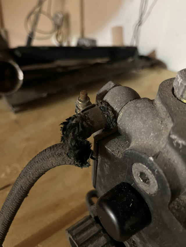

Fuel lines are junk but the pump itself looks good. The fuel in the injectors and hard lines was still fuel, not gunk. Still planning on sending the injectors off to be cleaned.
No signs of pulled studs. Despite being dirty everything actully looks pretty good. If you see something I missed by all means let me know!

technicalninja
May 1 2023, 08:46 PM
Leak downs on an engine that has been sitting for 6 months are almost always inaccurate. The longer it's sat the worse the reading are.
It's fine to do it but if you have some leakage, I'd write down the numbers and not worry about them.
I've seen a cylinder that tests 60% clean up to low 90s after running it a bit.
Super bad leakage shouldn't be ignored but a cylinder at 60% wouldn't bother me if it had sat for awhile.

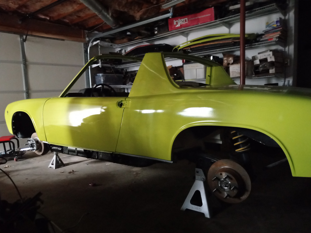

B3owulf
May 5 2024, 06:59 AM
I have a small progress update. Unfortunately, I have been quite busy at work so have not made a ton of progress, just small stuff.
Got the brakes installed and found that all four calipers leaked, looks like whoever rebuilt them pinched the o rings when assembling. So I learned how to rebuild calipers and now no leaks!
Sway bar is installed, had to do a lot of parts cleaning and replace bushings.
engine progress is slow. I'm trying to ensure I dont break anything as the parts are so expensive. I cleaned up the throttle bodies and checked for shaft play (none!). Did a leak down test and results were not so good. The air was escaping from the exhaust valves. I have it at a friends shop now we will see what we can do. I'm hoping it is just buildup on the valves keeping them from closing all the way. We will see

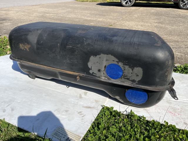

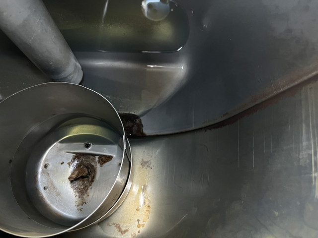

A local radiator shop cleaned out the fuel tank for me.
Sanded everything down and repainted it, just forgot to take an "after" picture. threw it straight in and plumbed it with tangerine racing fuel lines to the back.

#2 The leak down test with excessive airflow through the exhaust valves.
What I will do when I have obvious leakage through a valve is to lightly tap the valve/rocker arm with a wooden dowel and a hammer.
As the engine is at TDC you just barely want to "unseat" the valve and NOT bash the valve into the top of the piston.
It makes a DISTINCT noise when done during a leak down. A pneumatic "BONK' is the best way to describe it.
You WILL see the needle on the second gauge "flicker" big time.
Sometimes the airflow itself "blows" the trash off of the valve/seat and your numbers can come up dramatically.
Now, I don't think I could just install that engine...
If I was already to the point you're at, I'd be pulling the heads/jugs at a minimum.
I'd pull the valve springs and check valve to guide clearance.
If bad that's a trip to the machine shop.
If good you might be able to hand lap the valves in.
I'd replace the rings and have the jugs plateau honed at the machine shop if the piston and cylinders were re-usable.
I'd replace the valve springs too. At least two of those springs have been sitting "compressed" for however long the engine has sat, I would not trust them!
Breaking a spring takes the valve and piston on that cylinder at a minimum.
At high RPM it could be catastrophic and take EVERYTHING!
Springs are cheap in my book. I consider them a "consumable" that should be replaced automatically on anything over 10 years old that you have apart.
Normally, I'm hunting "improved" springs if available.

We did have some success with "fixing" the exhaust valves however my friend and I agreed the engine needs the heads off for valve springs at a minimum, and probably machine work if we couldn't clean it up with lapping. I almost want to try running it as is but thats a bit more corner cutting than I am comfortable with.
I am a bit concerned I will sink a lot of time and money into the long block only to find a need for more time and money in the MFI system. I might be better off selling it as a core and keeping an eye out for a "normal" engine.
I think for now I will focus on getting the car on the road with the four cylinder. I want to keep momentum on the project while I have some time available. I can get the car driving and have some fun with it while I find a route for the engine.
ClayPerrine
May 6 2024, 09:10 PM
You definitely need to have a hand throttle with MFI. It is mandatory for the warmup process.
If you are really planning on running MFI on a 914, then you need to find a copy of "Check, Measure and Adjust". It is the factory manual for setting up and tuning the MFI injection.
Read it. Read it again, slowly. And read it again.
Then follow it slowly, like your life depended on it. Do not deviate from the printed procedures even one iota. MFI is an analog computer. It is unforgiving and uncaring.
You will probably need to replace every single rod end socket on the MFI system. They wear out and if they are bad, the car will run bad.
And good luck finding a set of MFI protractors. They are required to set it up correctly.
When you first get it running, it will not run well. But with time, and lots of patience, you can make it scream. And the sound of MFI at full throttle is a dream to a Porsche lover. It sounds a lot like a 917.

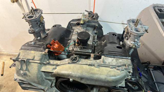

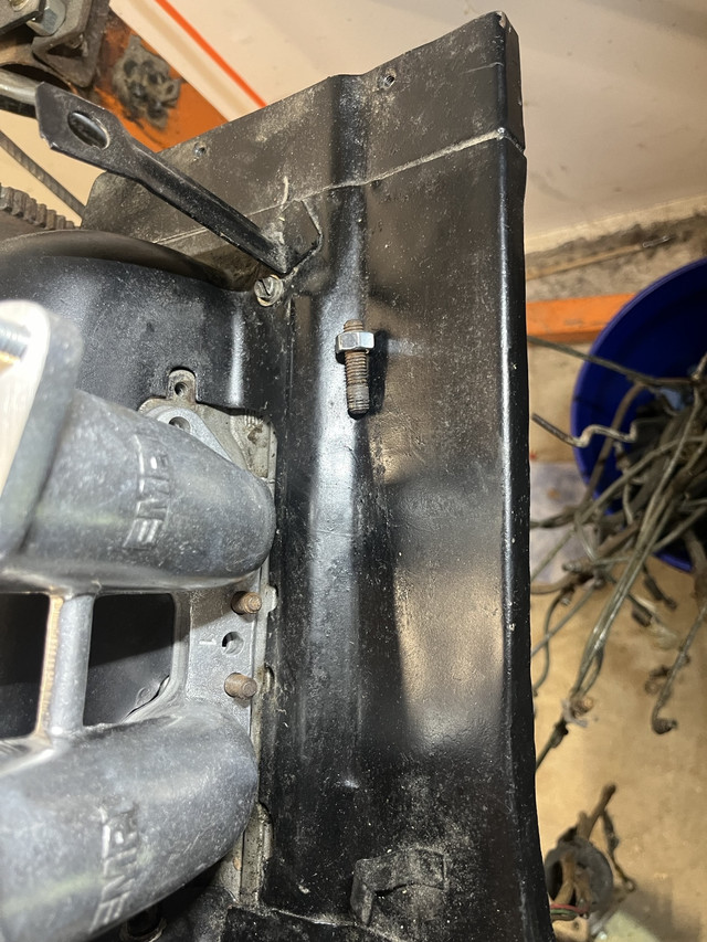

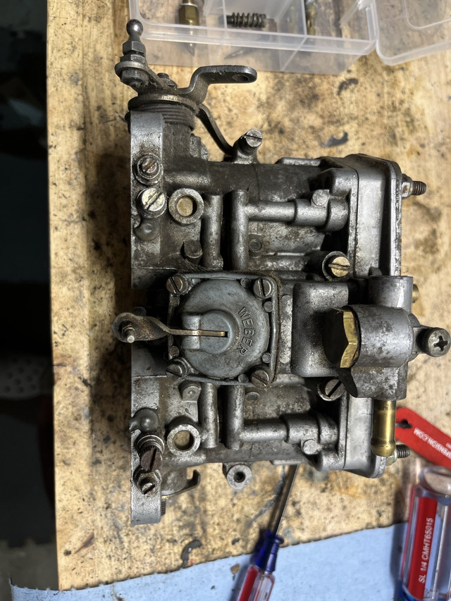

Quick update, I made some progress on the four cylinder and got the 6 conversion parts boxed up for the moment.

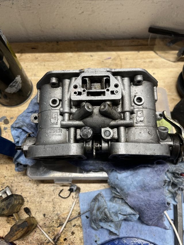

I had a set of weber carbs that were quite nasty but cleaned up well, I rebuilt them with some old stock weber rebuild kits I found. I installed a new distributor, carbs, and cleaned up tin on the 1.7. Just waiting on a couple small parts and I will join it to the trans and get started with wiring and fuel (if I can get my work schedule to cooperate).
I found two stripped out studs when installing the manifolds. Looks like the engine's previous owner tried the JB weld repair. It did not work. I installed some heli-coils and we are back on track.
I listed the 2.4 for sale locally at the "wouldn't it be nice" price. If it sells it sells but I'm also putting some money aside for a rebuild. If all goes well I will have a drivable car by the end of the year and then can focus on rebuilding the 2.4.
