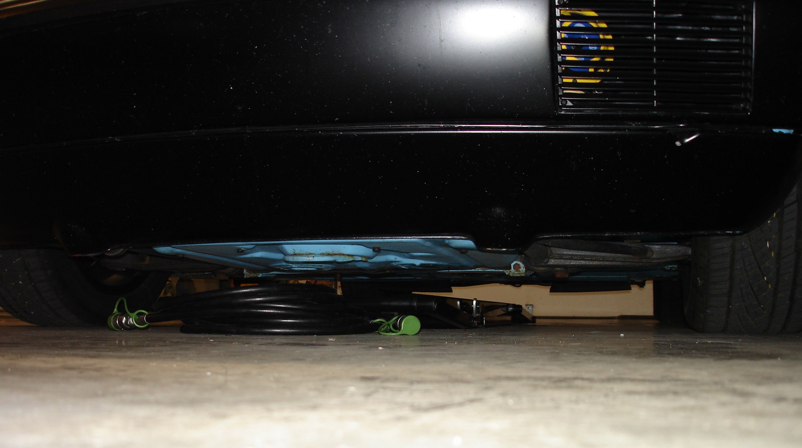

914sgofast2
I have been using one of these for a couple of years for all my cars (2017 Jeep Grand Cherokee; 2006 Porsche Cayman S, 1963 Jaguar XKE; 1970 Porsche 914). Assembling the Quick Jack and all its hoses is a bit fussy, but it works well. It's important to get the lifting points of the QuickJ ack properly aligned and centered with the Porsche 914's lifting buttons/donuts on the bottom of the body so the ramps don't rub against the tires and wheels as the jack rises up and the suspension drops down.
With all that said, I like it and it is a good alternative if your garage does not have a high ceiling.

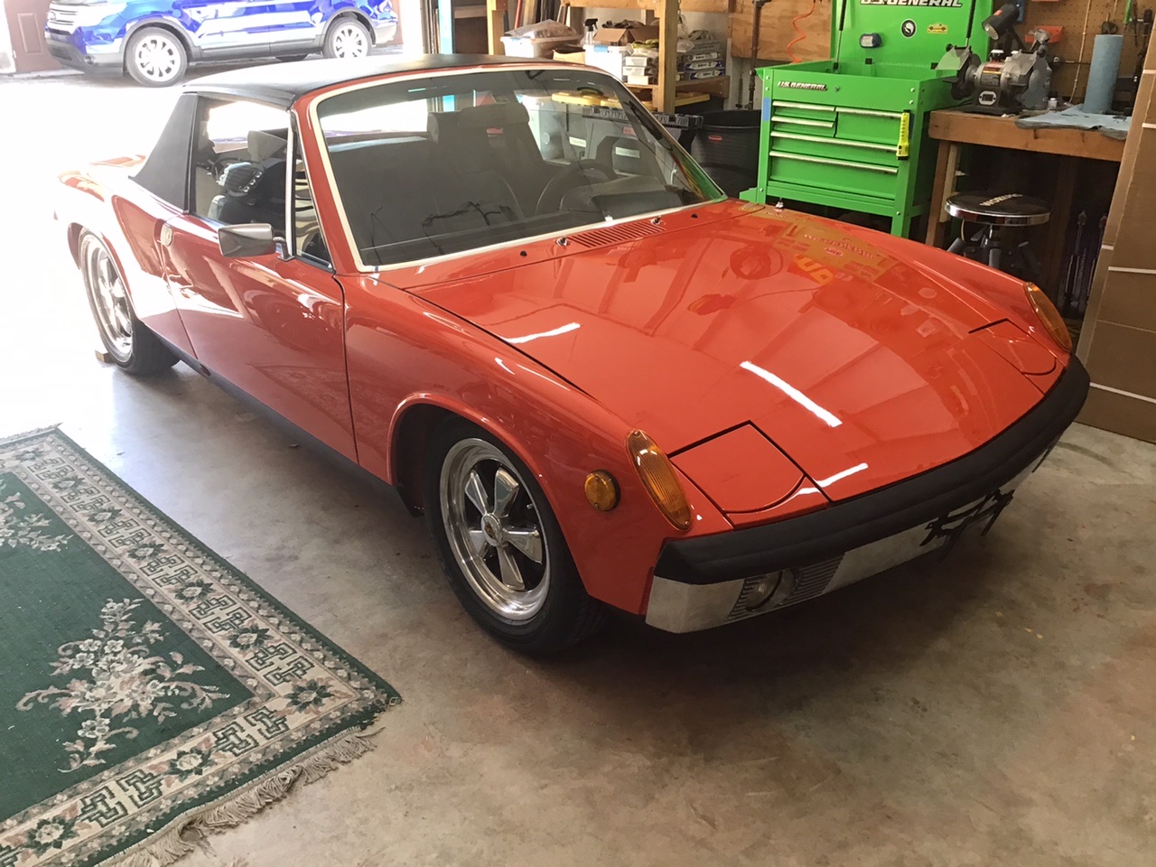

Morph914
Thank you, I wish I had these when I started my restoration but they will make any further work much easier. I’m loving my car, I have about 40 miles on it since completing it. Well, almost, I still need to get the car aligned and engine dialed in and a few electrical gremlins but other than that, very happy with the car.

John - I love my QuickJack.
And may I just say, that can't possibly be the same car! WOW! You did a great job on the resto! Let's see some more pics?

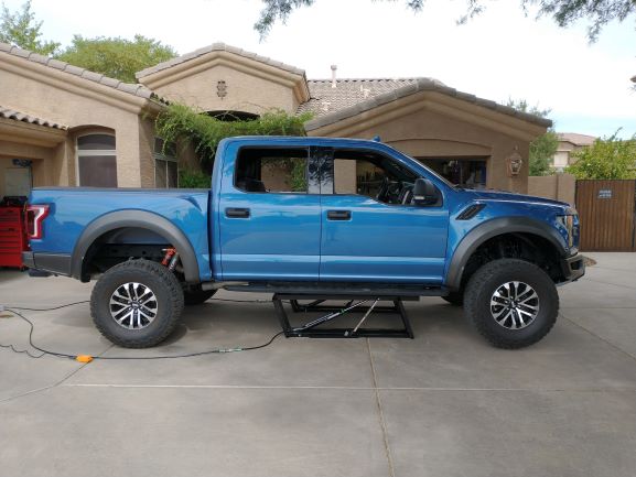

mgarrison
I got the 7,000lb model when Costco had it on sale. It handles everything from the 914 & Miata up to my Raptor. I needed the SUV adapters for the Jeep & Raptor. Turns out if you use the SUV adapters with the 914 it lifts high enough to roll the engine & trans under the 914 and then drop it down to install. ** I have a Subaru EZ36 & Subaru 5MT - not sure about stock motor and trans**
Click to view attachment Click to view attachment

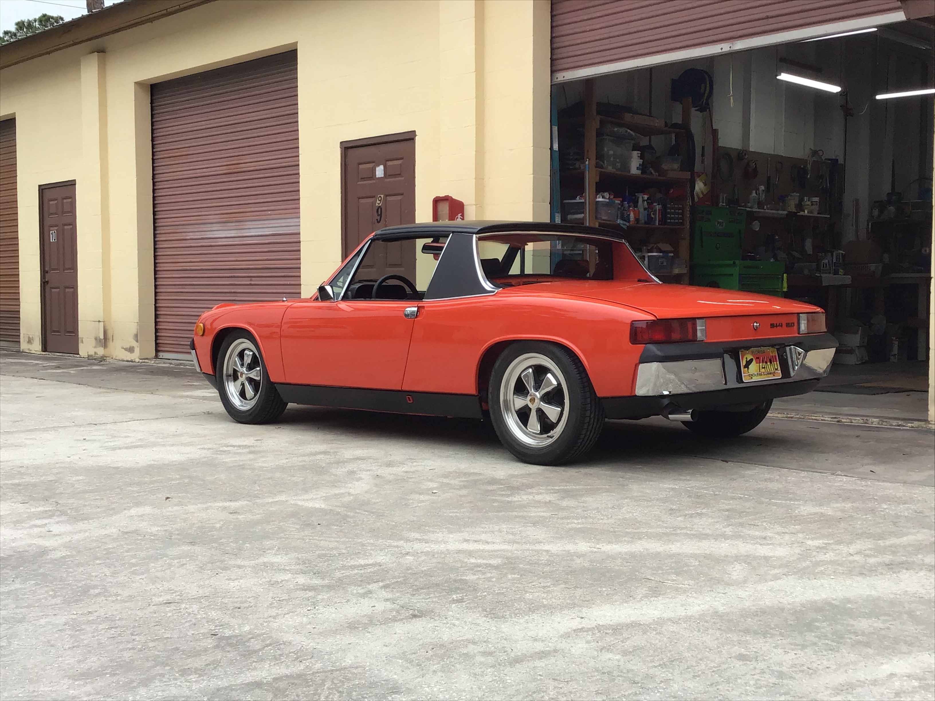

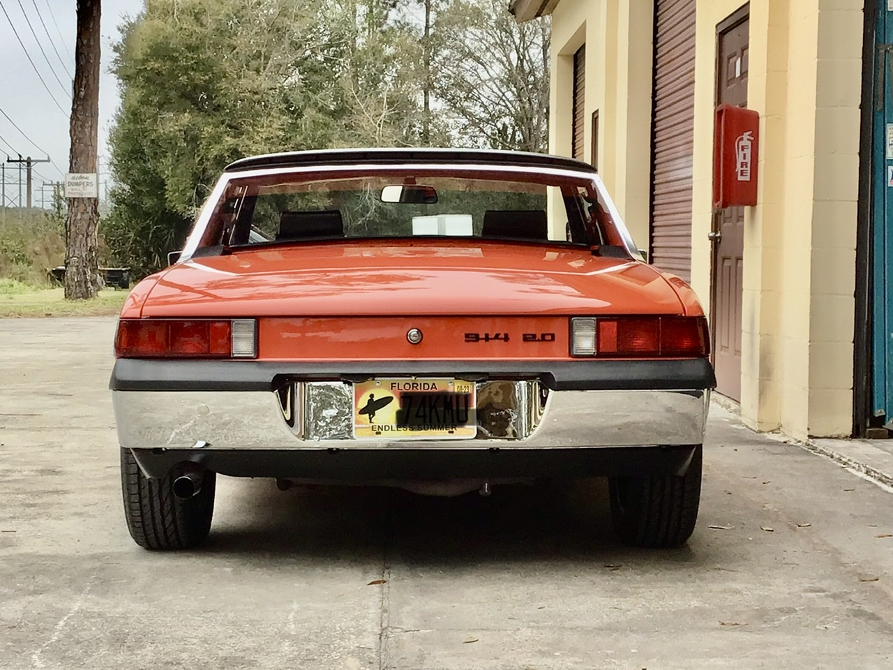

Thank you Chris, I had a good dry car to start with, so my restoration was easy compared to most I see on this site.
I have been following your builds and wow! You have become quite the fabricator and all around problem solver with all you have accomplished.
A couple more pics of mine…

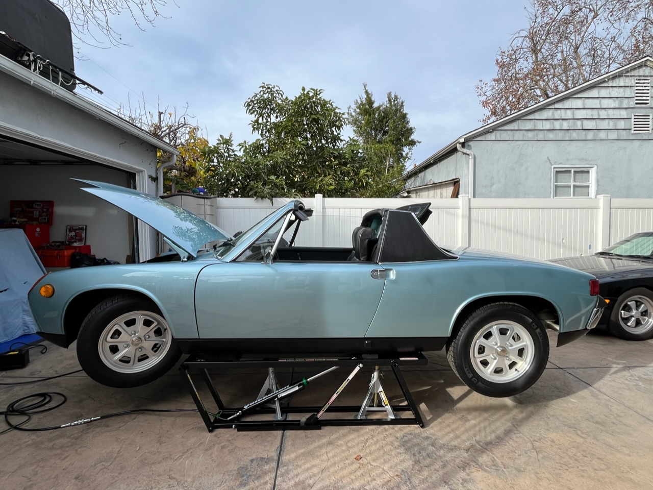

IPB Image
I've got a set of the Quick Jacks. I also have a 2 post MaxJax mid rise.
Seriously, get the 2 post!
Doing an engine swap with the QuickJack has had me cursing my lazy ass for not changing bays for the Bus and the 914, so the 914 could have the 2 Post lift.
The QuickJacks only BARELY gets the car up far enough to change an engine, and that included stacking the rubber blocks up to get the back a few inches taller. You really need to remove the valence to pull a motor. Or you have to strip the motor while its still in the car - which sucks. In the pic above you can see that the rubber blocks are doubled. You are not supposed to do that, but it worked and the car is still super stable.
When you are not using the QuickJacks you have to store them. Yes, they do have rollers, but they are pretty heavy, and they are cumbersome to get in position to lift the car. I've been keeping mine under the Bus. I would not store them under the 914, or under any modern car. Keeping them on their sides against a wall is also a problem. My GF broke her foot last spring when she tried to move one to get at something else, and it fell over on her foot. Again, heavy.
MaxJax also are "portable" and have wheels. I say portable in quotes because you have to remove 10 big bolts from the posts that hold'em to the ground. But once free, they actually take up less space against the wall then the QuickJacks, and are less likely to tip over.
Once the car is up in the air, QuickJacks are really REALLY stable. I would feel comfortable leaving the car on the QuickJacks all winter, and I would not feel right doing that with the MaxJax (though I have and it was fine.)
And of course you are still on a creeper with the QuickJacks. The MaxJax you can use a rolling office chair under the car.
The MaxJax are a little more expensive now that they are owned by Bendpac, and its not quite as portable, but I think its the way better option if you have a floor to bolt them down to. Obviously - if you have the ceiling space, get a full size lift. But most of us don't have that in our garages. Of the midrise "prosumer" lifts like the QuickJacks and MaxJax - the MaxJax is better.
