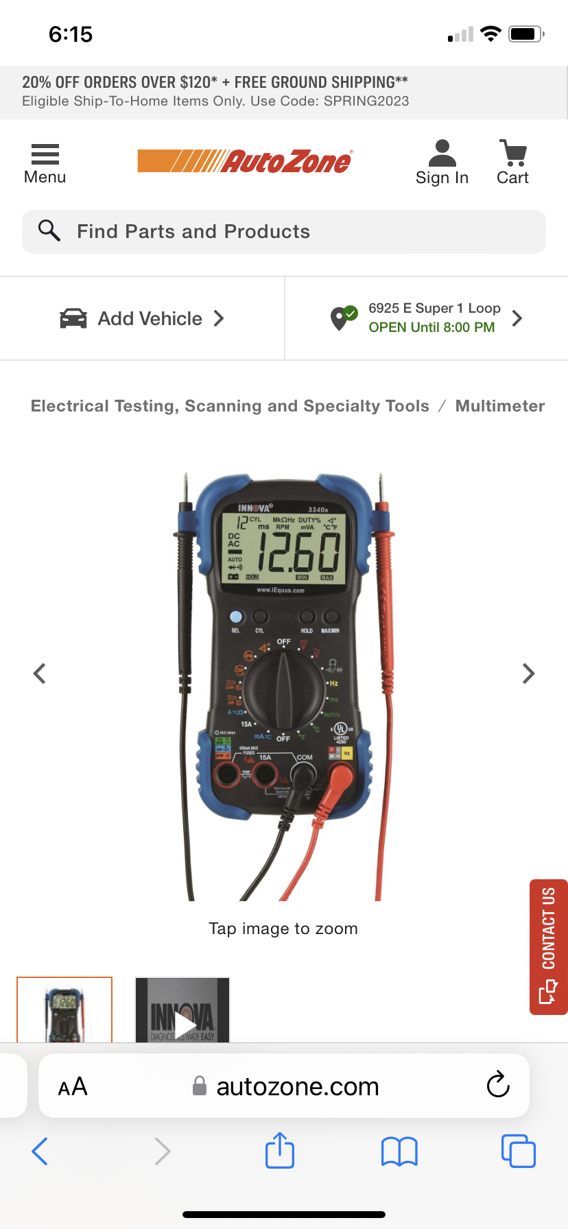

Dwell meters readily available.
Unless you really enjoy math and like compensating for fluctuating system voltage - buy a dwell meter.
Available in stock in Autozone in my neck of the woods but much more expensive

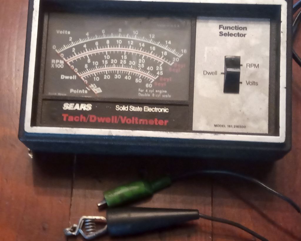

Rich, you can borrow my old Craftsman any time (unless I accidentally loaned it
to somebody else, would need to check the garage).

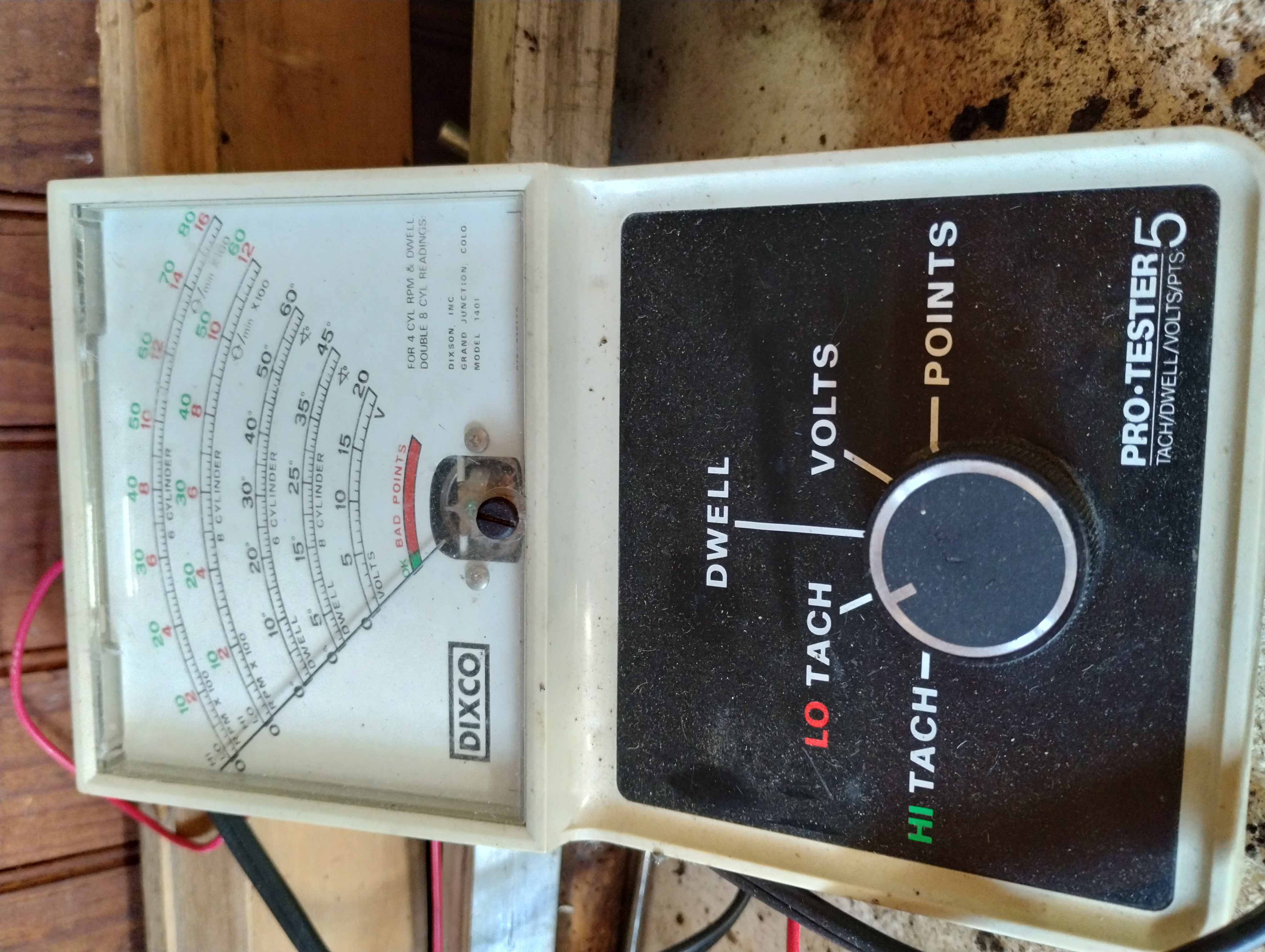

emerygt350
If you were nearby I would lend it to you. Otherwise from my cold dead hands, even though I don't have points at the moment....

mskala
r_towle
QUOTE(mskala @ Apr 10 2023, 06:38 PM) *
I had that same one, and while searching for it I found the manual for it in the toolbox.

GregAmy
I have that exact Sears one hanging around in my garage. I'd be delighted to permanently-loan it to a good home. As noted with others, I'll need to put my hands on it to ensure it's still around.
PM me if interested.
