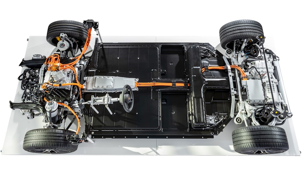

No, put a 914 body on a Taycan chassis.
The Taycan has a void in the chassis where the rear footwell is located. If you take that out, the wheebase is the same as a 914. I actually took a tape measure and checked a friend's Taycan when they were not looking. happy11.gif
Once you do that, drop a flared 914 body on top of the Taycan chassis.
If I ever win the lotto, I am going to Porsche's special wish department with a flared 914 chassis and asking them to put a Taycan drive train in it. That way you can take it to Parade and kick butt in the AX competition.
