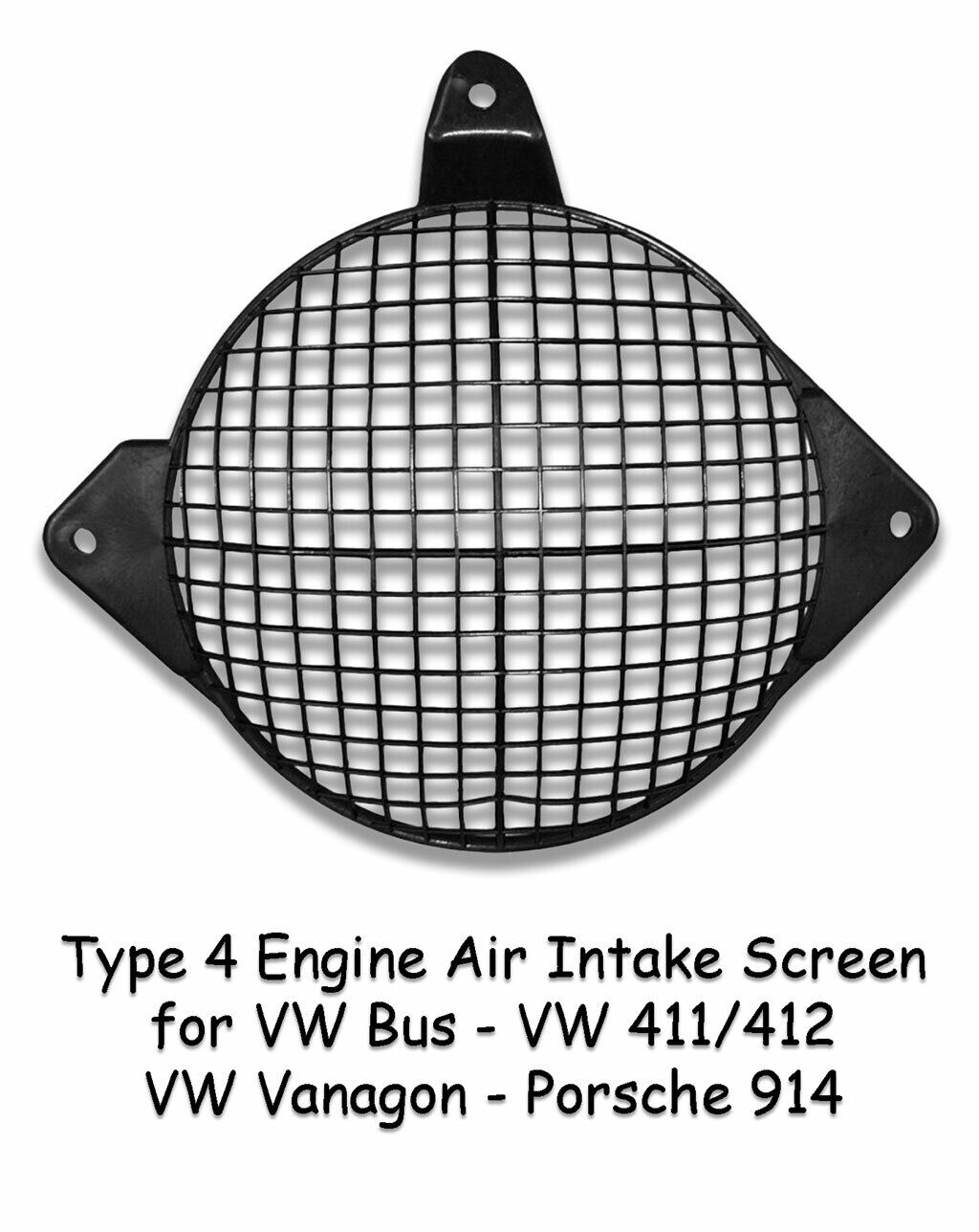

oh and get yourself a VW bus bird cage for that thing, this is why i have one now, i dropped a valve seat from a towel getting pulled in there and blocked air flow and the#3 seat came loose!

Was just thinking of doing something like that as have dropped two things down there but recovered before damage. What do they look like? Is there a part name for them? Do they get placed or mounted?

Sir Andy posted a picture of it, in this thread, it will work to keep the junk out. I have one now and has saved a paper towel from being sucked in.
DRPHIL914
https://www.ebay.com/itm/232899935766?chn=p...4YaAseQEALw_wcB
here is a e-bay ad for one

Being reasonably new to all things 914, a screen will be standard issue for all my future/4 projects.

Ordered the Type 4 fan guard (plastic one). Will get around to installing. Should (?) be easy. smile.gif

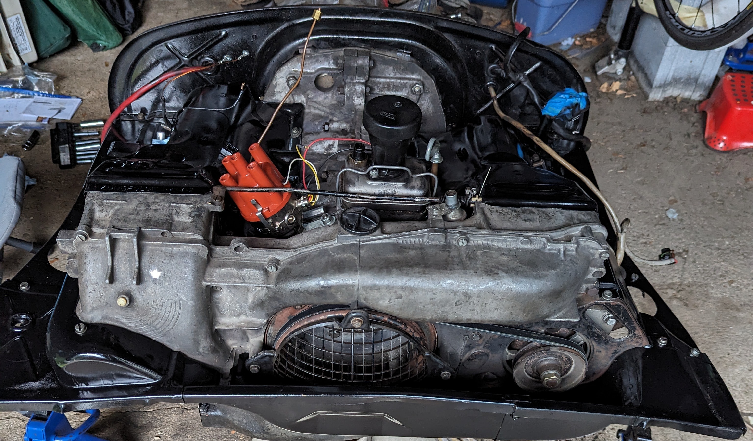

emerygt350
Look what I just added....
