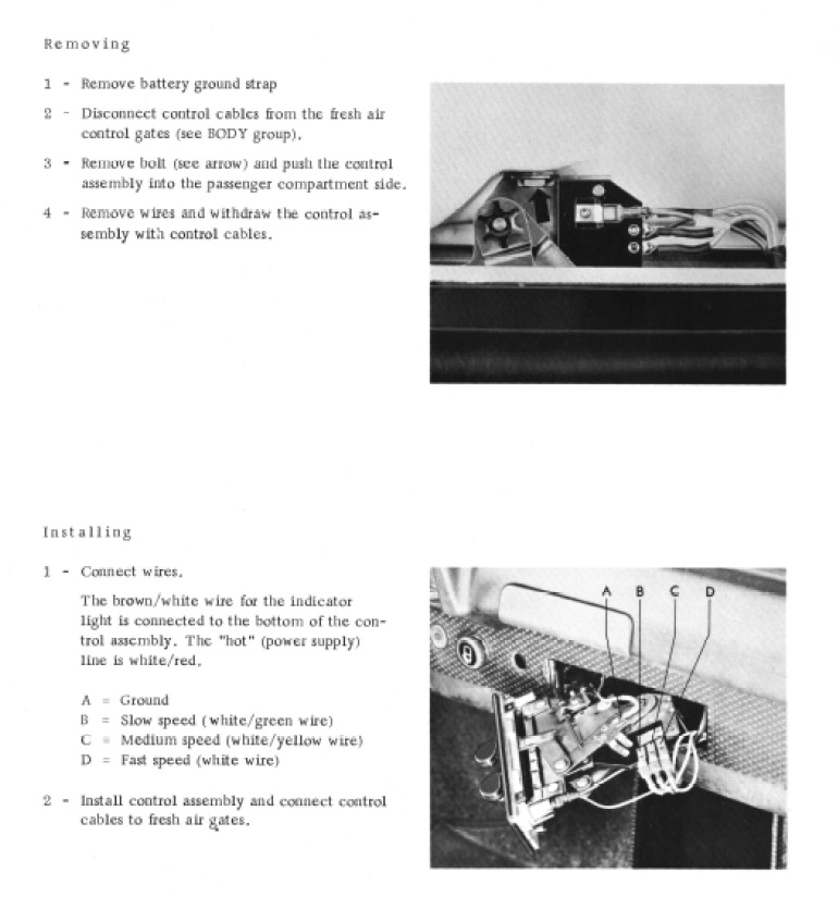

My V8 914 had no fan controls, so I used this diagram to install a rotary switch to turn the fan on. As mentioned before, make sure the plug is in on the fan itself and then short one of these wires to ground to test the fan. The key does have to be on.

Thanks! Sorry for the delay. I was out of town. You mean short to ground one of the fan wires (slow, med, high) fan wires? I tried that (just connected each of them to ground and the fan did not turn on).
