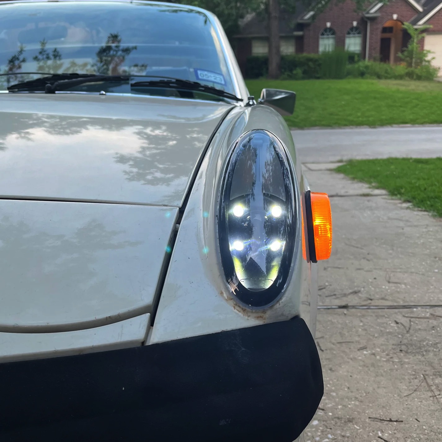

Cool looking DRLs. I like the LED projector lights as a backup to the main popup lights and would consider getting them.
BUT... Looking at the website my big concern is the LED bulb... one of the pictures shows the backside of the housing where the H4 bulb goes in. There is a cooling fan on the bulb. The inside fender is a nasty place where water, gravel, sand and dust get kicked up from the front tire. That LED bulb fan is not going to last past the first wet road.
