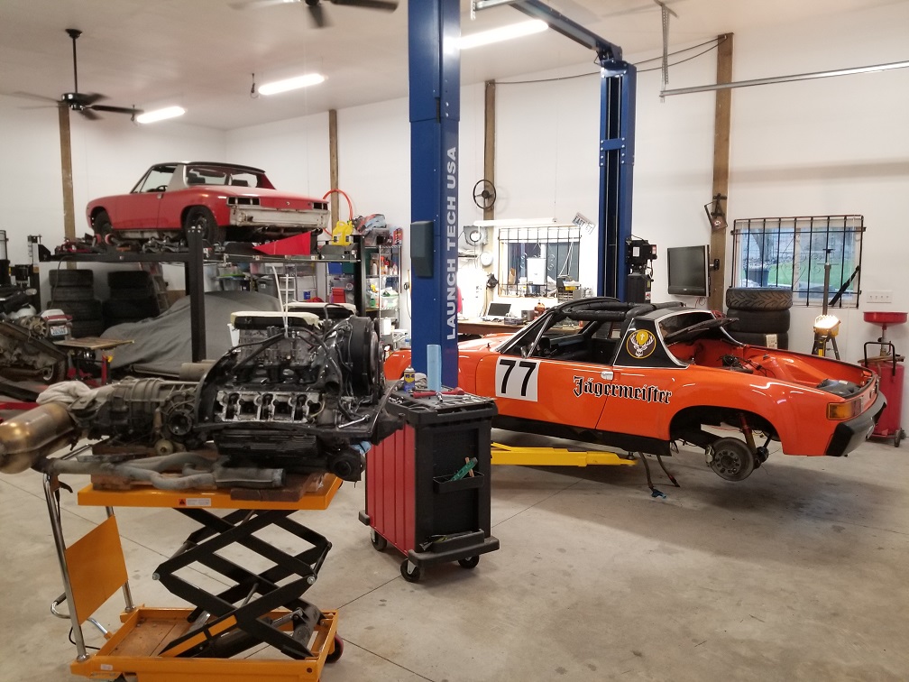

My GT tribute had sat for years when I bought it. A few winters ago, I got it running but then pulled the motor to inspect, adjust valves, etc.
We have a retired Porsche/VW tech who does house calls and teaches, inspects, tells good stories.
He said back in the day, the dealer techs all dropped the 6 engines to do a valve adjust. It was just faster for them and working to book, hours they were ahead of the game.
In progress.
