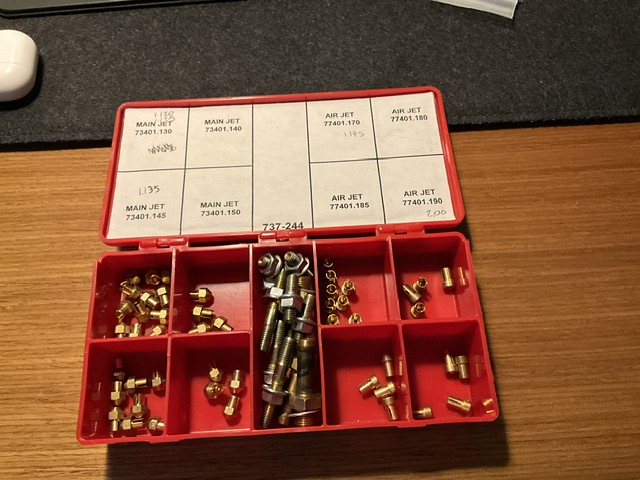

technicalninja
The altitude will mess with me here...
For Texas (600ft altitude) I'd use basic carb size of 40, venturis of 32, main jet of 130-140, air jet of 180-210, and idle jet of 50 or 55.
Due to the 7k plus altitude I'd expect that to need jets a bit smaller than what I listed above and maybe a venturis size of 30.
Whatever I did I'd be checking the actual mixture with a properly placed wideband O2 set up.
The 7k altitude has lowered the available oxygen by a significant amount.
Cars run like CRAP in Denver Colorado 6k versus Texas (600ft).
A 10 second 1/4 mile pass in Dallas is a 12.5 pass at Bandimere in Colo.
Less oxygen should require less fuel and equal LESS FUN!
Your main jets are way, way, off! I bet you're running 10.5/1 AFRs, and you will end up wiping the motor out via oil dilution with fuel.
Get a wideband and main jets that are a shitload smaller!
