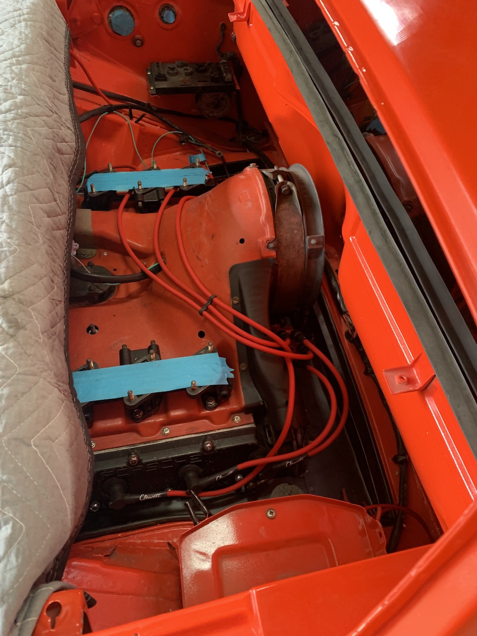

I have now tried two different fan belt sizes. Both seem way too small. The biggest size I tried was the 10 x 725. Is there a list of sizes of belts for the six-cylinder air cooled engines, I am not sure if it is a different alternator and or different pulleys.

I believe stock is 710. That said there likely is a mismatch of your belt doesn’t fit. You have to either match the pulleys or buy 4 different size belts until you find the right fit.

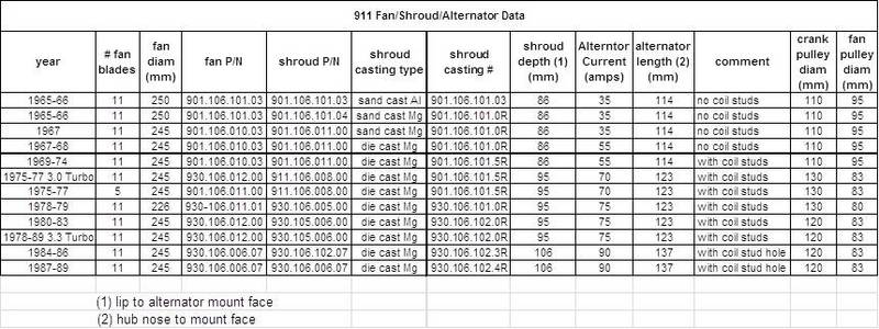

Once upon a time I saw this discussed on the pelican 911 forums
Not sure if there was a chart or just comments about them
We tested the large pulley in a non oem combination to increase fan speed
Played the belt game a half dozen times
Loving the hole in the firewall
