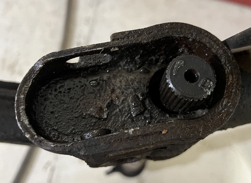

Any tips on how to remove a stubborn front torsion bar? I soaked it in penetrating oil. Clamped onto the end with vice grips. Pounded it from the sides with a plastic mallet. That thing is in there. I got so frustrated, I dropped the entire front suspension to see if I could get a better attack off the car. Still stuck.
As far I as can tell, there is no way to access the other end to pound it out. Only wiggle and pull?

I may be buying new a-arms and torsion bars. Today I'm back with the car. I tried:
  • Vice grips on torsion bar and pulling
  • Hammering the rear exposed part of the torsion bar to drive it through the cap and out the front with BFH
  • Drilled a hole in cap at the front and using air chisel to impact it out from front end
  • Lots of penatrant oil and propane torch.
I'm guessing if it is rusted in that bad, they both may be damaged beyond reasonable use. Anyone else faced this much resistance?

It finally freed up after drilling the cap off, liberal oxy-acetylene application and a lot of banging. smash.gif
Wow. That was a lot more effort than I expected. I really love the videos where people slide them out with two fingers!
I was expecting the torsions bar to be ate up with rust. Surprisingly not. I'm still not clear why it was so froze up.
