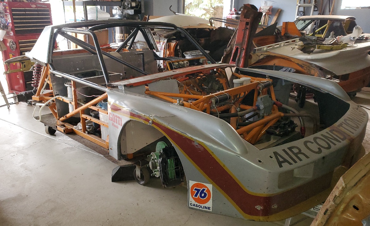

A couple years ago while knee deep in my house remodeling project this outstanding 914 race car came to auction with no reserve. I thought this might be a perfect chance to build a GT-3 SCCA racer so here I go!

Hari Matsuda bought the car in the 1990s turned it into a roadster and added a radical custom body. He raced the car in PCA for many years.

Hari then decided to turn the car into a Boxster with a 3.6L. In 2017 he decided to sell the car and somehow it ended up with Don Ramsay at Air Cooled Classics in Knoxville TN.

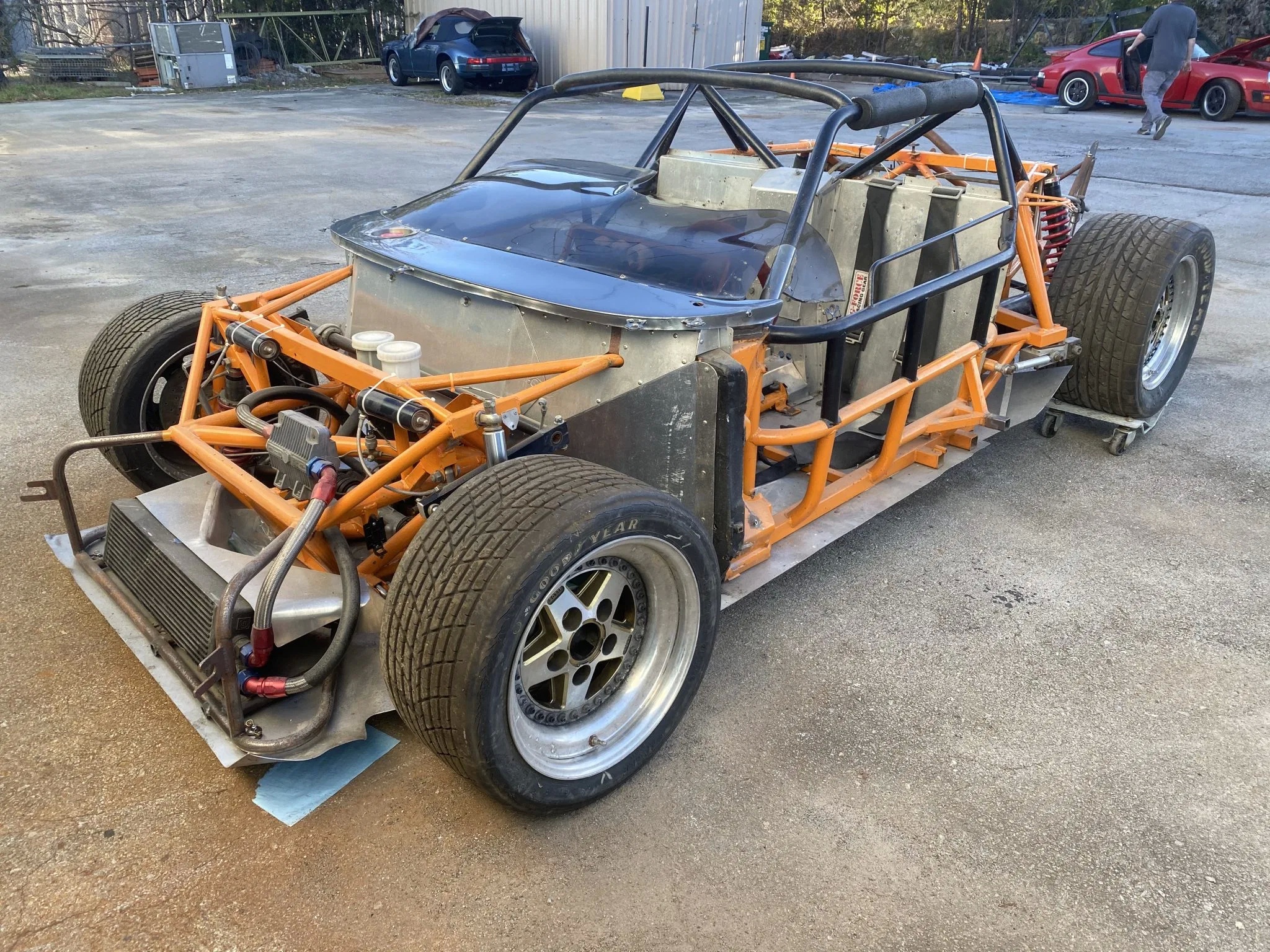

slivel
The car looks like a full tube frame without any remaining 914 chassis. Where is the fuel cell? That is going to be an interesting project.

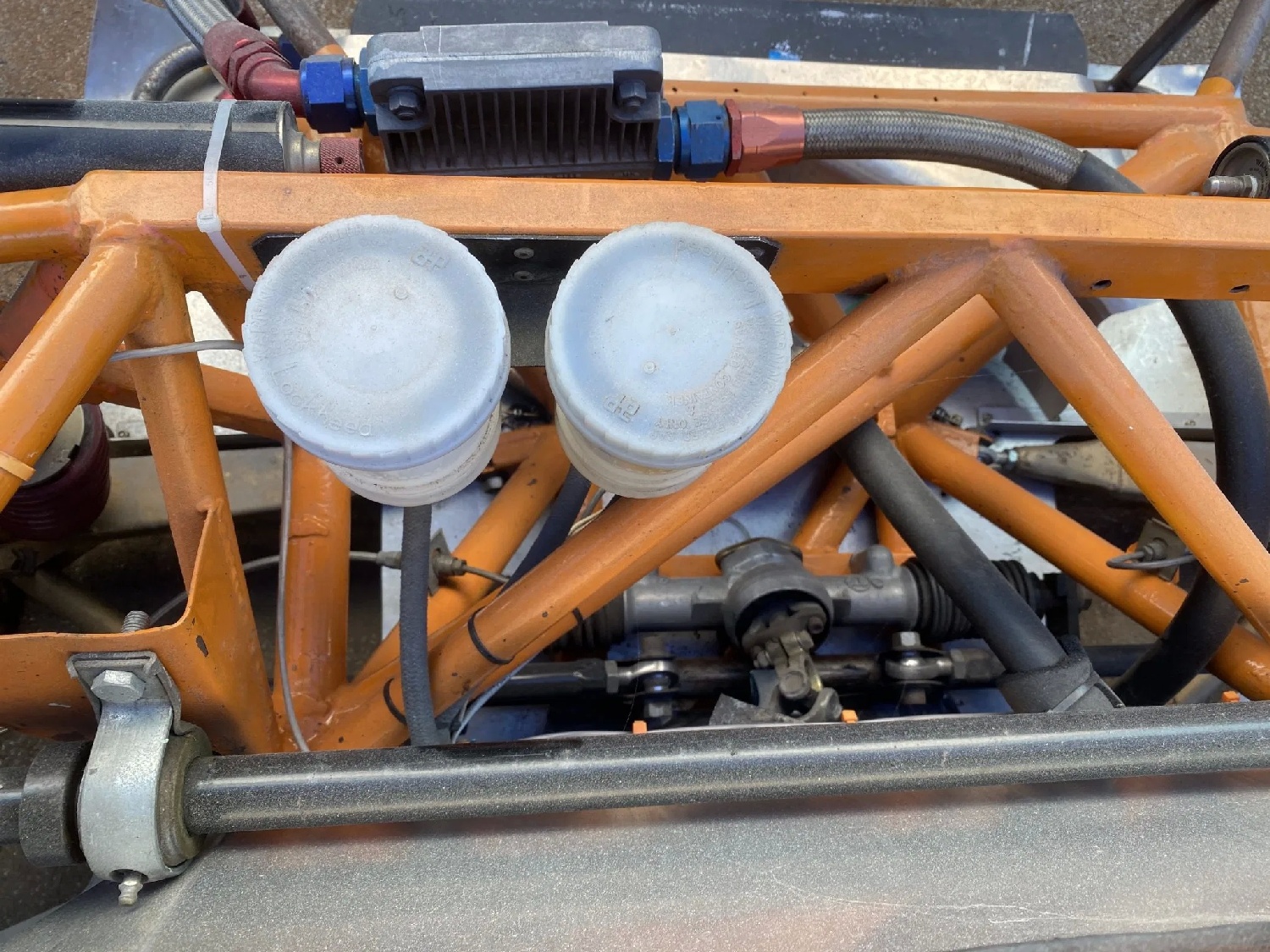

QUOTE(slivel @ Oct 26 2023, 10:54 AM) *
At this point no it does not
gereed75
QUOTE(gms @ Oct 26 2023, 12:04 PM) *
gms
Hopefully @Doug914 will add complementary
gms
QUOTE(gereed75 @ Oct 26 2023, 11:16 AM) *
there you go!

When it was run in SCCA the cowl was required to be stock, not a whole lot else.

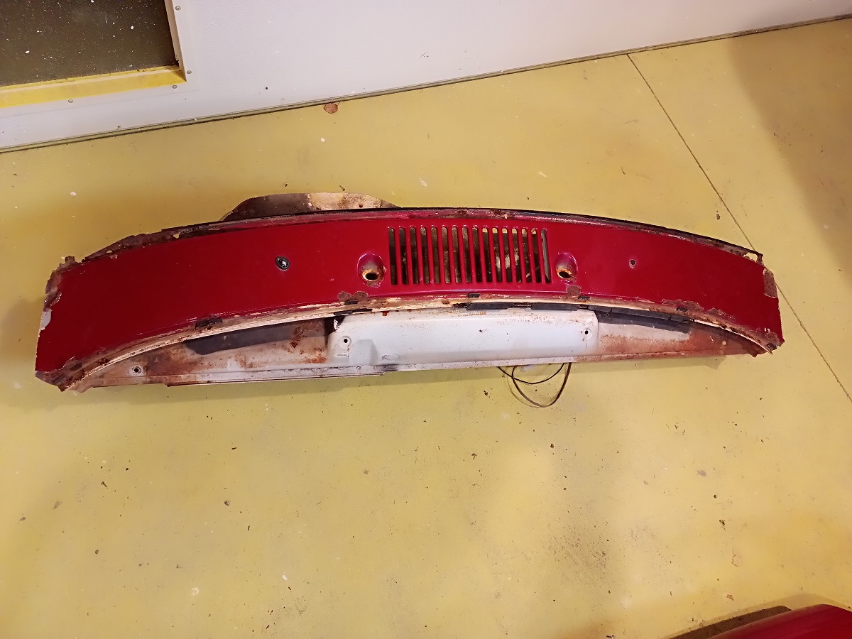

and the Boxster cowl is the first thing to go!
rick 918-S
You need this? I just cut it off the parts clip for the 6. It is in the scrap pile.

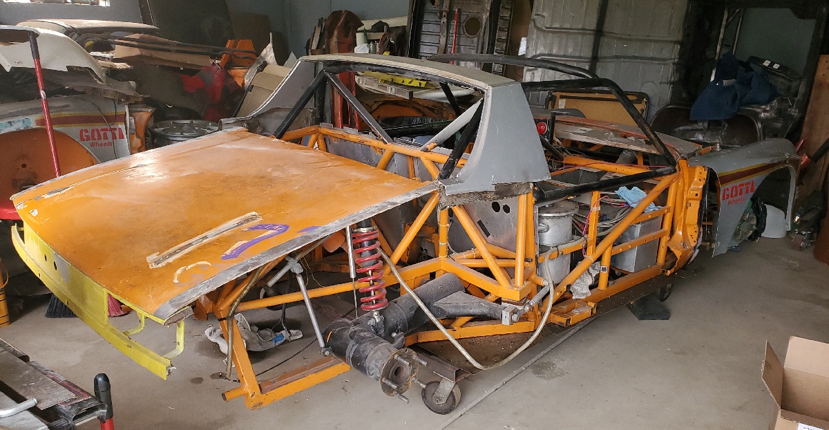

gms

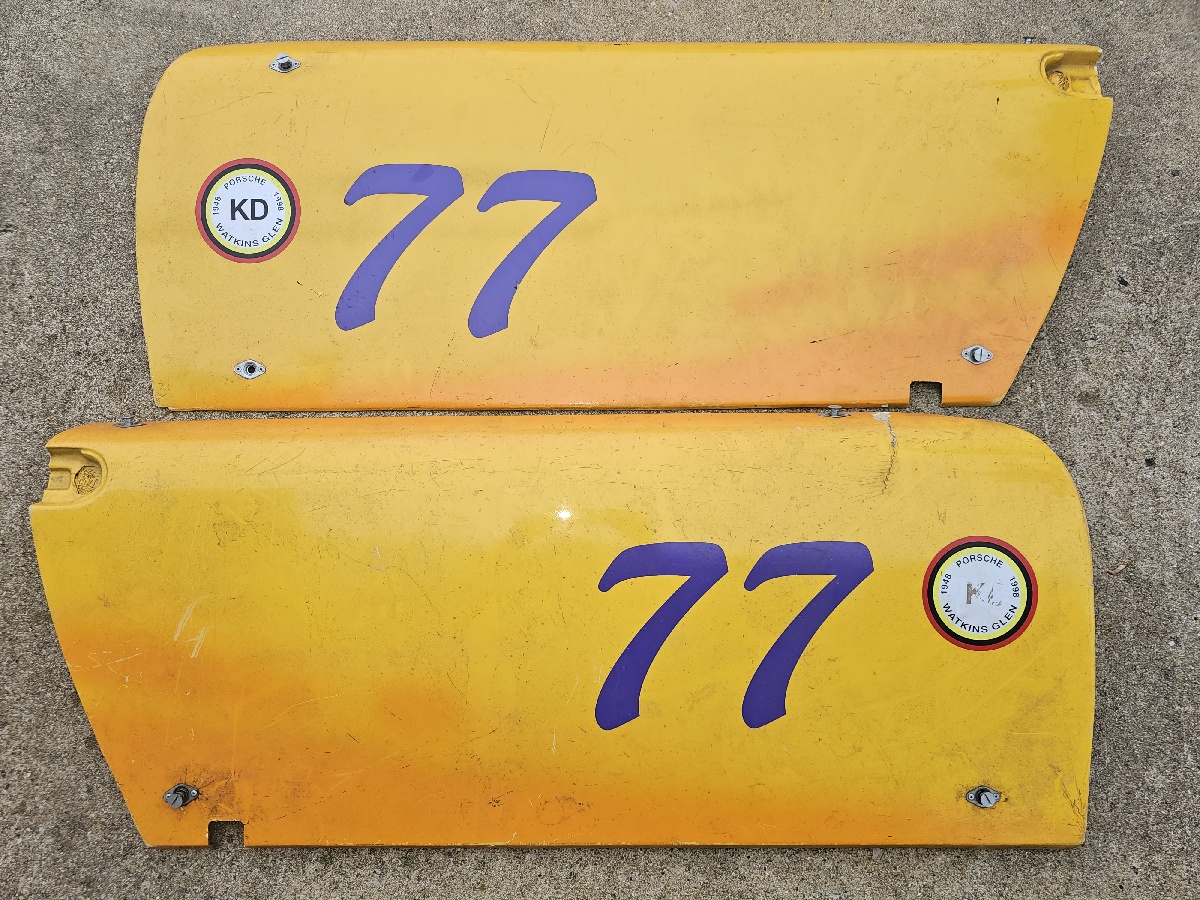

A friend bought the bodywork from Hari after he turned it into a Boxster. I have acquired the doorskins

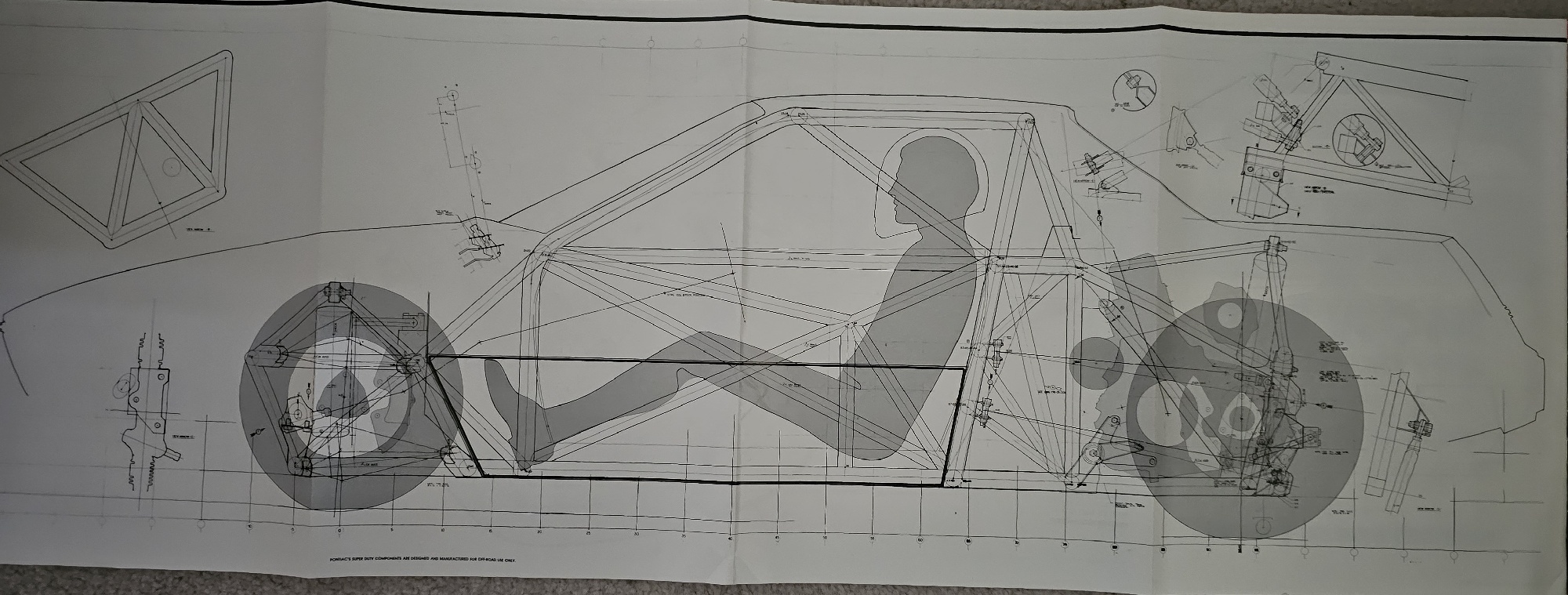

Anyone have blueprints for the chassis?

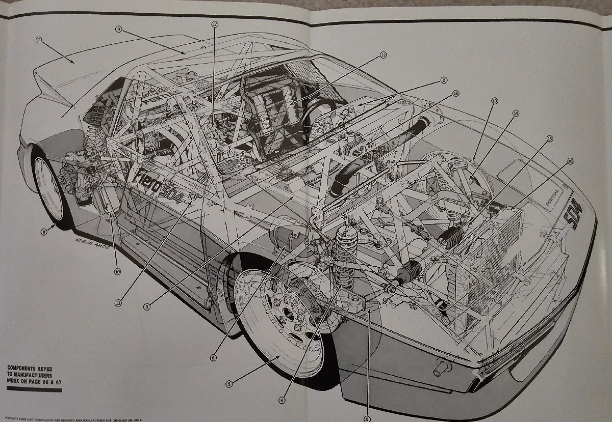

gms
QUOTE(73-914 @ Oct 31 2023, 01:06 PM) *
Here is the magazine it was published in
73-914
QUOTE(gms @ Nov 6 2023, 12:21 PM) *
Thank you

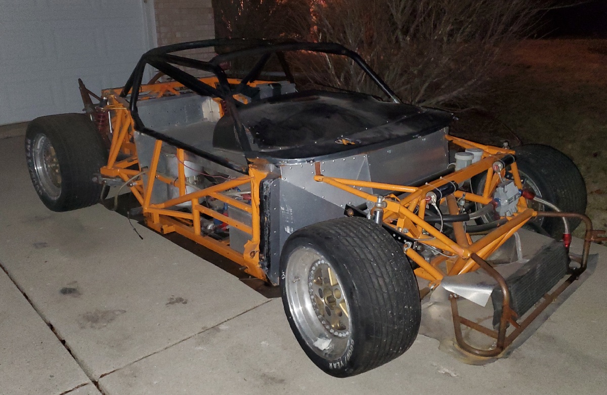

mocked up some of the parts to make it a 914 again
rgalla9146
Them are some special trailing arms !
Among many other interesting details.
Very cool.
stownsen914
I remember seeing those trailing arms when Doug was building an updated iteration of the 914 in the early 90s. Around the same time I was building my car.
Glenn - will that style bodywork fit over the suspension/wheels? I recall that Doug widened the car by a few inches and put the superwide version of Sheridan's bodywork on it.
Doug914
QUOTE(stownsen914 @ Nov 13 2023, 12:00 PM) *
Hi all
Yes the last iteration with those wider track trailing arms was designed for use with radials and the wide Roger Sheridan bodywork. In the end it proved a mistake. The car was never as good as the original narrower track version on the bias belts. Probably due to the early radials being so intolerant of the strut/trailing arm camber control.

QUOTE(gms @ Oct 26 2023, 07:19 PM) *
QUOTE(rgalla9146 @ Oct 26 2023, 05:20 PM) *
Glenn is that the Fiero/Huffaker chassis ?
It might be, I have to ask Doug
After the crash at Summit point I cut everything off the chassis except the front suspension box and the main flat floor. By this point i knew the fiero design was not all that good anyways. So i did my own design off what was left using a strut/ trailing arm setup per SCCA rules. Once done it was better right out of the box. 7 lap records and 30 or so wins from 1989-1991 at the national level.
I did a redesign for the wider track and radial tires in 1993 and thats what you see here.
