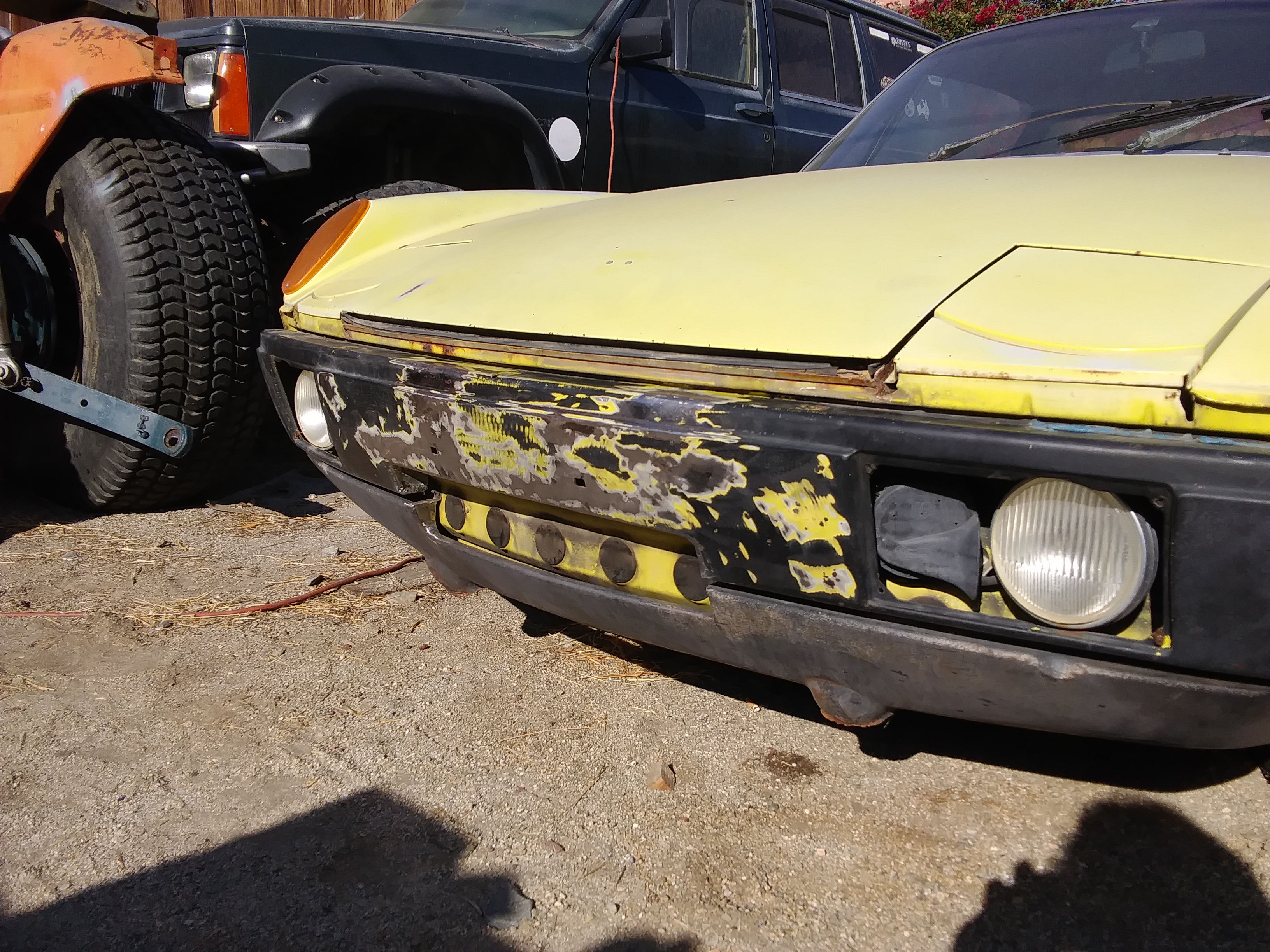

This would go on an other than stock 4 cylinder engine that was driven all year long in the socal low desert. Doing all I can do to get as much air in for cooling and an oil cooler. I had one in the rear but in the summer it was less than effective. So it will go up front where the coolest air is. I’ve seen the aftermarket rx7 coolers, I’ll just save for a while longer.
