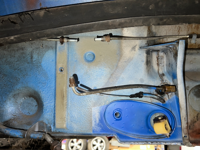

When you say "spray paint" do you mean a rattle can? I have purchased from Automotive Touchup. It is convenient, as they already have a lot of Porsche listings. It is not an exact match, but what would be after 50 years? Here's a photo of Adriatic Blue where I cleaned up some rust in our engine bay.
