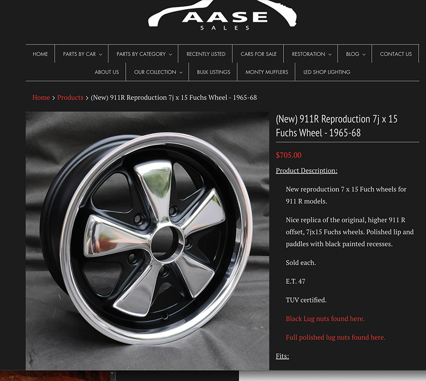

You can get a repo 7R for around $700. Something for you to think on.
Mark S is putting a pair on his car at PMB Performance. Sell your 15s and the cost of getting the wheels made, it may be a a better deal?

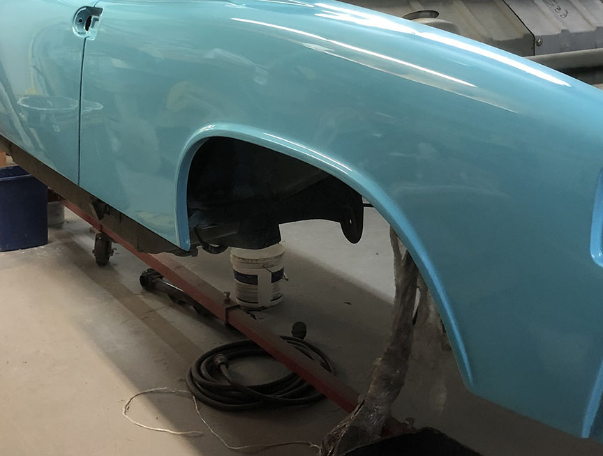

This is a picture of the rear of the 74 car that had 7s 911 numbers on back. The lip was flat down and may of had a yellow pages Squeezed under the Fender to bump it out.

Here's a link to somebody that has real 7Rs on their car. You can see it's a lot of rubber you can fit in there without rolling the fenders. PMB is selling the maxilite repos now. I would discuss with Eric before cutting up a set of good 6's. I am currently planning for a set of those unless a real set falls into my lap (unlikely).

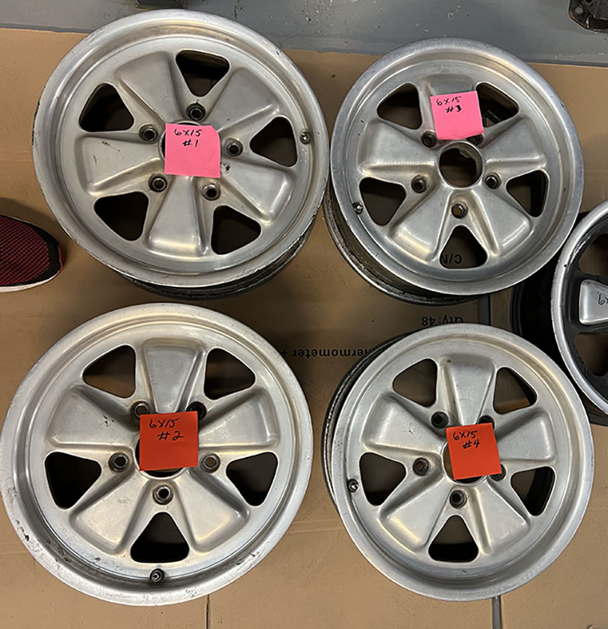

Jim, @jim dorociak Why don't you get some 6x15 factory Fuchs
Here is a set I have, Close by
Best Bob B
