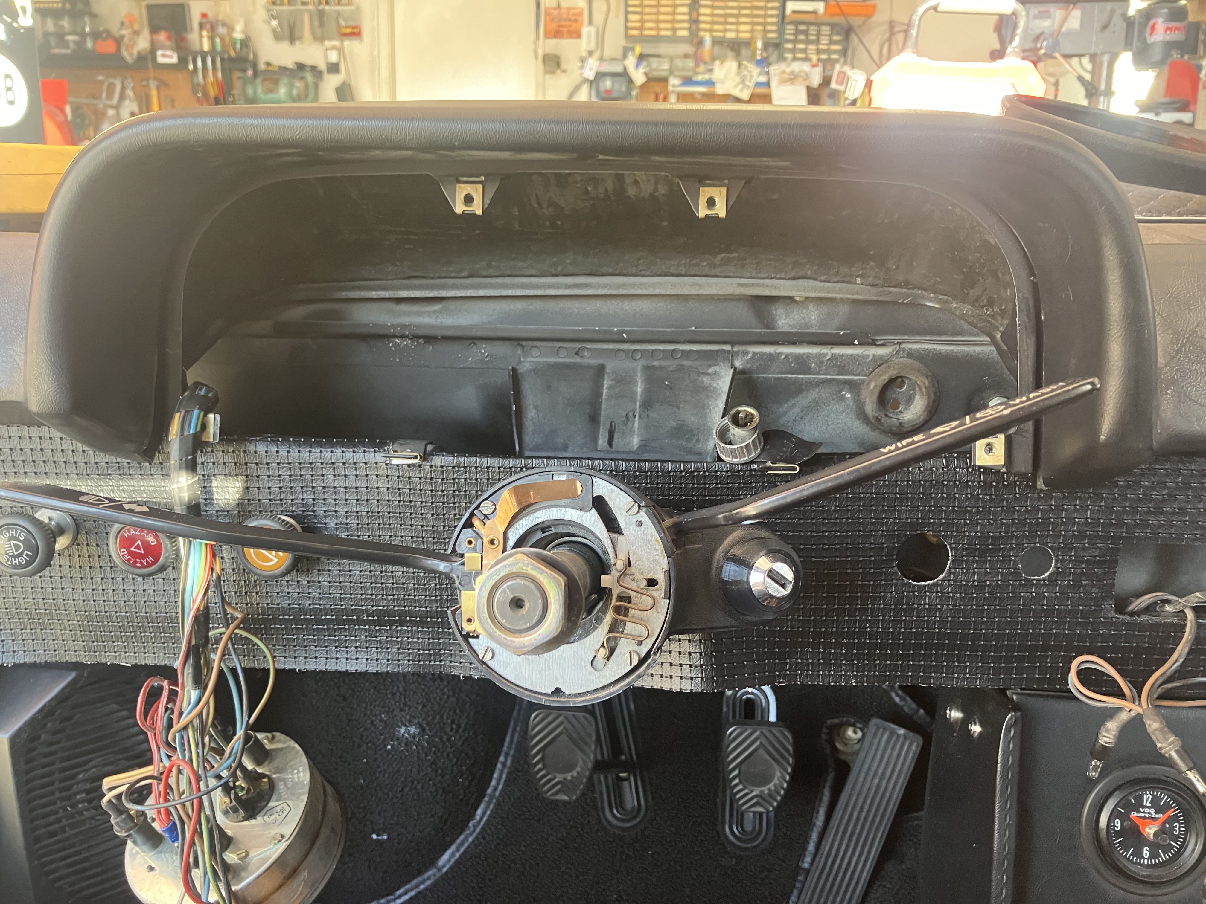

I've seen 2 styles of gauge lights thus far. One has a male spade built on to it. The other is hard wired. I have a few extra if you need one. I just had mine out last week. The other 2 gauges are hanging below the one in the pic. You may need to reach in from the back to push the gauges out from the rubber seal. Mount the rubber seals back onto the gauges before you push them back onto the panel.
