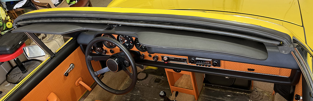

May 1 2024, 06:41 AM
I've nearly got the dash together and it's ready for install.
After fitting the 911 ignition and lock (it works), I pulled the dash to get better access to the wiring. It's nearly impossible to get the light switch down without removing the dash.
When all the dash wiring was free I nearly cried. What have I got myself into? Good to pause, drink a beer or two and consider what comes next. I do have a plan thanks to the excellent wiring assistance from Ken Salvail and Tom Butler:
http://www.914world.com/bbs2/index.php?showtopic=369800I'm not sure if I have the sequence right, but I decided to finish the dash refresh first and then reinstall the dash so I could move through each switch and have a finished dash before lighting the fuse, so to speak. Hopefully no sparks. Onward!
Tom1394racing
May 1 2024, 07:51 AM
Looks good John!
On my build, I installed the metal dash without the top to make it easier to connect the switches and gauges. Once I had everything working, I removed the switches with the wiring in place, grouped and photographed the gauge wiring, removed the metal dash, installed the dash top and then reinstalled the dash, switches and gauges. I found much easier access to the wiring that way.

All systems are now nearly ready to go.
Yesterday I wired in the battery cut off. The PO located it in the frunk, which was awkward to access with hood pins. He also ran the battery cable down the right side of the passenger seat and it interfered with the seat lever. I moved it next to the tunnel harness, along with the wires for the seat heaters. Now I have an easily reached cut off, and an added security key!
I struggled with the wiring but found my way through with some great help from 914World members and a handful of blown fuses. I know it looks horrible, but everything works properly and I'll sort it nicely before returning the harness to the dash. I'm waiting on a new turn signal switch (I discovered this one was broken after a lot of work to plumb it into my harness X!!!!) Then a little painting, insulation and carpets. It should all be buttoned up in a week or so for some spring drives.

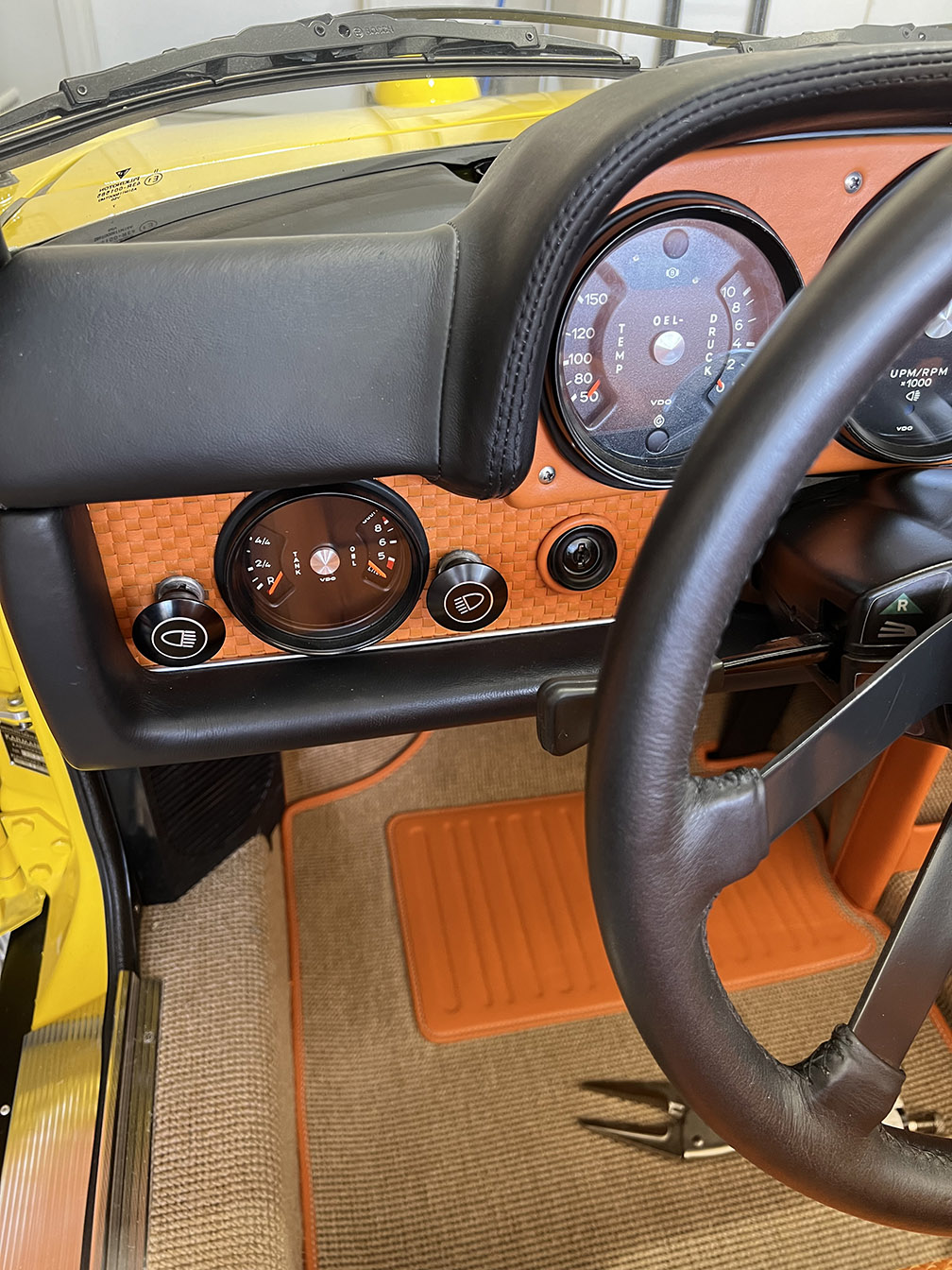

May 24 2024, 05:11 AM
I tied up the wiring and reinstalled the gauges and dash knee pad. Took a good long test drive with the fire extinguisher close at hand. My son took a good turn at the wheel and gave his approval. Everything worked great. Waiting on a new fog light switch (my one wiring casualty).
One nit. The dash facia material does not quite run low enough on the drivers side to close the gap to the knee pad. Everything is snugged up. It was a new piece from 914Rubber that I installed according to Ian Karr's video. Anyone know why? I suppose I can build up the knee pad with some material to hide this gap. Not a huge deal but given the time I've put into this conversion I'd like to address it.
Also, I need a sticker for my windshield wiper. The set is crazy expensive. Is there a good source for picking this up?
Last step to treat the floor. I'll paint the roll bar when I have the seats out as well as the battery cut off box. Then insulation and carpets.
BTW, this was my first drive with the top in the trunk. The sound of the exhaust and the bird calls mixing was super on a nice warm evening. And the car felt very solid. Loving the Targa!

burton73
May 24 2024, 01:19 PM
-----One nit. The dash facia material does not quite run low enough on the drivers side to close the gap to the knee pad. Everything is snugged up. It was a new piece from 914Rubber that I installed according to Ian Karr's video. Anyone know why? I suppose I can build up the knee pad with some material to hide this gap. Not a huge deal but given the time I've put into this conversion I'd like to address it.-----
I do not know what to say but, my 6 has a small chrome trim that is attached to the bottom bolster. Just so you can have a look see
Best Bob B
Click to view attachmentClick to view attachment
morehills
May 24 2024, 03:25 PM
That's it Bob. I'm missing that small piece of trim. I wonder if it's separate or if I will need to locate a different bolster.
May 24 2024, 05:28 PM
QUOTE(morehills @ May 24 2024, 05:25 PM)
It’s actually two pieces of trim, glued on the lower bolster. I had a spare booster with the trim. The vinyl isn’t in great shape so I pulled off the trim so you can use it on yours. PM me your address, pay for shipping and it’s yours. Unlike the bolster, the longest piece of trim is only 3 feet long so shipping will probably be $15-20 to you. You will have to clean off the old glue from the trim before you install but I bet that’s not too hard.
*sorry about the pics. My camera don’t like the background.
May 24 2024, 05:37 PM
No, I’m sorry, I’m wrong. The early pad ( no vents) has a single piece of trim that’s longer than the later trim. I don’t think my offer will work for you and I only have one early pad that’s set aside for my car.

Nov 1 2024, 12:55 PM
The interior is finally finished and I'm happy with the results. Lessons learned were to make a wiring plan, then take a punch in the face, and then make a new plan. But I got it all sorted and even tackled the installation of relays in the frunk to take the load off of the light and horn switches. And on the subject of switches, I'd suggest buying new turn signal and starter switches before undertaking this project. I thought I would save some money with used, but 50 year old parts are, well, 50 years used. Both failed and had to be replaced with new. Thanks to all of you who helped. Now I have an interior that suits the exterior.
