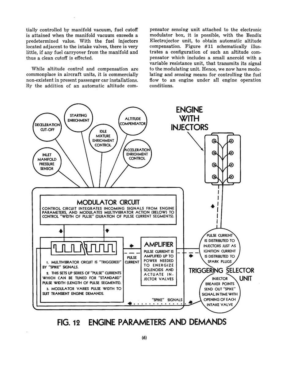

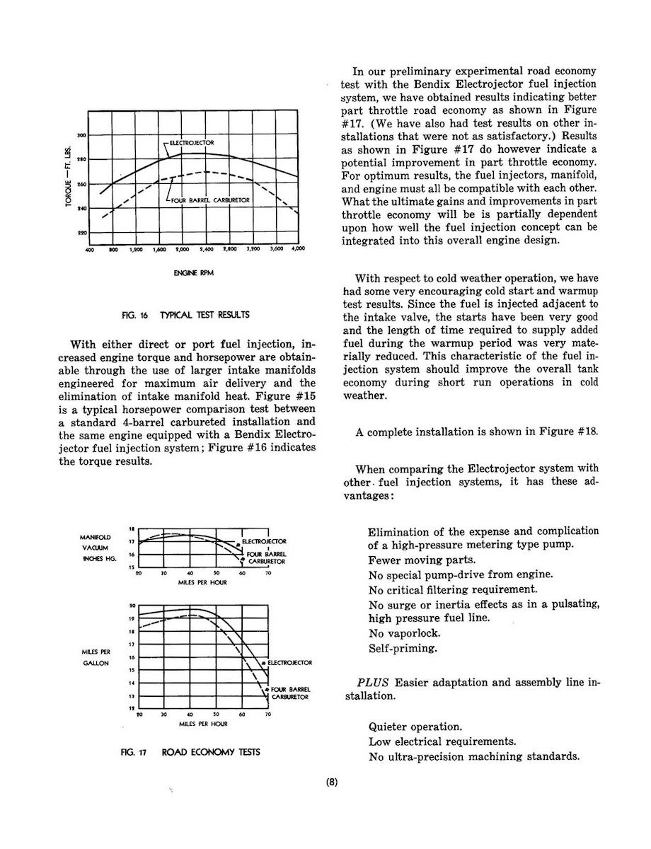

D jet by Bosch (Germany) is Electrojet by Bendix (Chicago).
They bought the patents or the license when Bendix and Chrysler gave up.

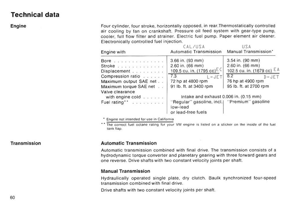

there is another reason for L jet and it being necessary in 1974.
i'd forgotten it but was a discovery in digging up all the "minutia" as steve calls it - for our L jet research.
VW could not get the 1.7 with D jet to work with automatic transmissions and pass CARB emissions regs (california) for 1974 calendar year. the D jet with auto could still pass USEPA regs for 74 but EPA was one year behind CARB.
that meant their big sedan/station wagon was a goner for 74 and they still wanted to sell it for one more year. the water cooleds were not ready.
and 99.9% of 4112/412s sold in the states were autos. thats what the customers wanted.
so.........L jet was absolutely the only way they could go with the type 4 engine.
only auto 412s as 4 door sedans and 2 door variants were sold in california in 1974.
no stickshift and no fastback version.
the 2 door fastback was sold in the rest of the USA with a D jet 1.7 in 1974 and only with a stick shift. very small numbers were sold. the rest were auto 1.8s as 4 doors and variants. there was some difference with california models i believe. no EGR in 49 states is think what happened.
so.......thats the big reason. the 1.8 low compression unleeaded fuel engine HAD to have L jet to get through california emissions with a slush box.
and.....that was it, VW just made the executive decision that all the 1.8s aircooled in the USA got L jet and committed to it.
rest of the world lost D jet on aircooled type 4 engines and they all reverted to twin carbs. no L jet in rest of the world. only in the USA.
i have a feeling that the 2.0L 914 engine in europe might have been it for type 4s with D jet from 74 on. not 100% but it appears D jet just stops around that time for the rest of VW range in ROW.
in europe the opel manta was released with L jet and became first car in europe market to be sold with it.

D jet owes a tremendous amount to the schematic layout and elements of the Electrojet system.
I believe somewhere in the USA a person owns the only surviving intact specimen of this system. it was fitted to a certain low production chrysler model.

and anyone else vaguely interested.
the original SAE paper written by the development engineers at Bendix behind the system. paper dates from the late 1950s.
for those of you with D jet you will recognise all the components.
including the operation of the lower half of the ignition distributor.
some of you probably already have this paper.
i would imagine mr b. ( @JeffBowlsby )has it stashed away in his files.
i found it in an obscure section of junk i had filed away on origins of L jet.
never been able to find any contemporary papers or such on L jet dating from the time of its development.
i guess it was all ho hum by that point in time and no big deal?
all part of the general horror of emission controls negativity.
in the main bendix got done in by external electronic interference of the electronic control unit. vulnerable to electric fields etc. at least understand that appeared to be what caused huge problems and was not detected during factory testing. or as some stories go bendix did not get done in but chrysler perhaps failed to execute to the necessary high standards for components. (bean counters at work?)

here are the specs for the 74 412 from owners manual.
