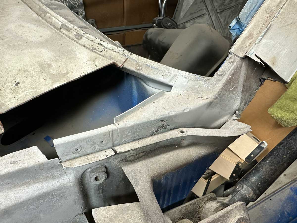

Here's a pic of up under the passenger side cowl, you can see the triangular bit that is the bottom of the a pillar reinforcement, outlined below in red.

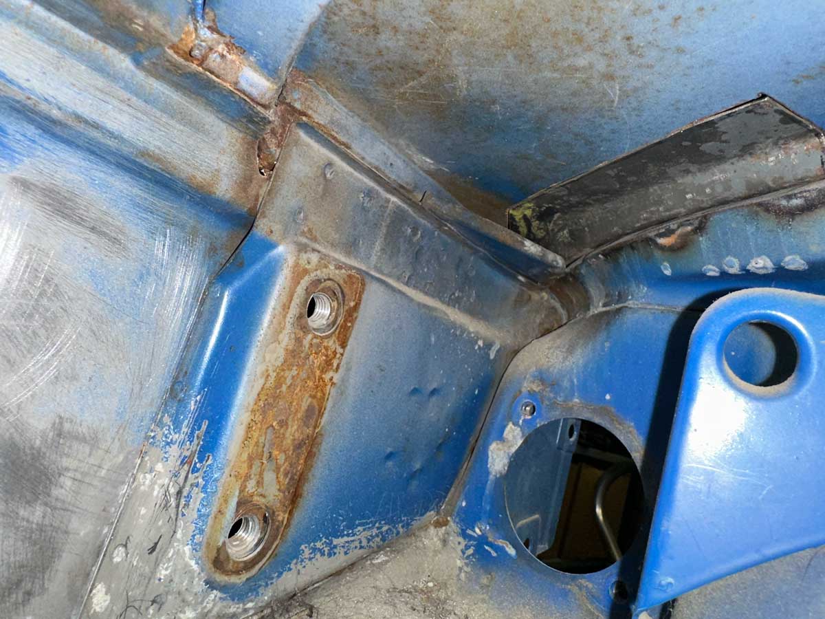

Here's my 70 that doesn't have it

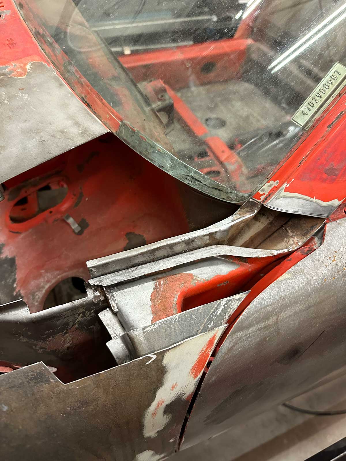

Here's a pic of it revealed, my 72.

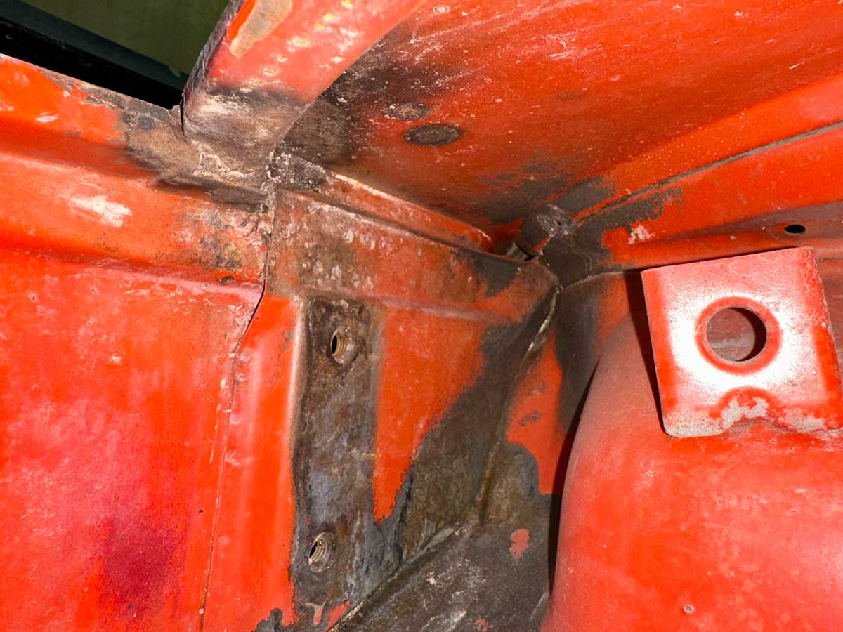

and a pic of the same on my 70 that doesn't have the center reinforcement.

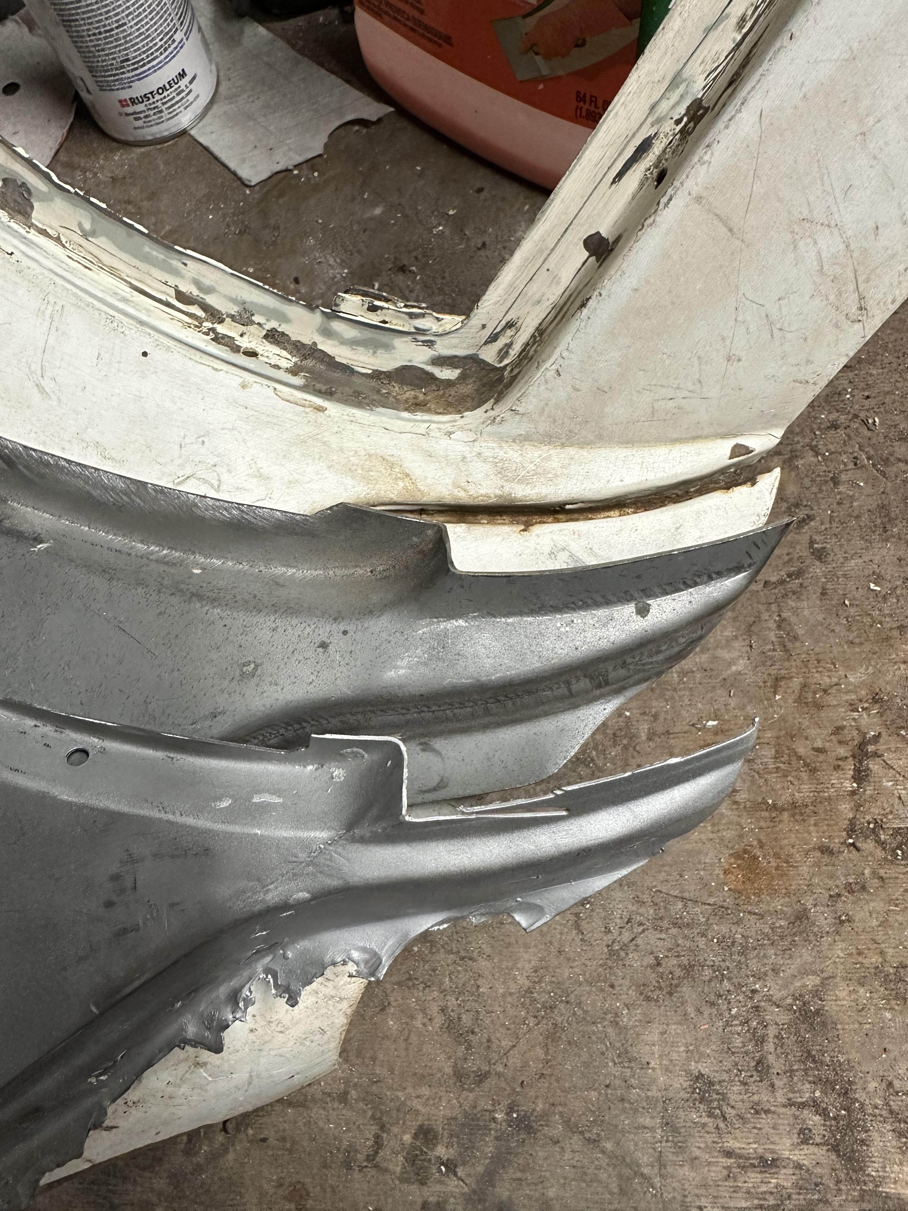

Looking at the shape of the cowl panel fender junction on my 70, the non reinforced a pillar cowl has a thinner shape, less triangular/more linear. Here a 72 cowl (white) with a restoration design replacement panel below, and my 70 panel below that. It's like the curve is moved back about a quarter inch which makes the part just below the a pillar very thin/linear. I assume that the cars with the a pillar reinforcement have the thicker cowl "ends".
I went on bring a trailer and brought up every 70 and every 71 car and looked for the best pic if any of the cowl panel/fender junction, and it looks like the 71 cars have the triangular/thicker late shaped cowl. It's hard to tell for certain on a lot of them, but I'd say it's 70 model year that it changed. I think the late 70 my cars might have the late panel though. It looks like around vin 29010000 to 29013000 it went back and forth, but it's hard to say for certain as the pics are not the best of that area a lot of the time.
