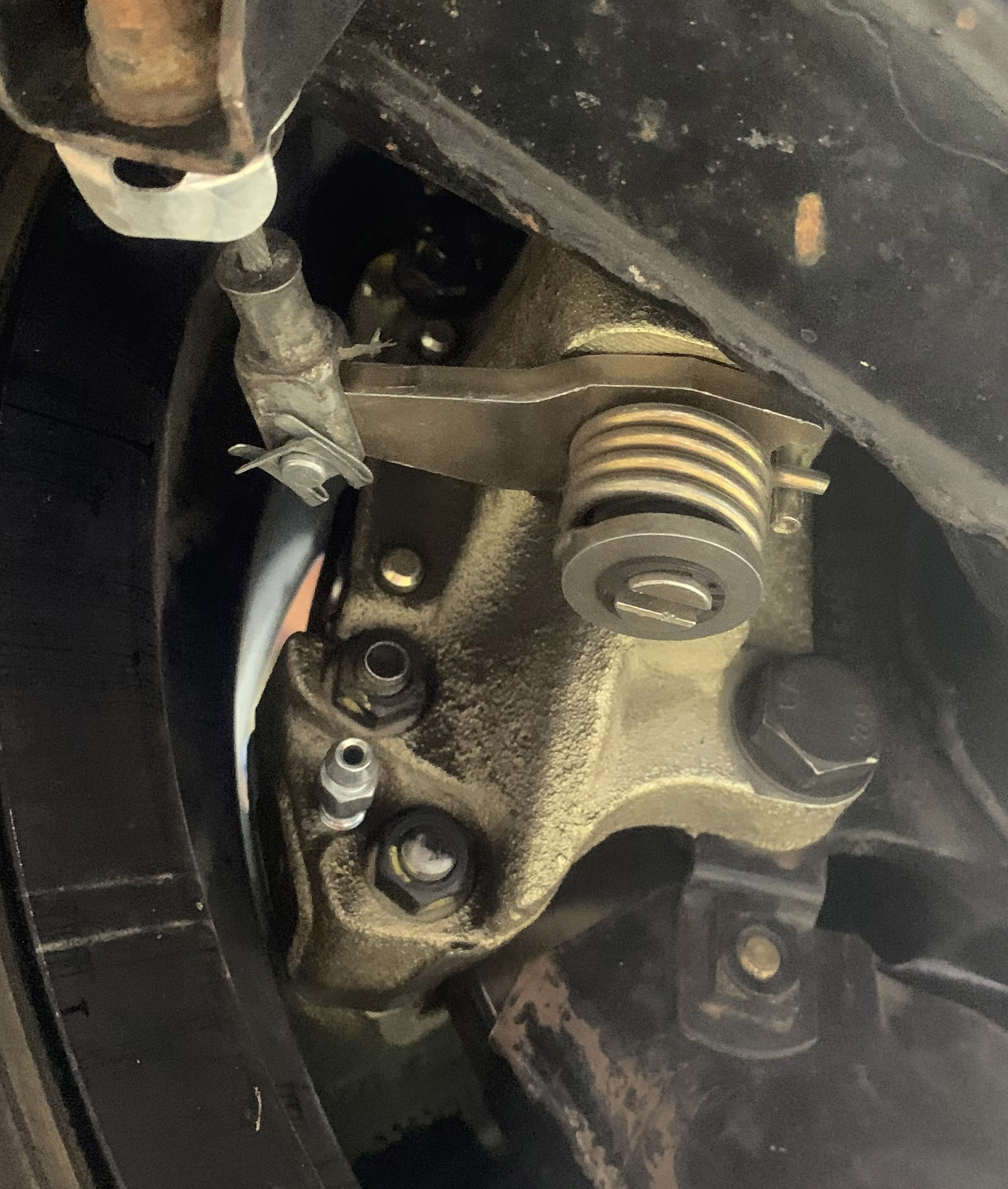

Eric put those on Mark Sonners car in rear with the 15 inch 7r copies or deep 7s - Vented rotors on the copy of 914-6 caliper.
I asked mark to try to get a picture of the rear set up today. Great photo ( A California Utah- We Bad)
Best Bob B
burton73
Here is a picture Mark just sent. Its not that clear of a photo.
Best Bob
