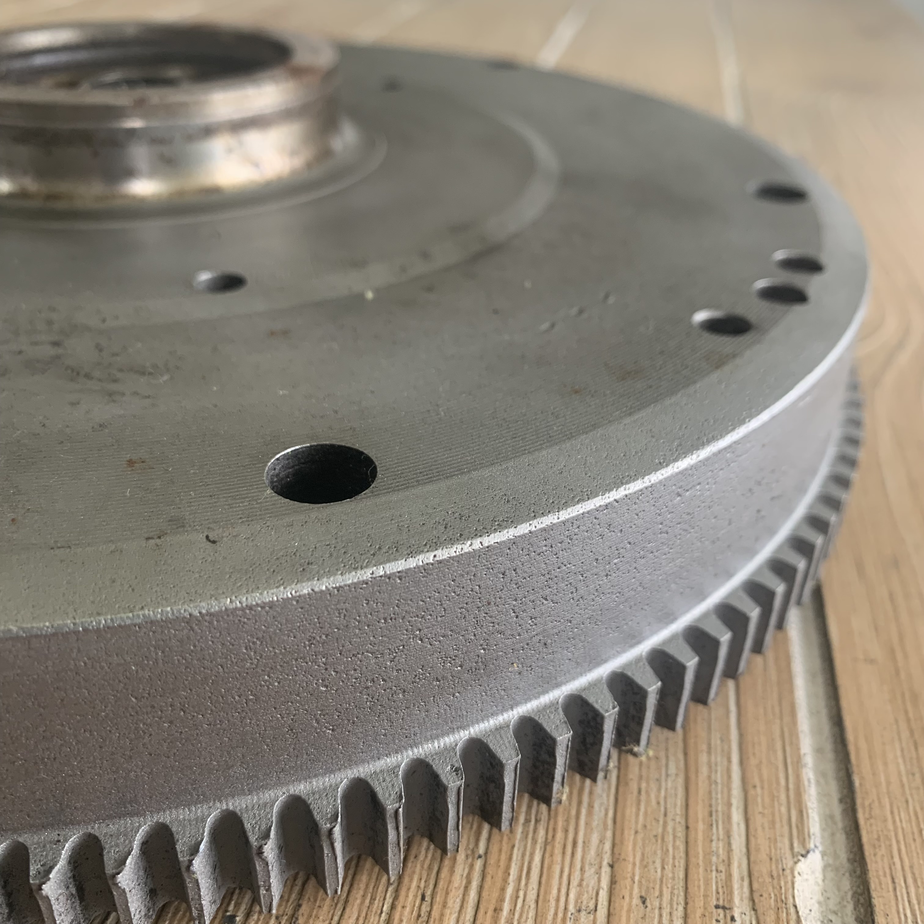

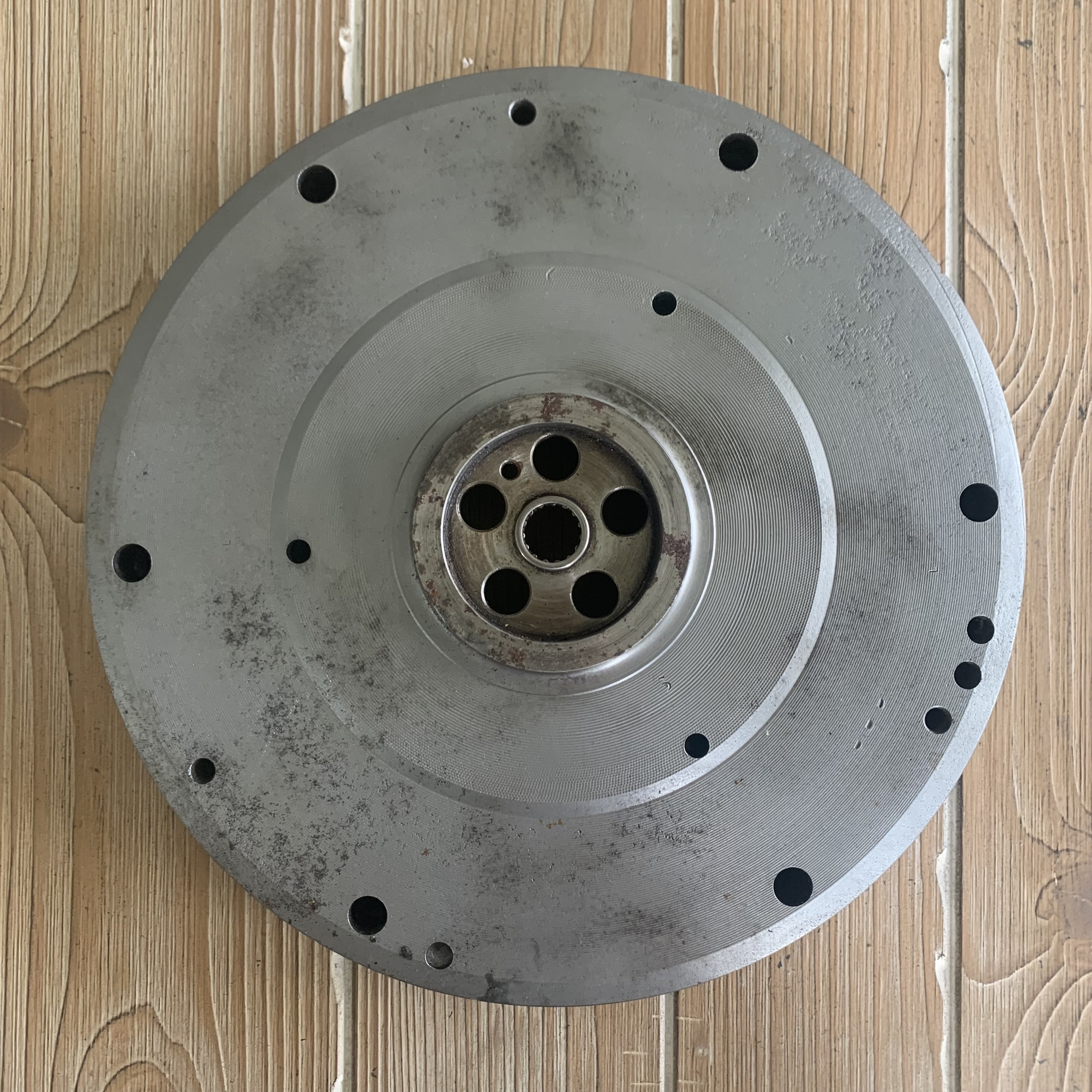

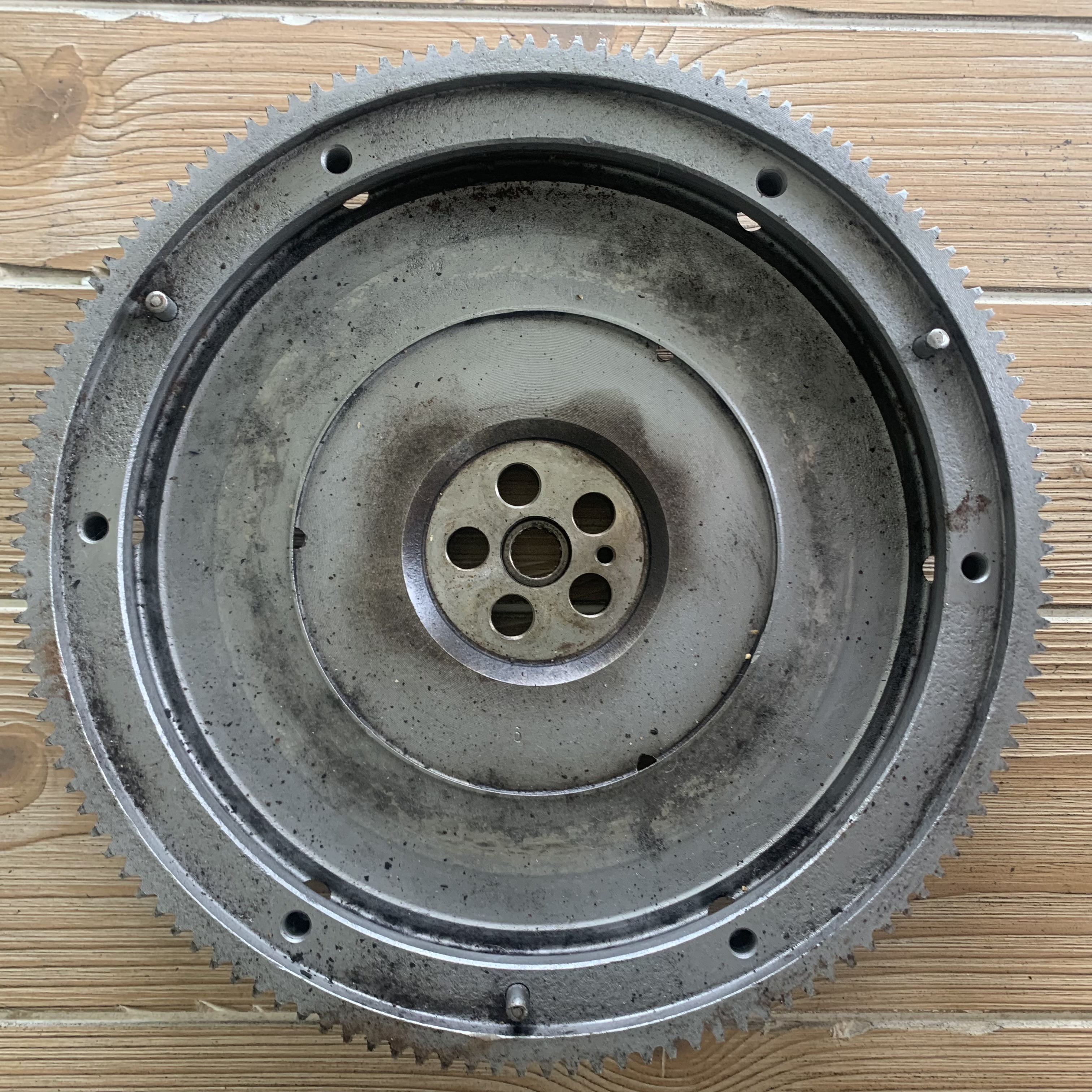

This flywheel came in a box of loose parts I acquired. I don’t need it. I will offer it up in the Classifieds. What is a fair price?

If the rear seal area is corroded the seal will probably leak. need better photo
Also lots of wear on gear teeth.

Sorry, looks toast to me too...
Probably not worth the shipping cost.
Does anyone make micro-sleeves for the seal surface?
That looks like it will need one...
I believe the flywheels are indexed; this will make the worn-out teeth be at the worst possible spot.
If the flywheel is not indexed, you can install it not in the original spot and the worn-out teeth will be far less problematic.

Thanks for the input. Sounds like a dropoff at the scrap yard is in my future.

I agree with scrap
I’ve give 3 away for free to locals so as to avoid shipping
They all looked better than that one

agree.gif but that one is toast sad.gif .
