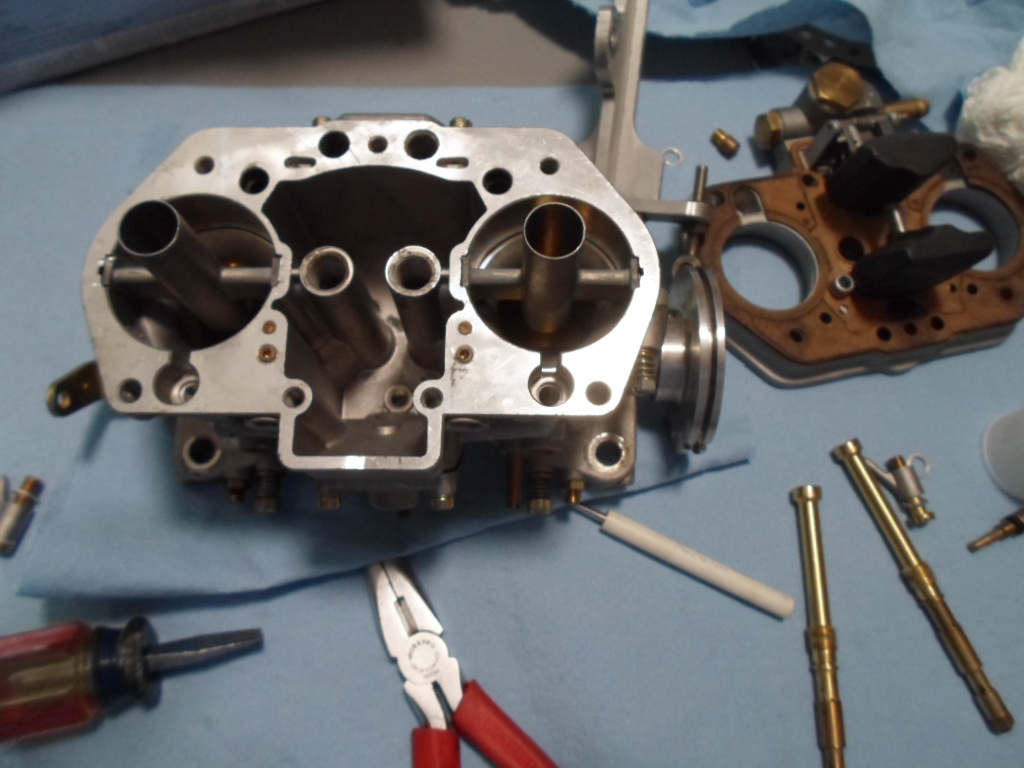

Jun 10 2024, 06:03 PM

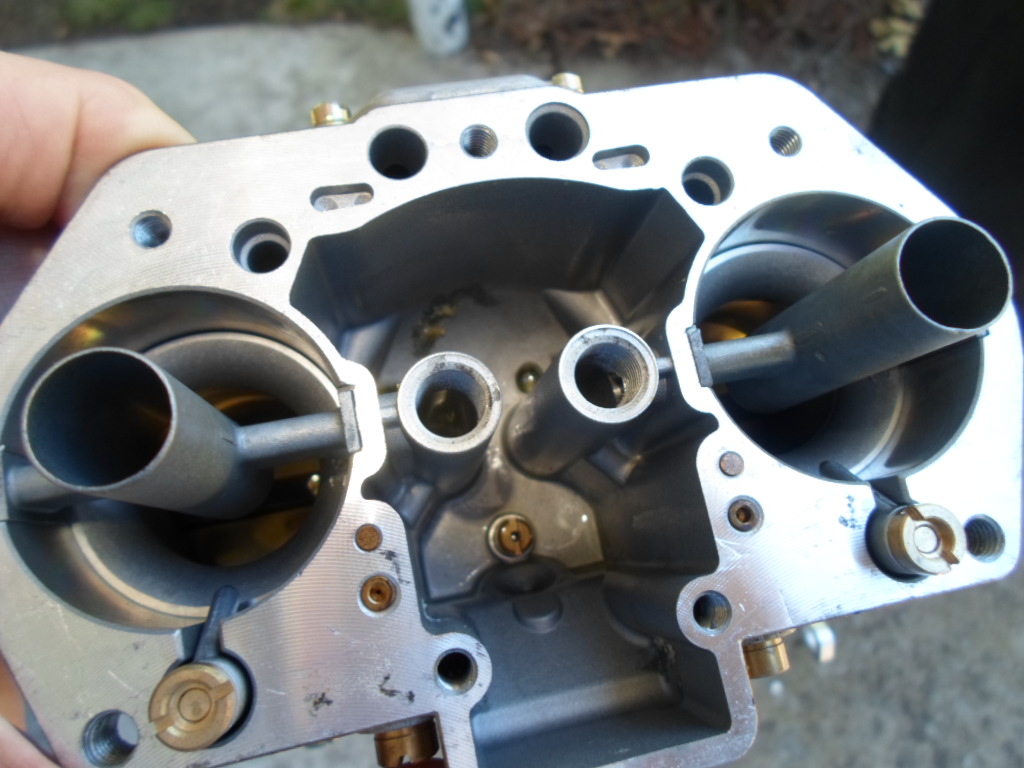

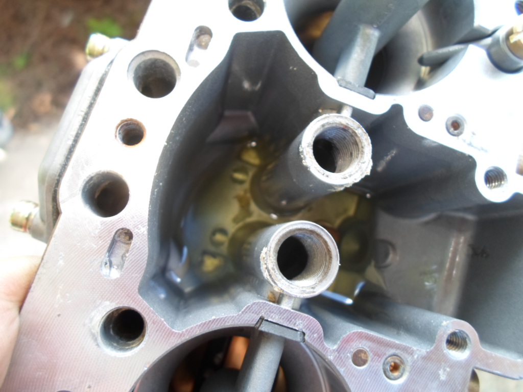

So last time I posted, I had a suspicion that my fuel pump or filter were not working correctly, as my pressure was dropping and the car was bogging down. I SHOULD HAVE stuck to my gut and started troubleshooting the pump first. That said, I wanted to maintenance the inside of these carbs because I had never opened them.
I took them both off today, dissembled most of the important parts, cleaned out the all the jets and circuits as best as possible and added new gaskets. I did find some junk in both bowls and I've tried to include some pics. Also, I have never adjusted the floats, so I adjusted them "closed" at roughly 12mm and "open" at between 23 & 25. The floats themselves looked great, but they were probably at around 6-8mm at the closed setting. Not sure how much difference that makes or if anybody has different numbers to shoot for?
Anyways, put it all back together and car won't start at all now. I didn't have time to troubleshoot much after that, but it doesn't look like it's getting much, if any fuel....leading me back to my original suspicion. That said, I feel better about the carbs having been cleaned and floats adjusted.
In the next day or so I'll check the flow to the "t" and get some voltage measurements to the pump. I do hear the pump kick on, but it doesn't sound as loud as normal.
Click to view attachmentClick to view attachmentClick to view attachmentClick to view attachment
technicalninja
Jun 10 2024, 08:46 PM
You did have some nastiness.
Looks like a goober in the top of the chamber in the first picture.
Some crustiness on the main well tubes in another.
I'd have put a few ounces of fuel in the bowls to test/flush out the accelerator pump circuits.
The carb bodies look NICE, however.
They needed to be "poor boy" rebuilt now.

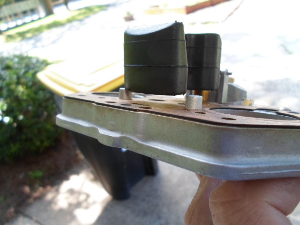

Is the picture of the floats with your new adjustment?
Something I've noticed over the years is when the floats are right the parallel lines/surfaces are also parallel to the top plate. This is on almost everything, not just Webers.
It looks like the outer float is a little bit bent downwards (high level) but picture angle may be playing a part.
If "12" is pictured, then 6-8 would have been a significantly higher fuel level in the bowl.
Tuning/jets might change
Did it run rich?
Too high a fuel level in the bowl tends to make things rich.
Get an 8oz container with a squirt top and dump 2 oz of fuel into each carb through the bowl vent. It should run then.
I'd run a bunch of fuel through the pump/lines looking for trash in it.
Jack Standz
Jun 10 2024, 11:09 PM
Just set the float level on IDF carbs. 12mm was too much and caused the fuel to leak out the carb top/vent. 10mm seems to be the "goldilocks" amount, just right.
So, suggest you check the floats for straightness/twist... Should be even/level for both front to back and side to side. If not, the float might catch on the inside of the carb or not "float" at the correct level.

Thanks everyone for the additional input. The floats in the picture are pre-adjustment. They are more horizontal now, and they are pretty much level and not bent. As soon as I get it running again, I'll re-evaluate the float settings.

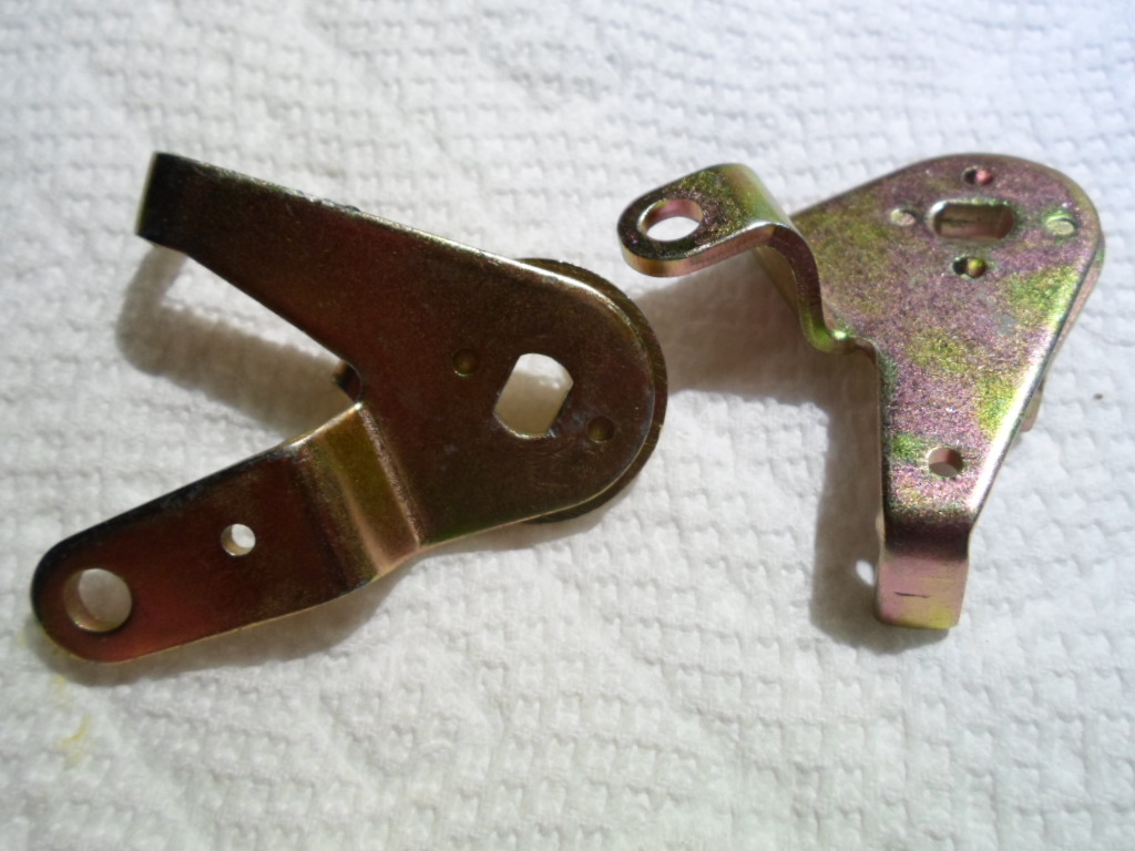

Aug 10 2024, 10:43 AM

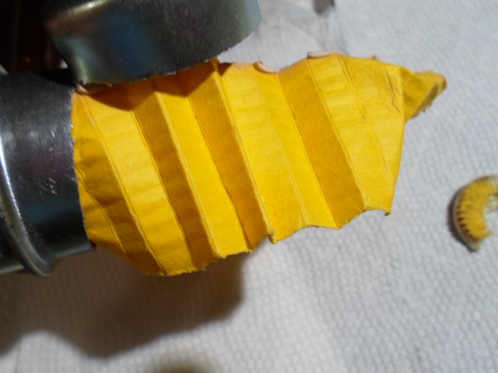

So I wanted to post an update on this just because it's so bizarre. So I haven't touched the car in about 2 months....busy with work. In addition to the carb issue, my turn signals weren't working so I bought an E26 flasher relay from Spoke. Since I figured that would be a quick fix, I installed it this morning and the turn signals are working again as expected.
Since I was already in the car, I figured I'd give it a start since it's been idle for a couple months. It cranked right up and was idling great. So, with little optimism, I figured I'd give it a spin for a few miles to see how bad it was going to run. To my surprise, it ran great, but I needed gas so I got a few gallons and went to pick up some groceries. Ran it for about 10 miles. (no bogging down, no backfiring, complete power was back)
I did have some very small issues, but it mostly ran great. I'm pretty sure the issues I did have were due to the linkage on the driver side carb which isn't returning 100% correctly....the hole in the throttle lever that the shaft goes through is wallowed out a bit and it's creating a situation where the lever isn't returning as well as it should( I have a pulley system linkage & that's why that's important). That said, overall the car is running great.
The only thing I changed was the E26 flasher. Additional information is that I changed out the fuel filter the last time I fiddled with the carbs, but still couldn't get it running correctly. My thought there is that, MAYBE, there was water/mositure in the old filter and possibly the pump???? After having replaced the filter and giving it 2 months to "dry out", the moisture issue corrected itself???? I'm basically grasping at straws because I can't figure out why all of a sudden, it's running flawlessly.
Well, for anyone that cares, that's where I'm at. Thanks again for the help!
Superhawk996
Aug 10 2024, 02:02 PM
There is no magic that accounts for the change in behavior.
Moisture doesn’t just disappear on its own - especially if it’s bound to ethanol. Water sinks to bottom of tank and can’t evaporate because it’s not exposed to atmosphere.
Like you said, your main fuel filter may have been partially blocked and changing that helped.
I know you cleaned carb jets but did you clean the inlet strainers that are in each carb? This can impair fuel flow. And of course there is the sock in the tank - make sure that isn’t blocked up. Over time, just sitting debris that was plugging these screens can settle, reopening them to flow until they have a lot of flow and the debris gets picked back up again re-blocking the filter screens.
Likewise, get that linkage issue sorted - you can buy new lever arms if a hole has become too elongated. Unsynchronized linkage will cause roughness.

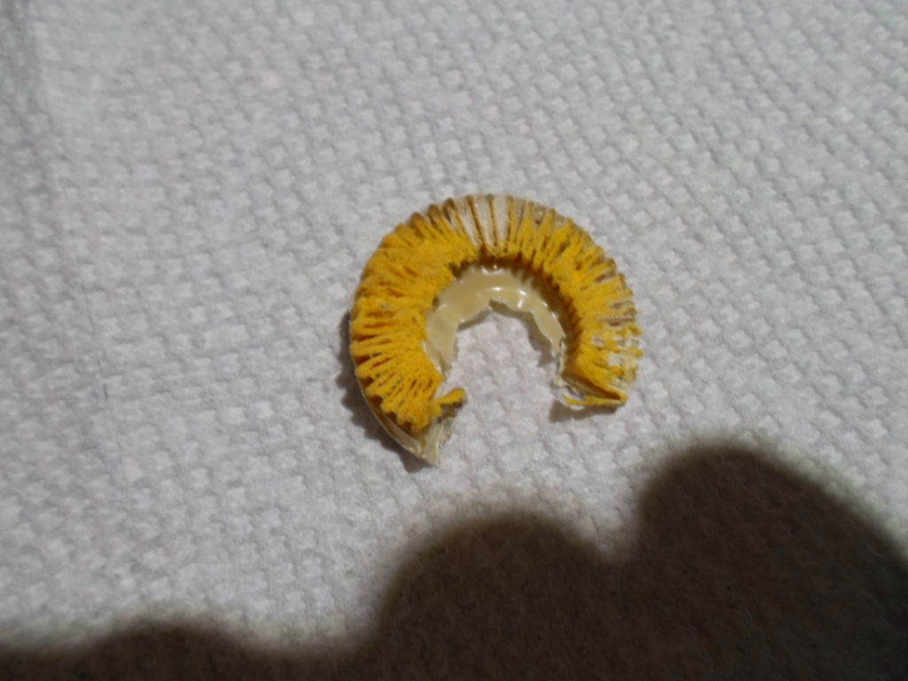

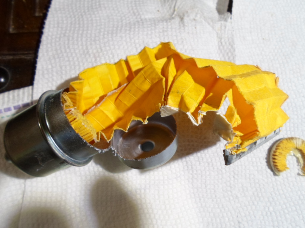

Thanks for the reply. I'm fairly sure it's not a flow issue from tank or pump(at least not any more). At one point in my troubleshooting I removed the main fuel supply line from the "t" and set it into an empty gallon container...then turned on the pump....it was flowing freely. Also the tank and sock have probably less than 100 miles on them. I did remove and clean the inlet strainers as well.
Another thing I did today was cut the old filter open with a sawzall. I have attached a couple pics of "the innards". I'm no expert on fuel filter autopsies, but, to me, it looked pretty clean.....as if "crud" coming from the tank wasn't the probable issue... which stands to reason as the tank is almost brand new.(although the cross section piece in pic #3 might be a little suspect??)
For now, I'm going to replace the worn throttle lever(not sure I'm using the right terminology, but I've attached a pic) and finish tuning the carbs again.....this time using very small increments on each adjustment.
Fuel Filter Autopsy Pics:
Click to view attachmentClick to view attachmentClick to view attachmentThrottle lever replacements parts:
Superhawk996
Aug 10 2024, 05:32 PM
I’m with ya’, that filter media looks fine. No obstruction there.
Agree - resync carefully. synchronized carbs make a big difference in smoothness.
