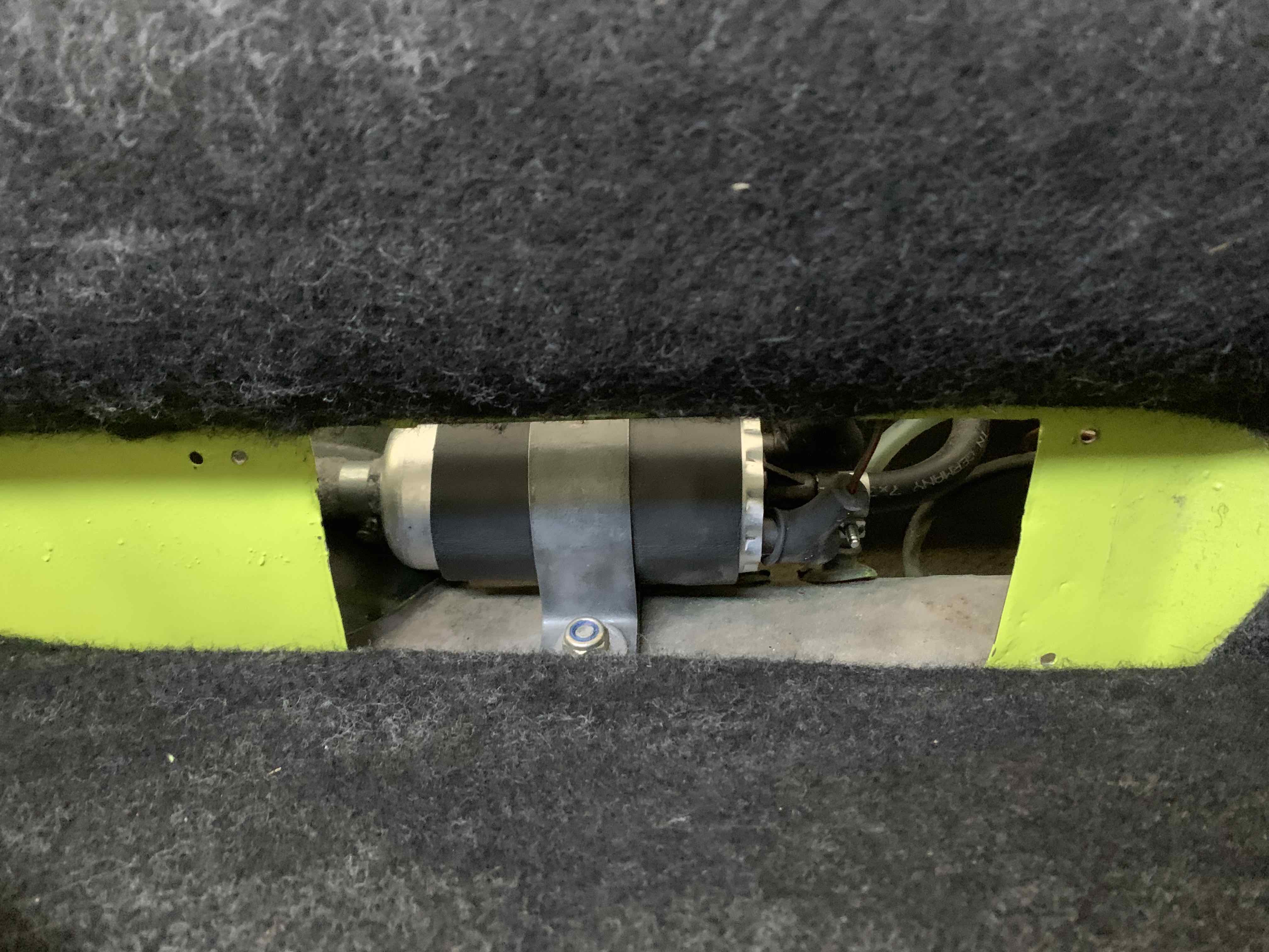

I have a '73 2.0. A PO moved the fuel pump up front and under the tank and cut out a door so that the fuel pump can be accessed from the frunk (like the '75 and '76).

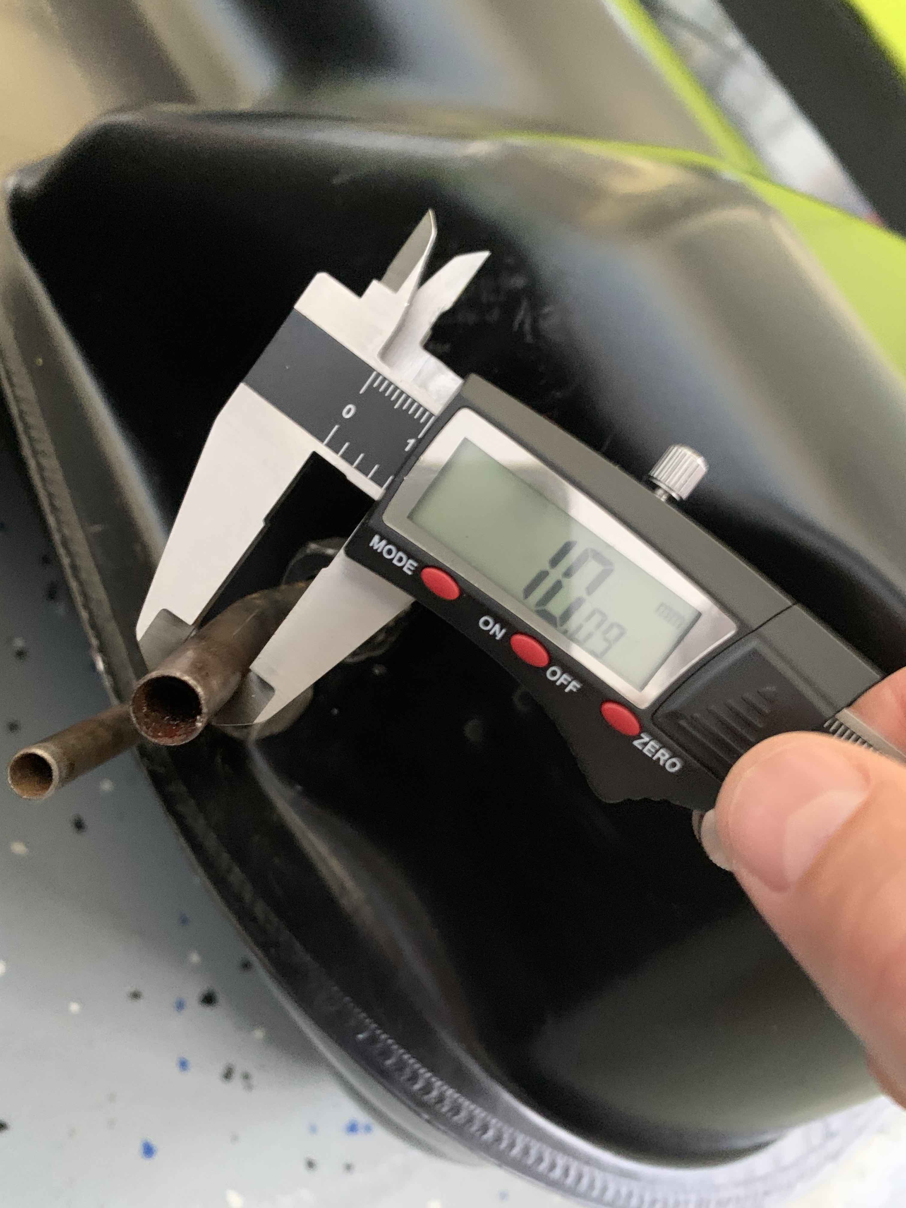

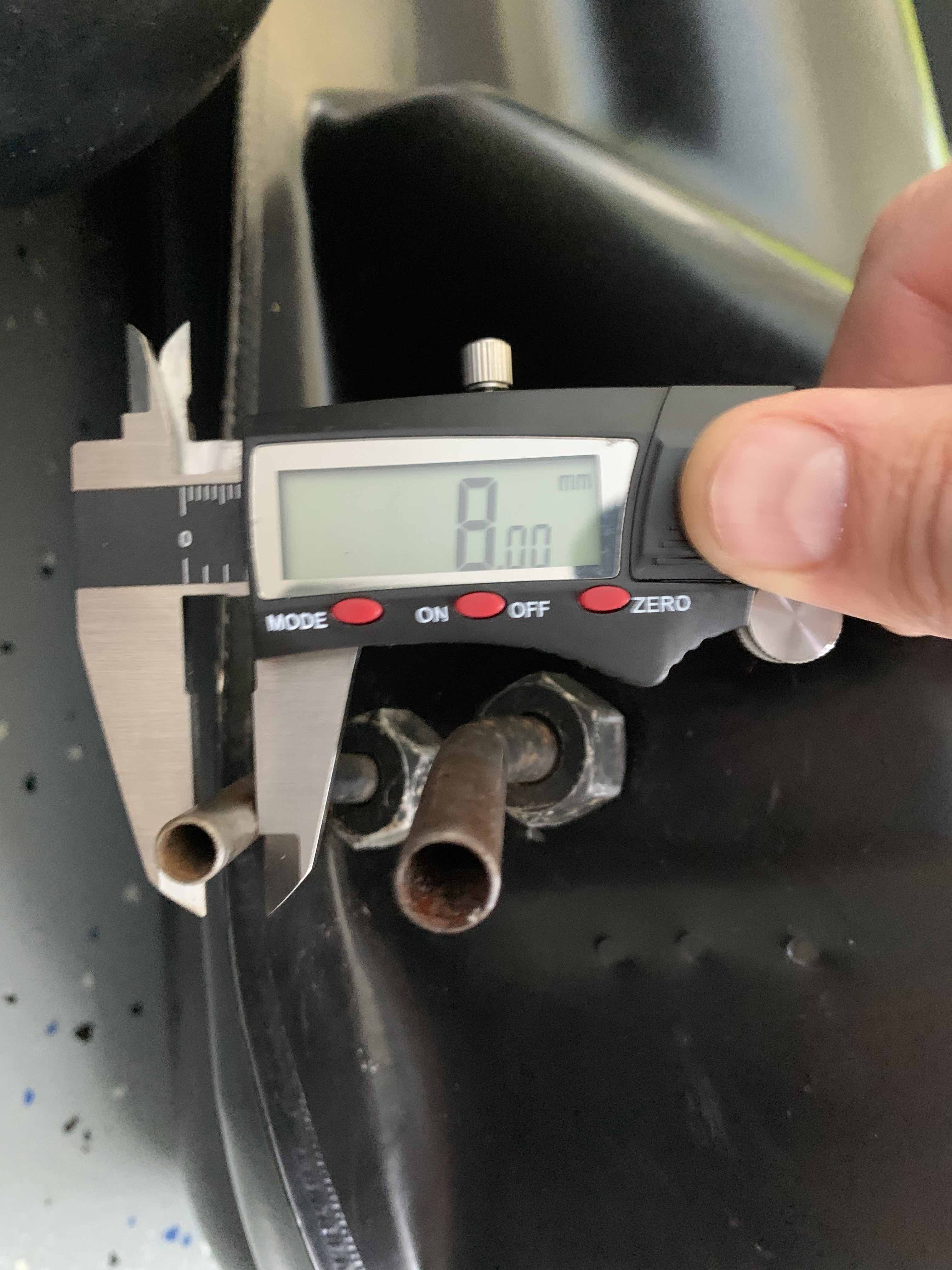

First question: regarding the send and return pipes on the bottom of the tank - the send line measures at 10 mm and the return at 8 mm, yet the list in the AA fuel line kit lists both lines as 7 mm. Is that correct? I didn't want to force it, but I cannot seem to get the 7 mm line in the kit over that 10 mm pipe.

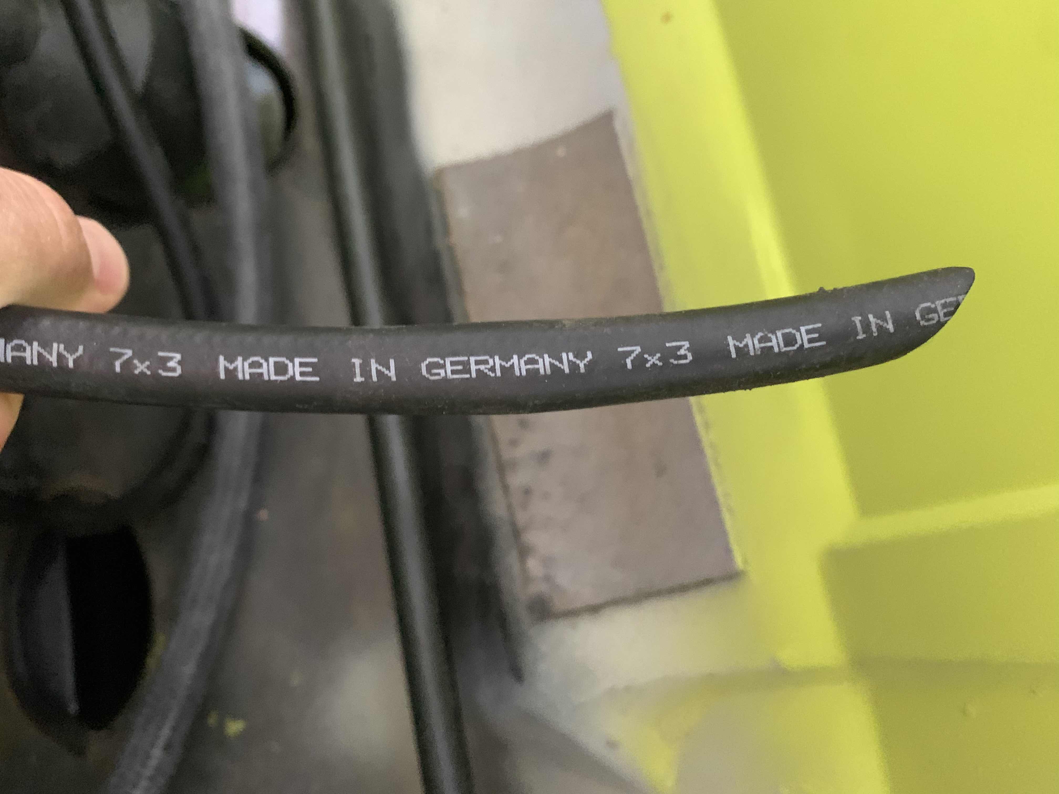

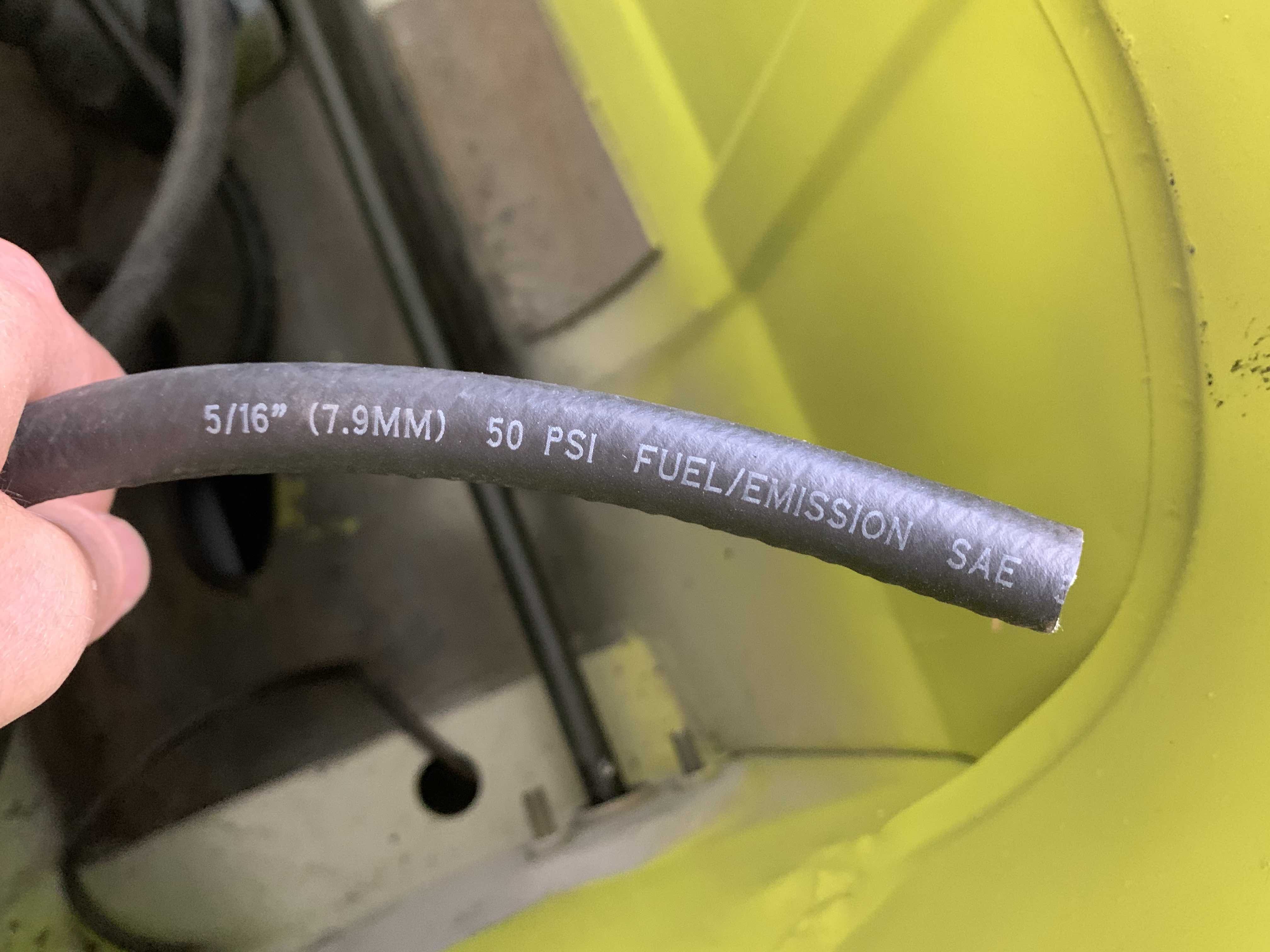

Here are pics of the pipes I'm speaking of as well as pics of what the lines were when I removed the old tank (a 5/16 AKA 7.9 mm USA made line on the send and a 7 x 3 made in Germany line on the return).

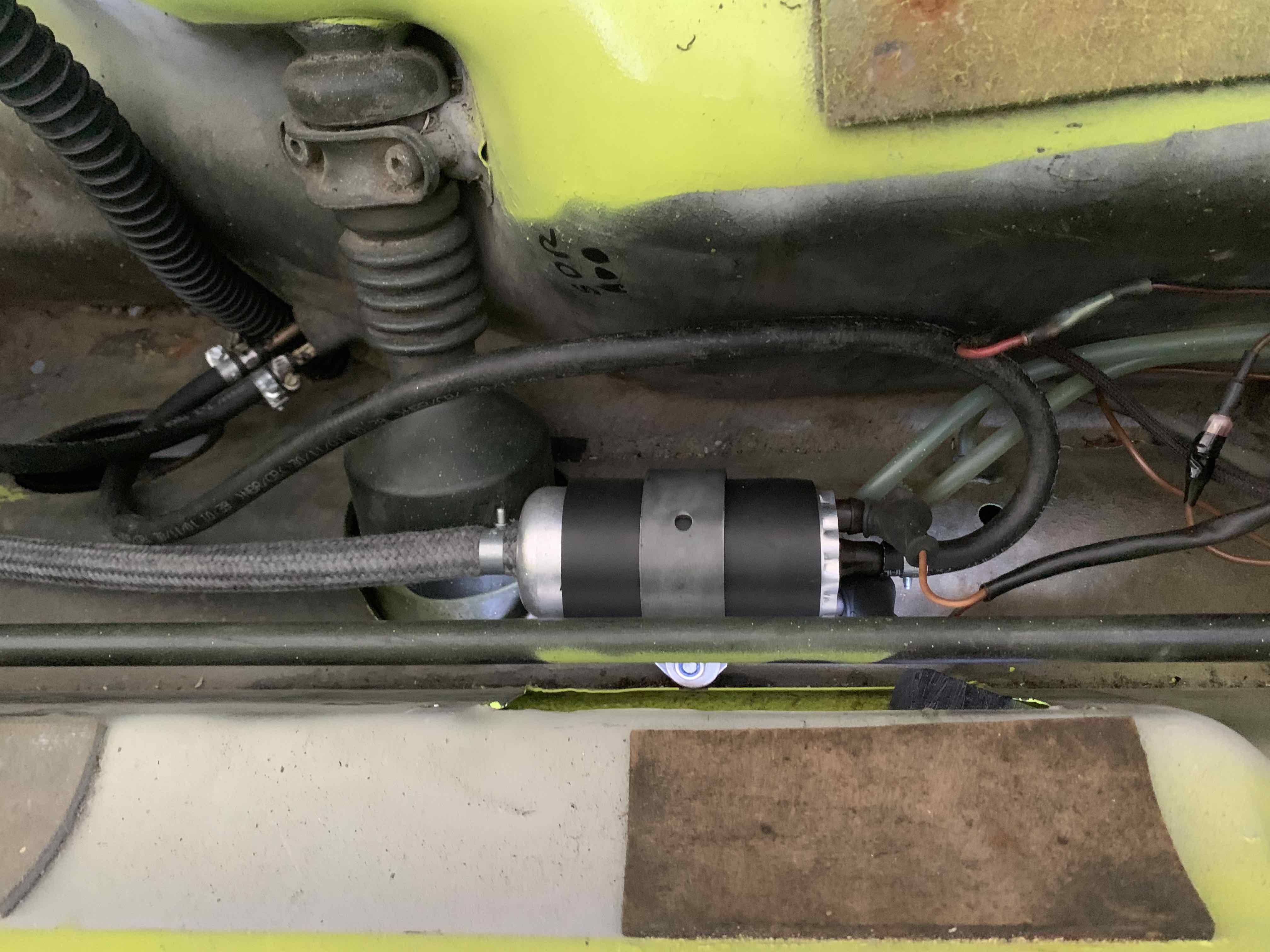

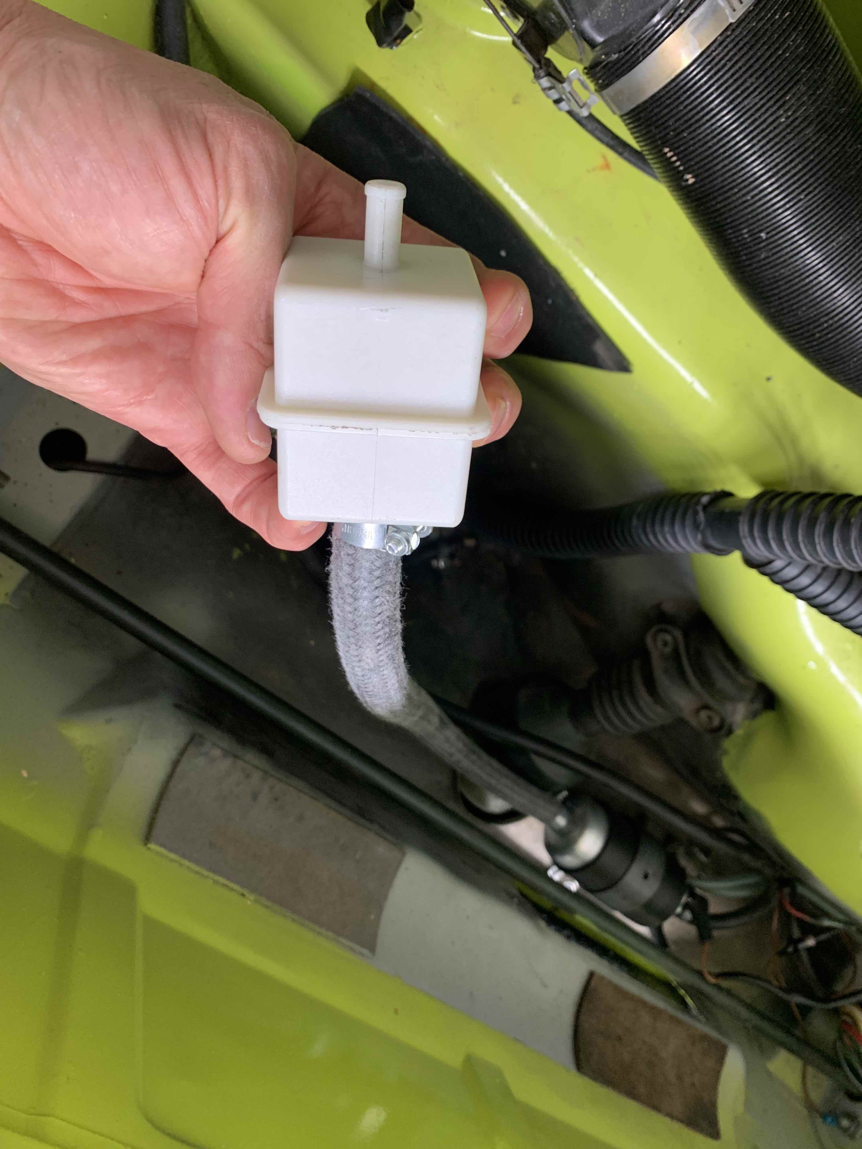

Here's the pump location:
bdstone914
Use rubber lines that fit your fittings.
7.5 and 9.5mm.
They have to mate to the lines in the tunnel.
DC_neun_vierzehn
QUOTE(bdstone914 @ Jun 9 2024, 09:45 AM) *
7.5 and 9.5mm.
Bruce, yes, the return line from the tank will mate with the line in the tunnel. Sounds like you're suggesting a 7.5 mm rubber line there (instead of the 7 x 3 rubber hose that was there originally). Ok.
However, the send line does not mate with the tunnel line - it goes to the square fuel filter (8 mm inlet). Sorry I did not mention that in my original post. Thus, trying to figure out what line to use that goes from the 10mm tank pipe to the 8mm filter inlet.
As stated in original post the original rubber line there was a 5/16" (7.9 mm). I guess was the PO's solution - it appears to have worked since it's in between the two sizes it mates to on each end. Should I just try to find a new 7.9 mm hose?

Were the pipes on the bottom of tanks various sizes depending up on the year?
Trying to figure out why Auto Atlanta's kit has 7mm lines for both pipes (when one pipe is 8mm and the other is 10mm).
Chris914n6
I've got a 75 with the front mount pump stock. Both tank nipples are 8mm. The pressure side goes to the filter then the pump, so the 3/8" hose fits in between. There is a filter hanger on the firewall (pedal side) across from the pump. In that pic you have the pump facing backwards from stock.
DC_neun_vierzehn
QUOTE(Chris914n6 @ Jun 9 2024, 11:47 AM) *
Interesting. I sounds like the 75 and 76 had 8mm pipes on bottom of tank then. Hence why AA’s kit calls for a 7mm line on both.
The old pump that I removed was positioned the way you mentioned but it seemed fit better this way (less stress on the wiring and lines). I assuming that as long as I have the right lines going into each end of the pump it should not matter). But if I’m overlooking something someone please let me know.
Geezer914
Are you running carbs of FI? For FI, Gates barricade 30R 7.9 mm., 50 psi, for ethenol fuel.

QUOTE(Geezer914 @ Jun 9 2024, 03:10 PM) *
Thanks for asking. That’s obviously important. I’m running stock FI.
rjames
Do early tanks have two different size lines coming off of the tank?
The send/return lines on my '75 tank are the same 8mm (OD).
I would replace the 10mm fitting on your tank with an 8mm one.

DC_neun_vierzehn
QUOTE(rjames @ Jun 10 2024, 11:11 AM) *
What Chris9146 said is how it should be set up. On my fuel filter there is an arrow indicating fuel flow direction. If yours doesn't have that, then it probably doesn't matter which way you connect it.
I would also recommend Gates 3014 T2 fuel line. It's rated for ethanol and 225PSI, so safe for FI. Pricey, but better safe than sorry. I was able to buy it from my local NAPA store.
Why - what is the benefit of converting the original 10mm send pipe on my tank to an 8mm other than more hose options?
Because I believe I already have that figured out - use a 9mm hose from the 10mm tank pipe to a Tangerine Racing reducer/adapter (9.5mm to 8mm) then a 7mm hose to the 8mm inlet on the filter.
From what I can tell that should work. Hoses should be .5mm to 1mm smaller than the fitting.

Literati914
QUOTE(DC_neun_vierzehn @ Jun 9 2024, 08:48 AM) *
.. (like the '75 and '76).
This is because the 75-76 cars had both pipes as 8mm, and correspond with filter pn133.133.511 (8mm in, 12mm out).
Assuming that's the filter you have - your best bet is to change the big pipe to an 8mm pipe (which maybe should have been included in the kit) ..
(edited^^ after further considerations)
