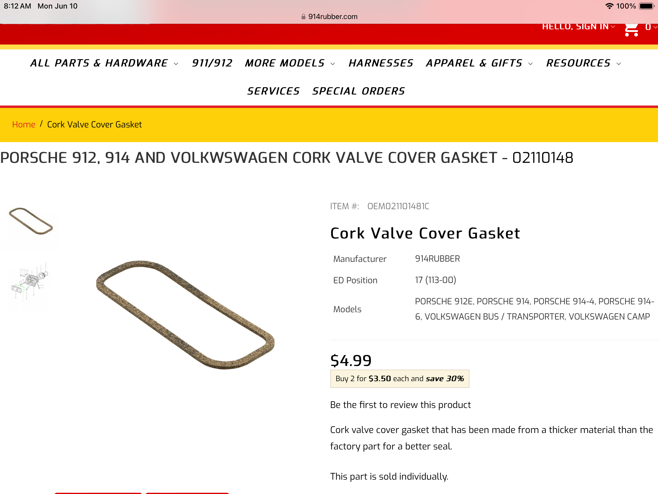

Garland
Give these a try, working for me. There a bit thicker. Installed clean, and dry, no sealers.
914Rubber.com
Boothy
Will do! Thank you!

If you've read all the threads, you may have already come across Gask-A-Cinch. The VW logo goes UPSIDE DOWN when the cover is installed correctly. i use Gask-a-cinch between
the gasket and valve cover. dry between the gasket and head.
Some use Gask-a-cinch on the cover side and some grease (like swepco 101) on the head side.
This keeps the gasket in place and after the bale is snapped in place you can slide the cover around a little and make sure it is seated well.
I have tried the thicker gaskets but they were too thick for me. Couldn't get the bale back in place. You may want to make sure your bale is exerting enough force - maybe a little massaging of it will clamp things down a bit harder.
