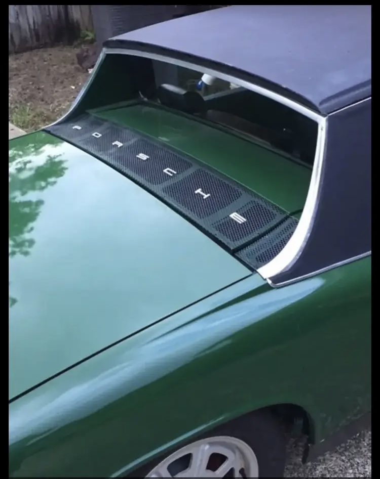

Question #1 is probably an easy one. The vinyl sail came off during transport years ago. I still have it. I guess I need to glue it on. Do I need to take the trim off all around it? Even the trim near the door because that has a rubber seal over the top of it.

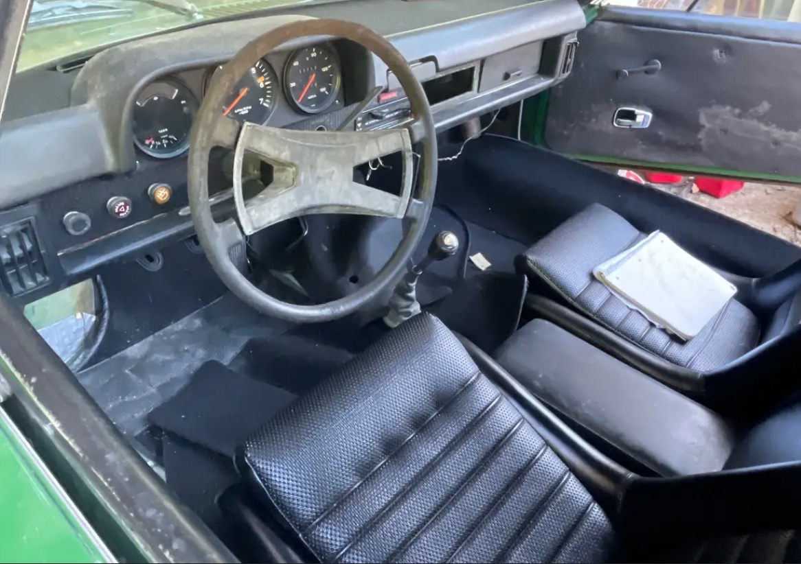

Thanks. Here's a couple of pictures. It's a '75 with the original 1.8. It has a leaky Weber Progressive which I'll probably fix just to get it around the neighborhood unless I can buy a working one for a decent price. The carpets aren't glued down and the trunk, frunk and door jams weren't resprayed so I'll try my hand at repainting them. I have a replacement steering wheel that I'll put on to give me more leg room.

Welcome back and great looking car. Yes, to get the sail-panel vinyl back on the trim needs to come off. There are a bunch of threads with DIY videos to help with this project. Really it is all about getting the surface nice and clean before you put down the new vinyl. Take your time and measure and fit with some take on the paint with reference marks for locating the vinyl exactly where you want it. beerchug.gif
76-914
Per your question, yes you need to remove some trim pieces before replacing the vinyl. When you remove the CP bar that spans side to side you will find a few clips that hold it in place. Inadvertently, one of them shoots off into a black hole but IIRC 914rubber sells them. More importantly, those two thin CP trim strips at the bottom are "dead soft" aluminum and bend extremely easily. There are 4 clips that hold each piece in place. DO NOT try to pry these pieces away from the body or you will bend the piece. If you remove the tire you can reach up into the wheel well and push those clips through easily thus removing those small pieces. The long swept vertical piece is held in place with an 8mm nut which is also accessed from the wheel well. Eric Shea has a tutorial on his website. There are 2 more small trim pieces on the top part that are remove as well as the trim pieces that hold the vertical rubber window seal.

Wow...more involved than I suspected. Thanks for the info and tips.
JamesM
QUOTE(76-914 @ Jun 11 2024, 10:56 AM) *
An 8mm nut in a recess that has been exposed to wheel well grime for 50+ years. You may not see it at first and need to go digging a bit. If you are able to get it off cleanly you should feel lucky. In many cases the nut will round off, break the stud, or seize and spin the backing plate that holds the trim down. Of the 3 options breaking off the stud is probably the best case scenario.
