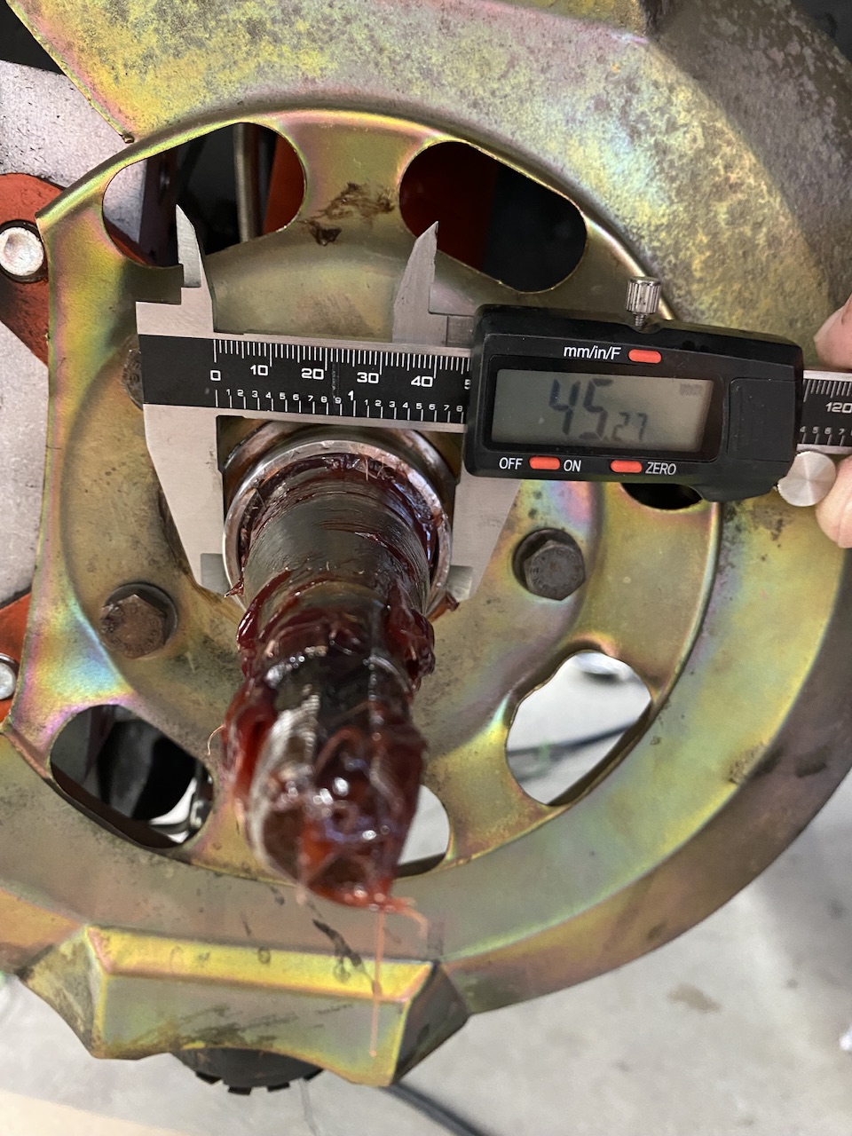

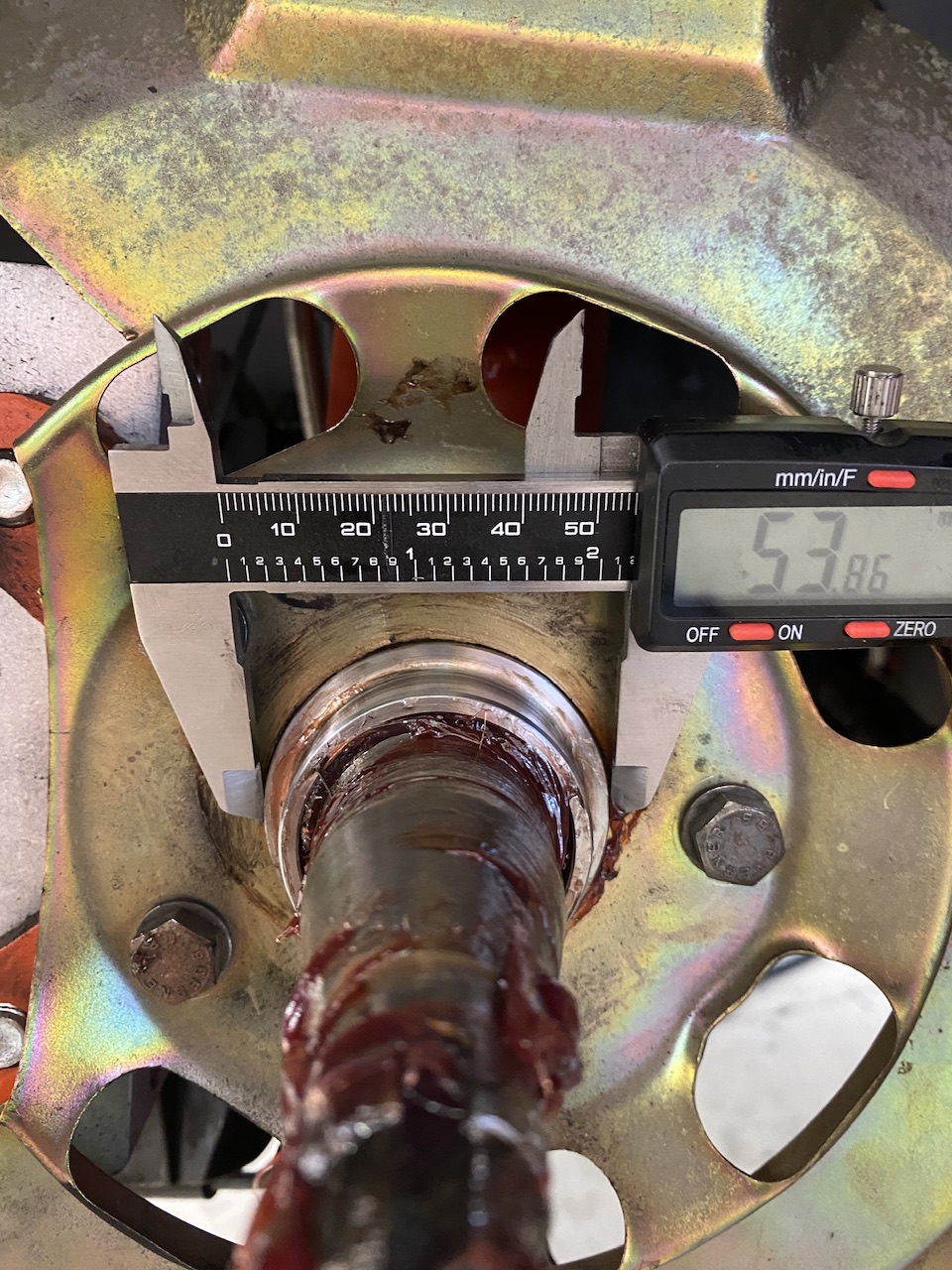

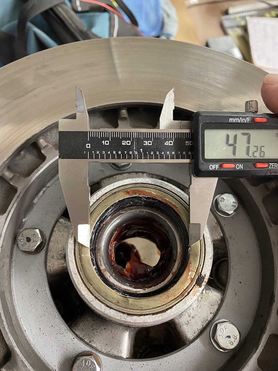

914 six almost ready to go after getting it tuned on a dyno today. More about that later.
- trying to chase down the source of the shaking front end.
- Vetted out wheels, tires, tie rods, shocks, bushings, rotor warpage, etc…. All good
-Please see pics.
It seems as if there’s a mismatch between the inner bearing and the spacer. Somethings not right but I don’t know what it is.
The last true leftover problem from the previous owner.
24 mm carrera rotors, Porsche Brenbo brakes, 911 hubs,
new bearings and seals.
Any clue at to what’s wrong?
Click to view attachment Click to view attachment Click to view attachment

Everything you measured has nothing to do with the surface the bearings ride on. What you are measuring is where the hub seal rides.
You may want to measure the spindle OD vs the bearing race ID.

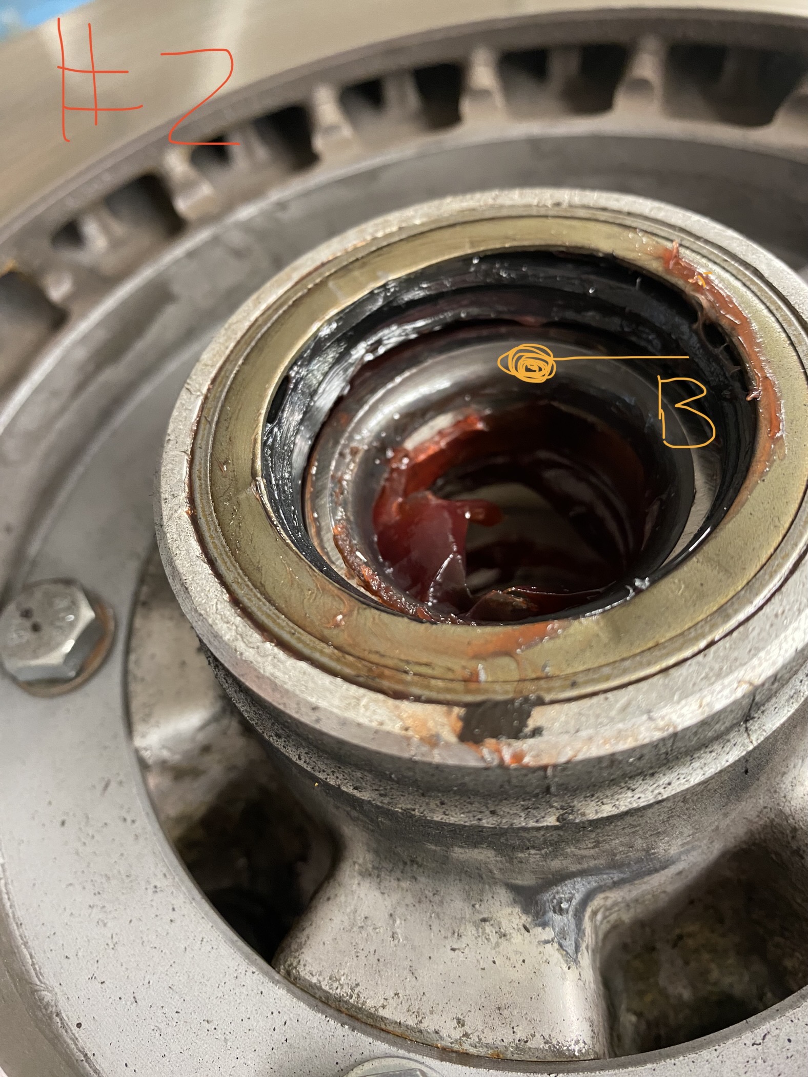

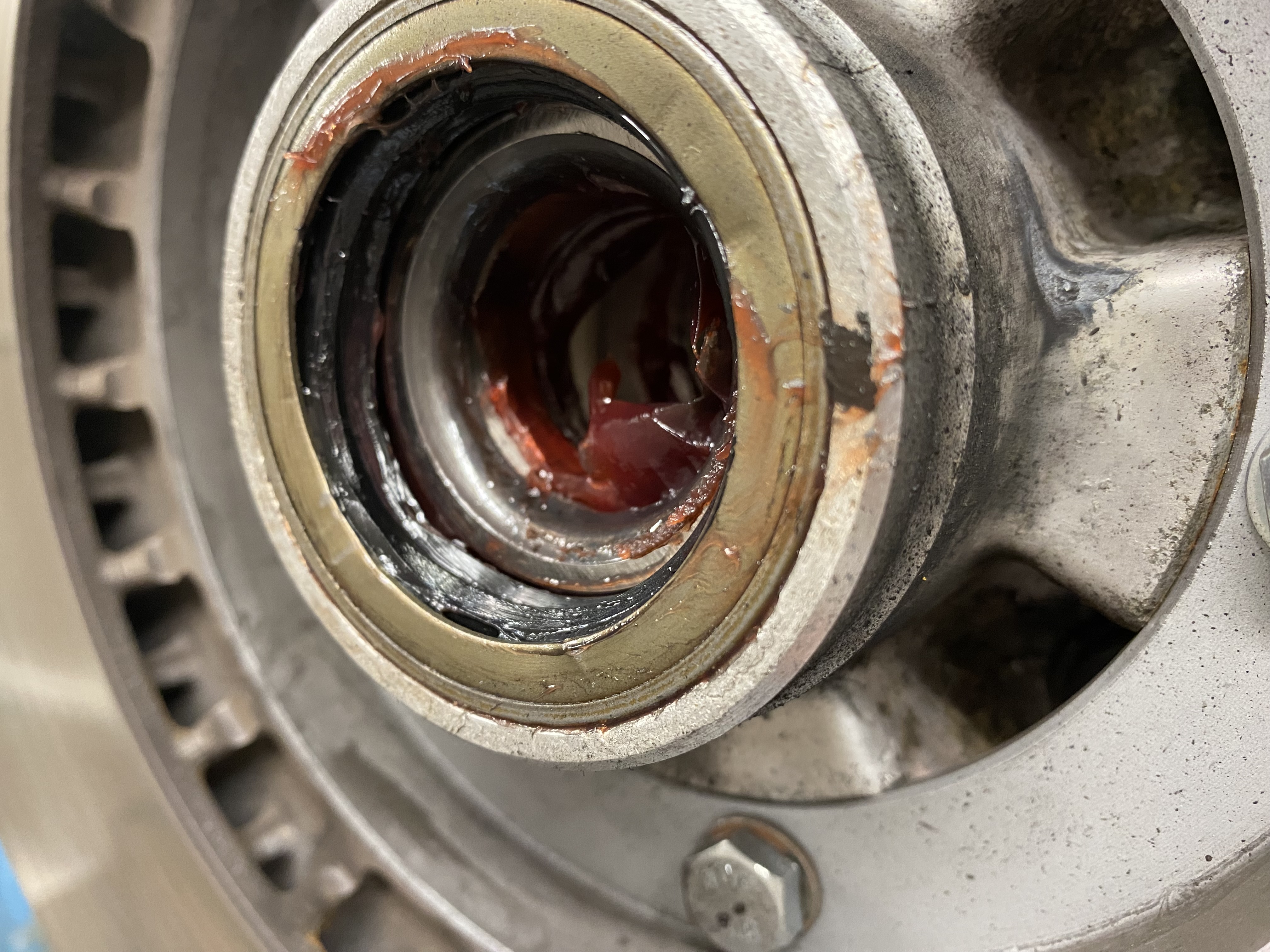

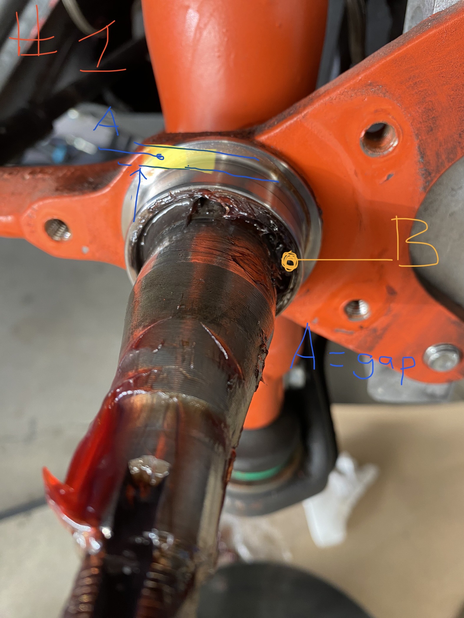

1. When I slide on the rotor hub assembly surface B on the spindle comes in contact with surface “B” on the inner bearing in the rotor.
2. Is it correct that when rotor is fully installed the rotor pushes on to the spindle spacer to the point that leaves a gap labeled “A” ? With the rotor fully on, I can see that yellow highlighted zone about three or 4 mm that has nothing in contact with it.
3 . Is the spindle supposed to come in contact with the inside of the bearing in the rotor?
Or is it designed that the spindle spacer outward edge contacts the back of the bearing?
4. Is the bearing supposed to come in contact with the base of the spindle spacer where the flange begins ?

The inner bearing inner race is supposed to contact at B to B. There should be a little space at A. The grease seal rides on the smooth flat cylindrical surface nearby. Nothing should contact the flange surface at A.

@chrisfoley Thanks so much Chris… so it looks like it’s all correct then
