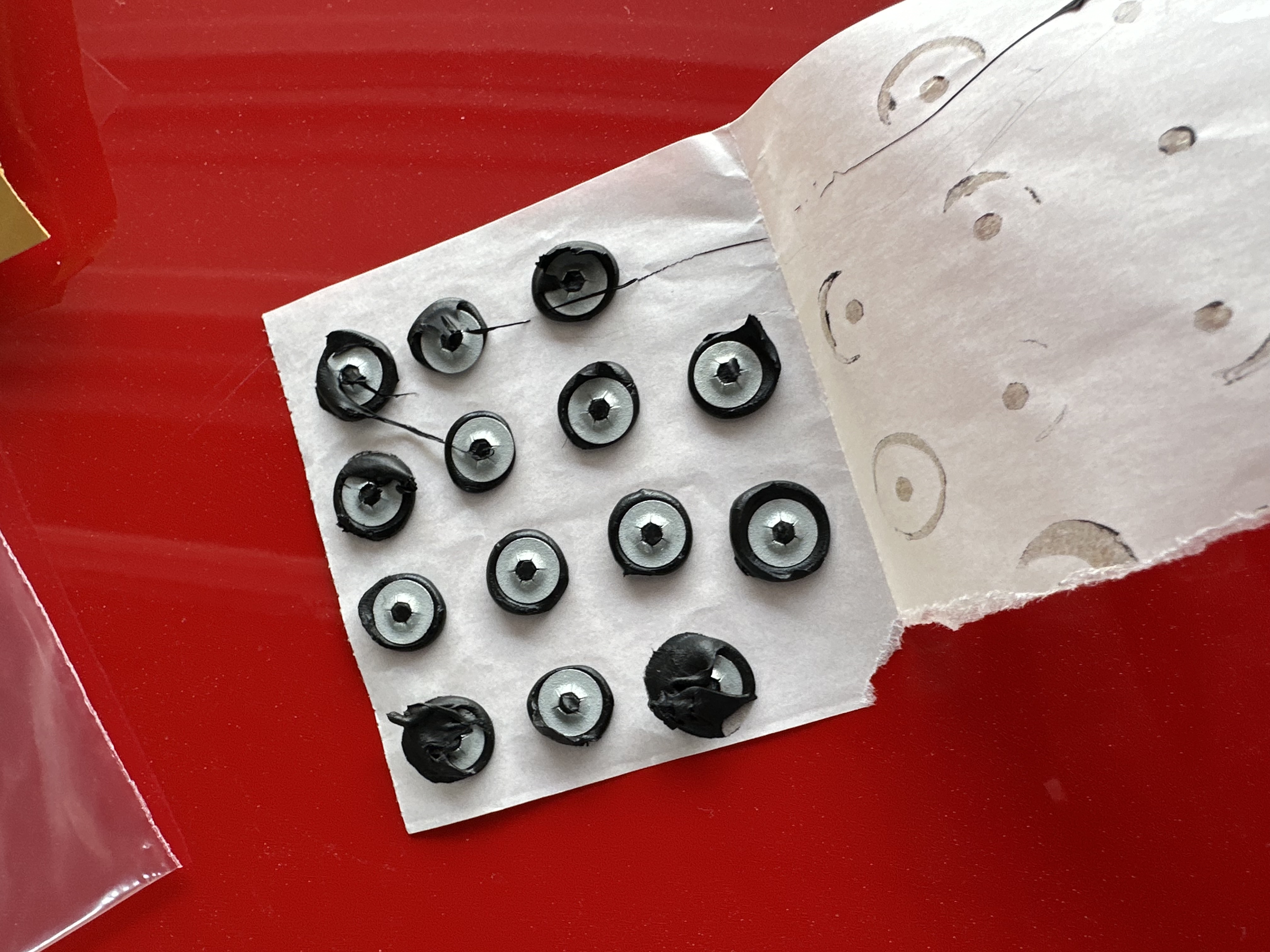

Good afternoon,
Ok. I spaced out my lettering for the engine lid and opened the emblem secure pins package from 914 Rubber and it has melted tar around them. Am I to assume that it is meant to be left on as it is a melted mess. All the other pics I have seen online do not show the tar.
Advice appreciated,
Brett
iankarr
Def not ideal that they're melted, but they should still work fine. The metal part is what grips onto the stalk. The melty part is a buffer between the metal ring and the screen of the trunk lid to keep the letters from rattlling. Just try to re-round the melted parts before smushing them down.

There must be a better way! Rubber? This is going to collect dirt and dust like crazy and turn brown.
JeffBowlsby
Those pushnuts are not the right kind for the pins through the engine grille mesh. The rubbery material is a gasket and is correct for pins through the chassis such as the tail panel, to keep water out of the trunk. The factory pushnuts for the grille mesh had the metal clip cast into a semi rigid plastic, see if you can find that type.

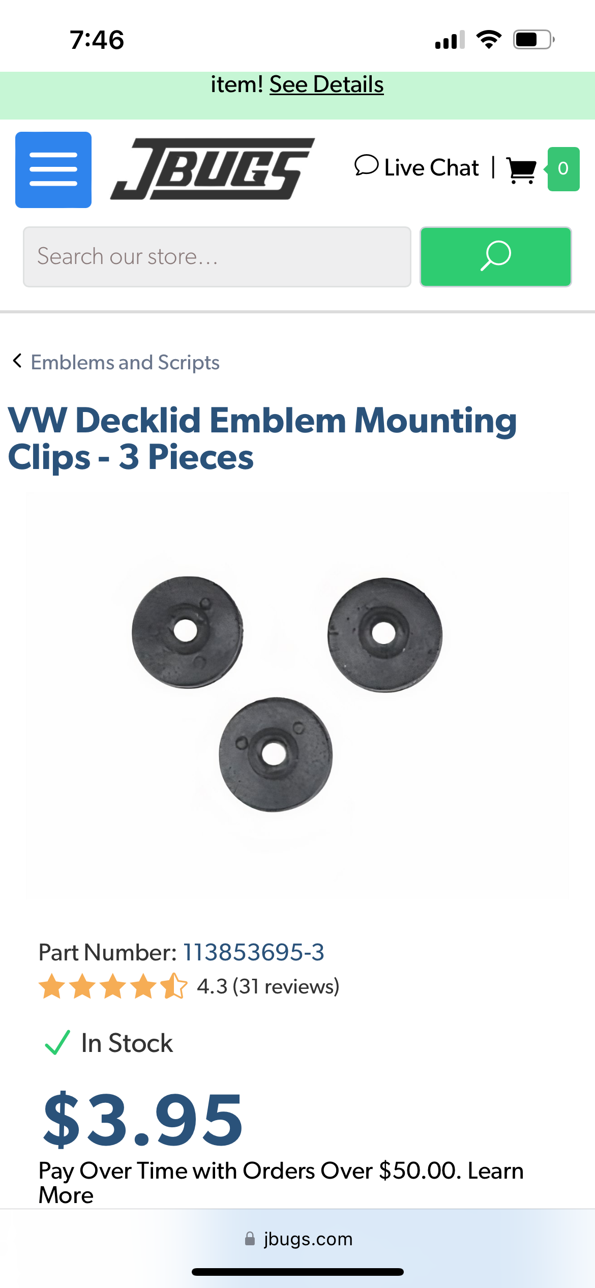

Found these on VW / Ghia - they look closer to OEM but I can’t vouch for them vs emblem pin diameter.

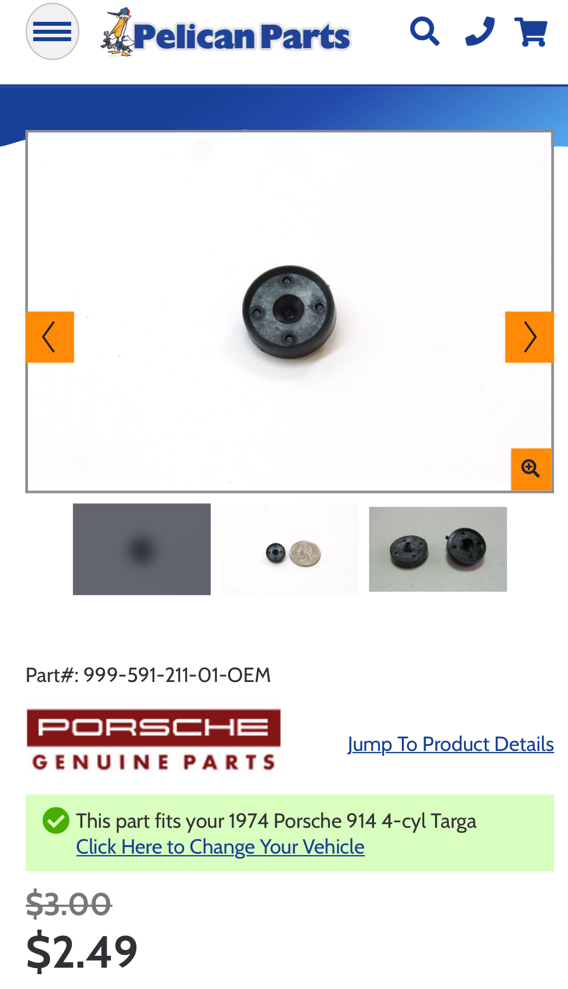

Also found these. Not cheap but closer to original than the stamped metal speed nuts and rubber backing.
