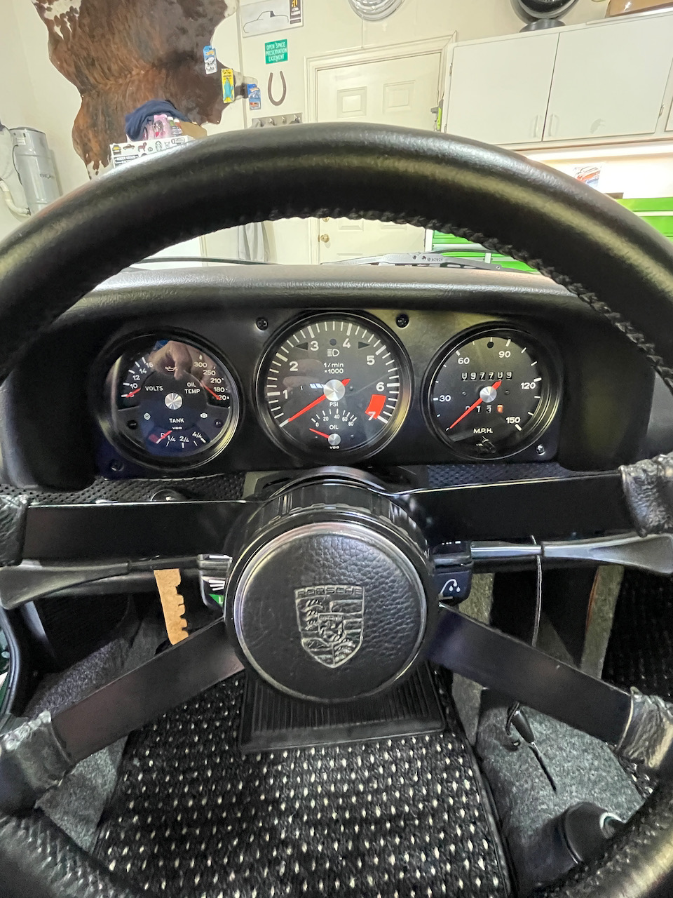

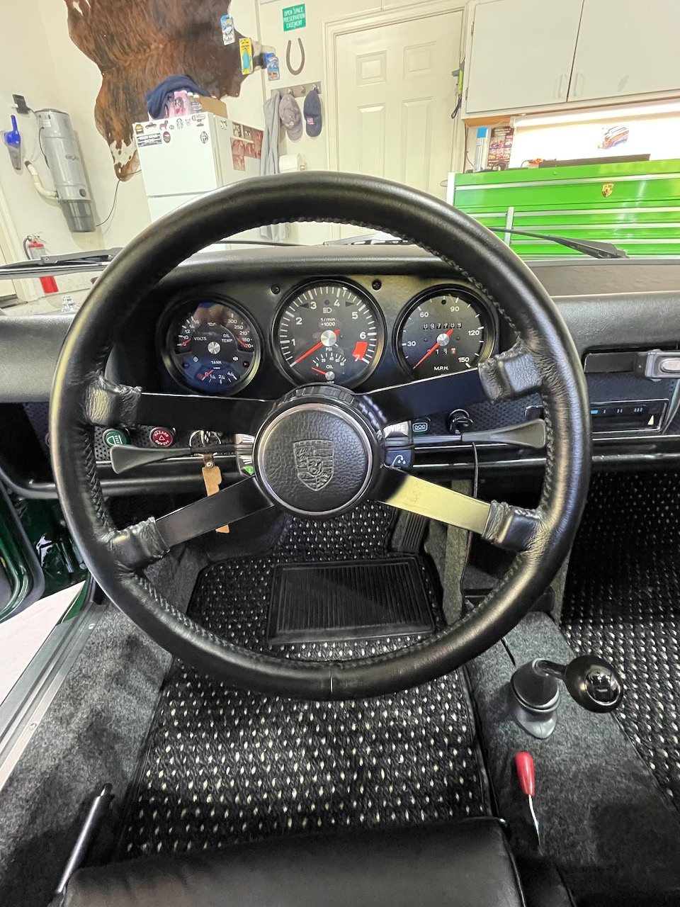

I always liked the center console. I bought a brand new '73 2.0 and it came fully loaded, included the console. My current 914-6 came with the factory "deposit box". It is nice and allows one to store sun glasses, etc., without much fuss. That is essentially just the front of the later console without the gauges or the part that separates the seats.
Thus is a terrific place to learn about these cars and to get answers to your questions. Good luck on your journey. beerchug.gif
Here are a couple pictures kind of showing my console:
