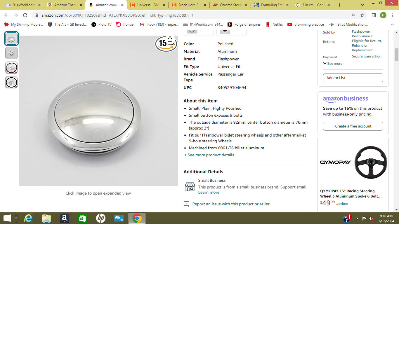

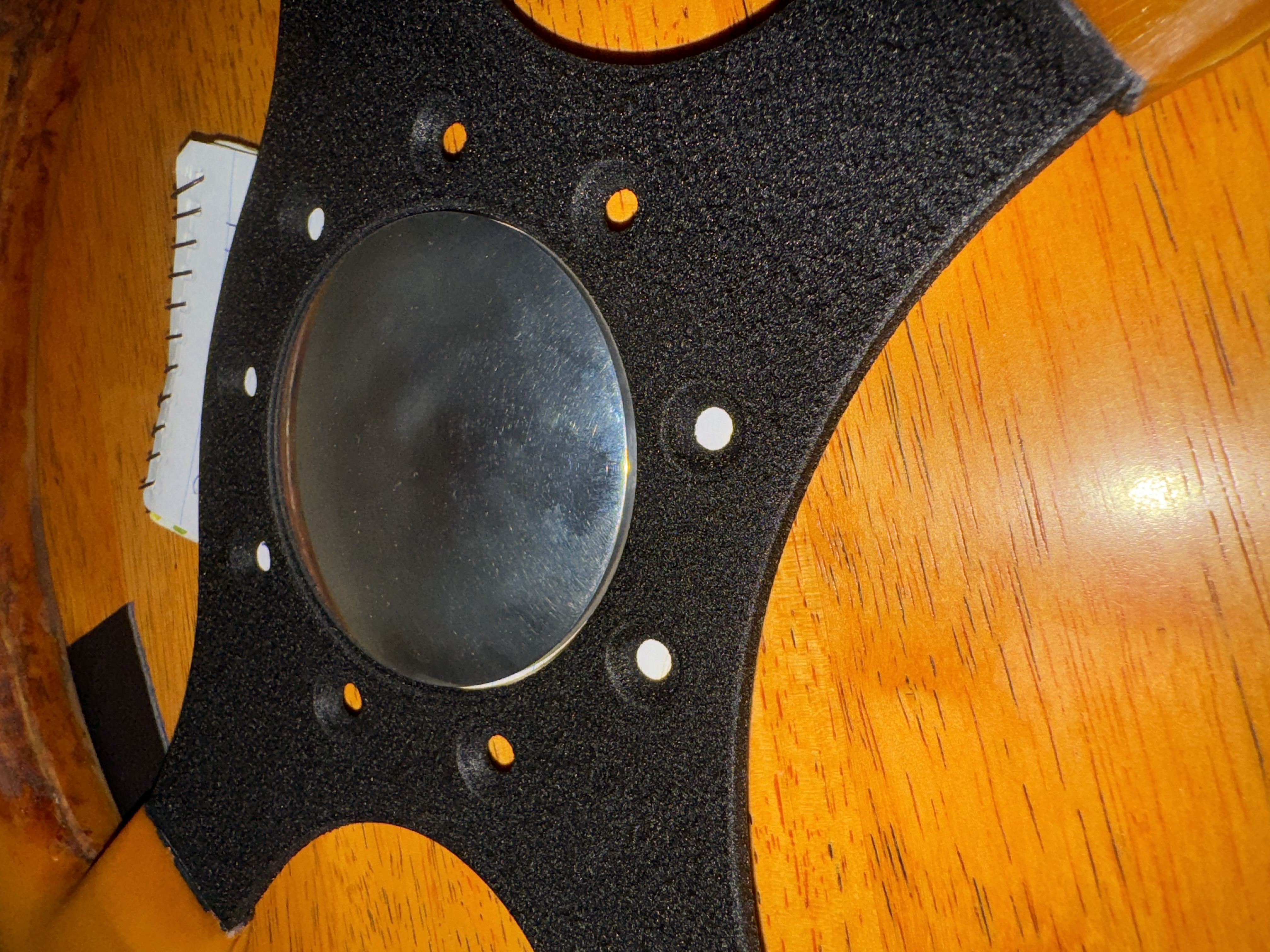

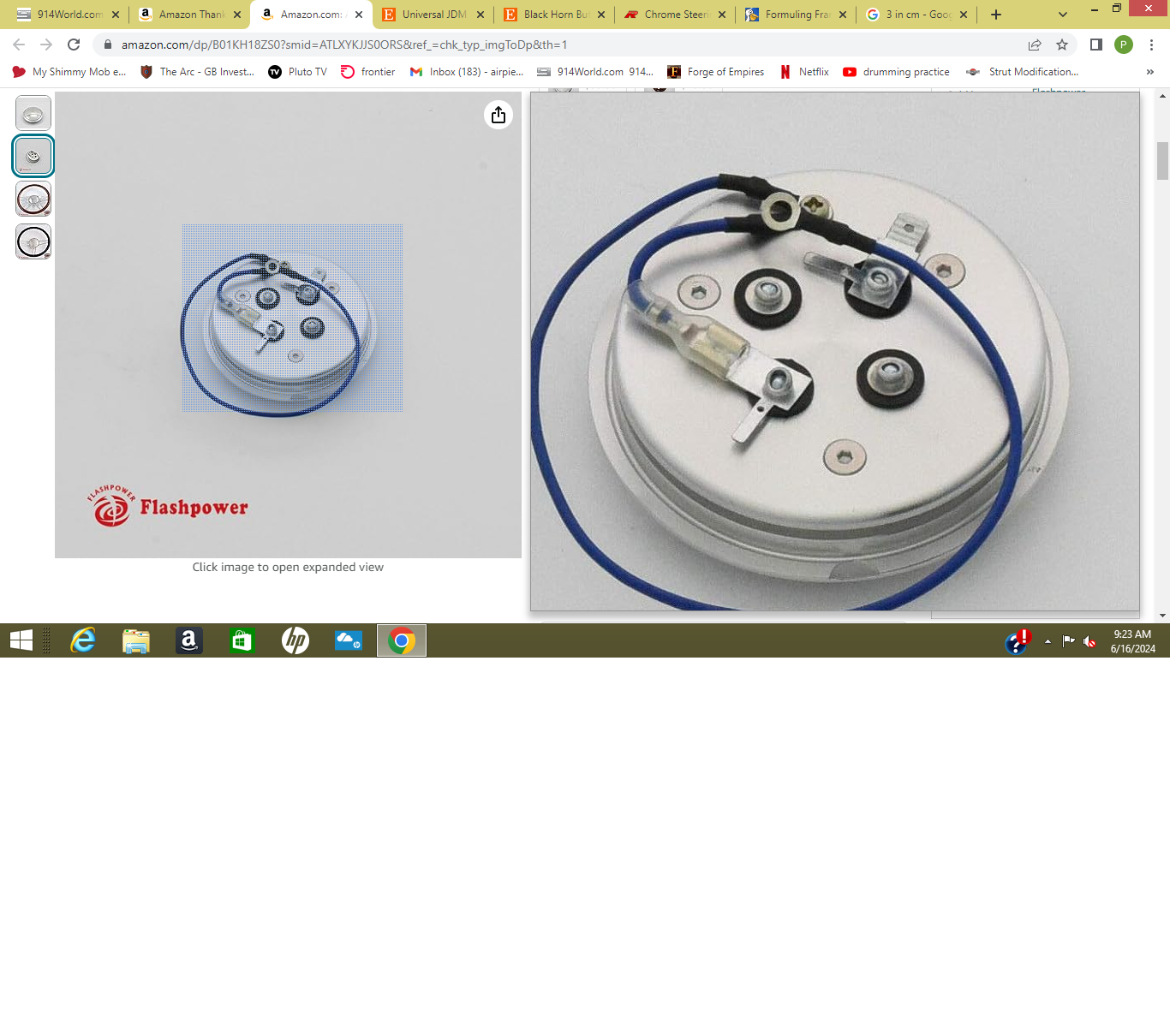

Got a aftermarket wheel in the 80's. Was able to find in the 90's a replacement horn button. Now and then I think I've found a unicorn supply but alas, no. Gave up a couple years ago and have been watching the aftermarket horn button producers. I think I found something. I'll paint it with krinkle paint, maybe lazier etching before. Not the same look but looks like it is going to fit right. I have one coming and I'll let you know how it goes. The back size is 2.99213 inches

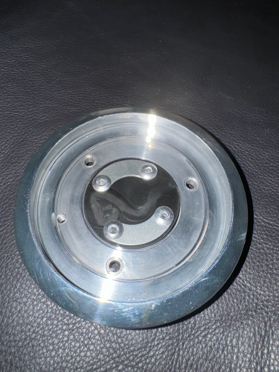

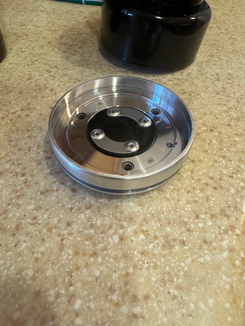

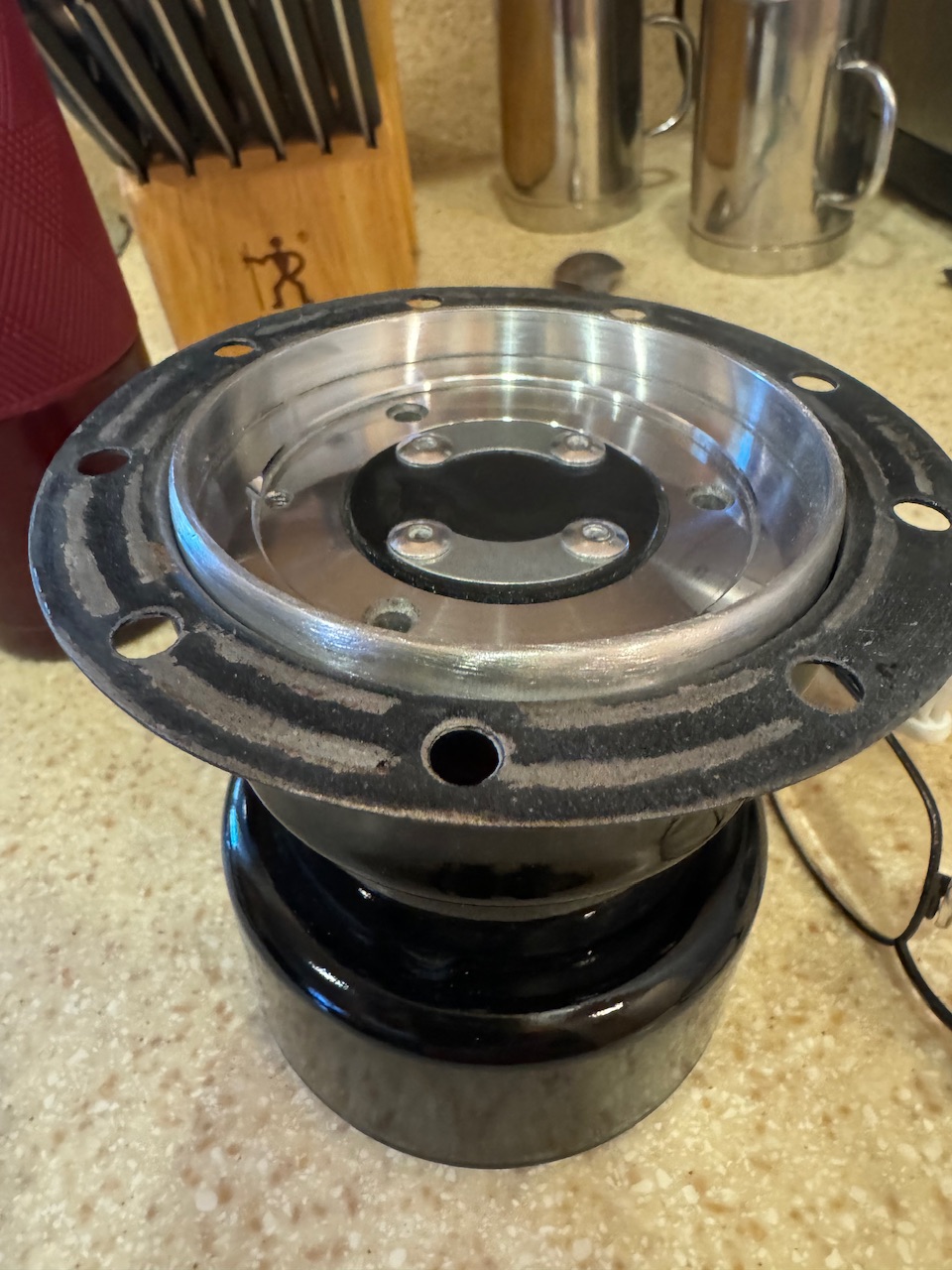

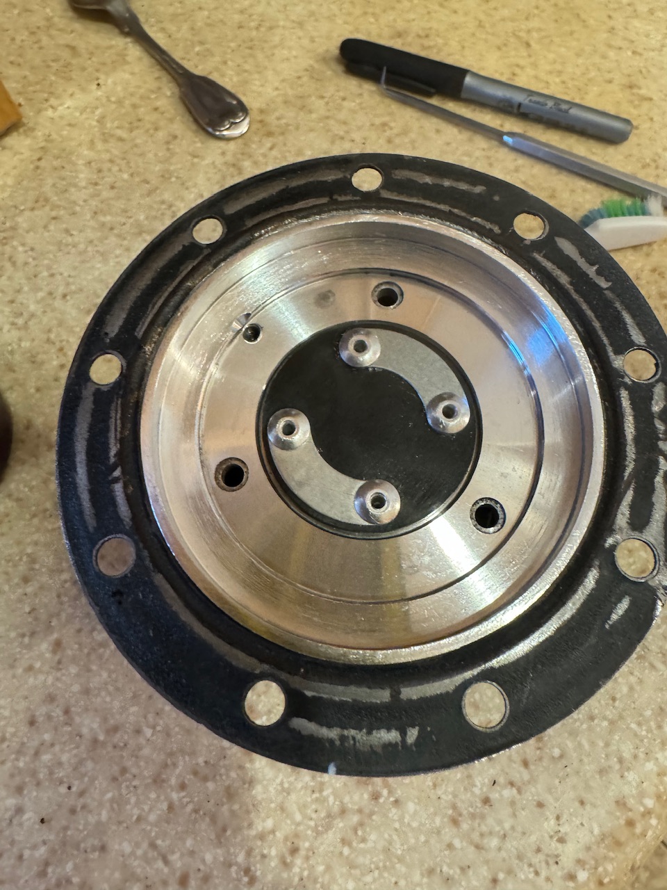

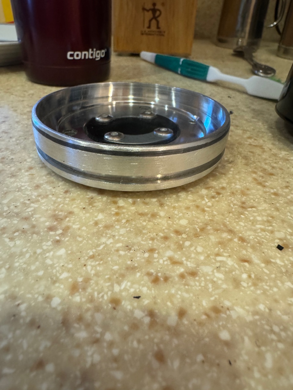

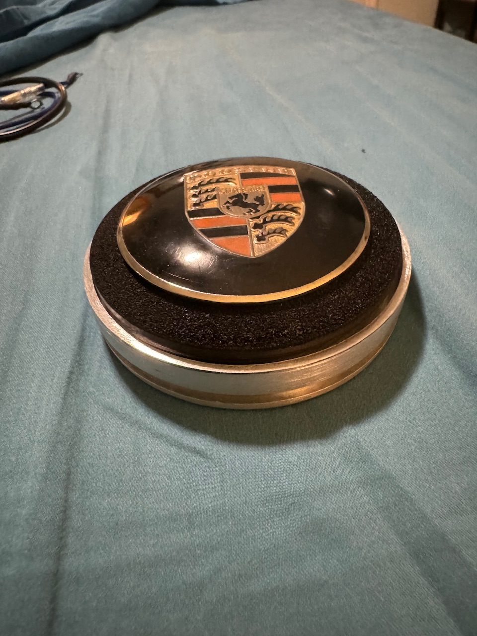

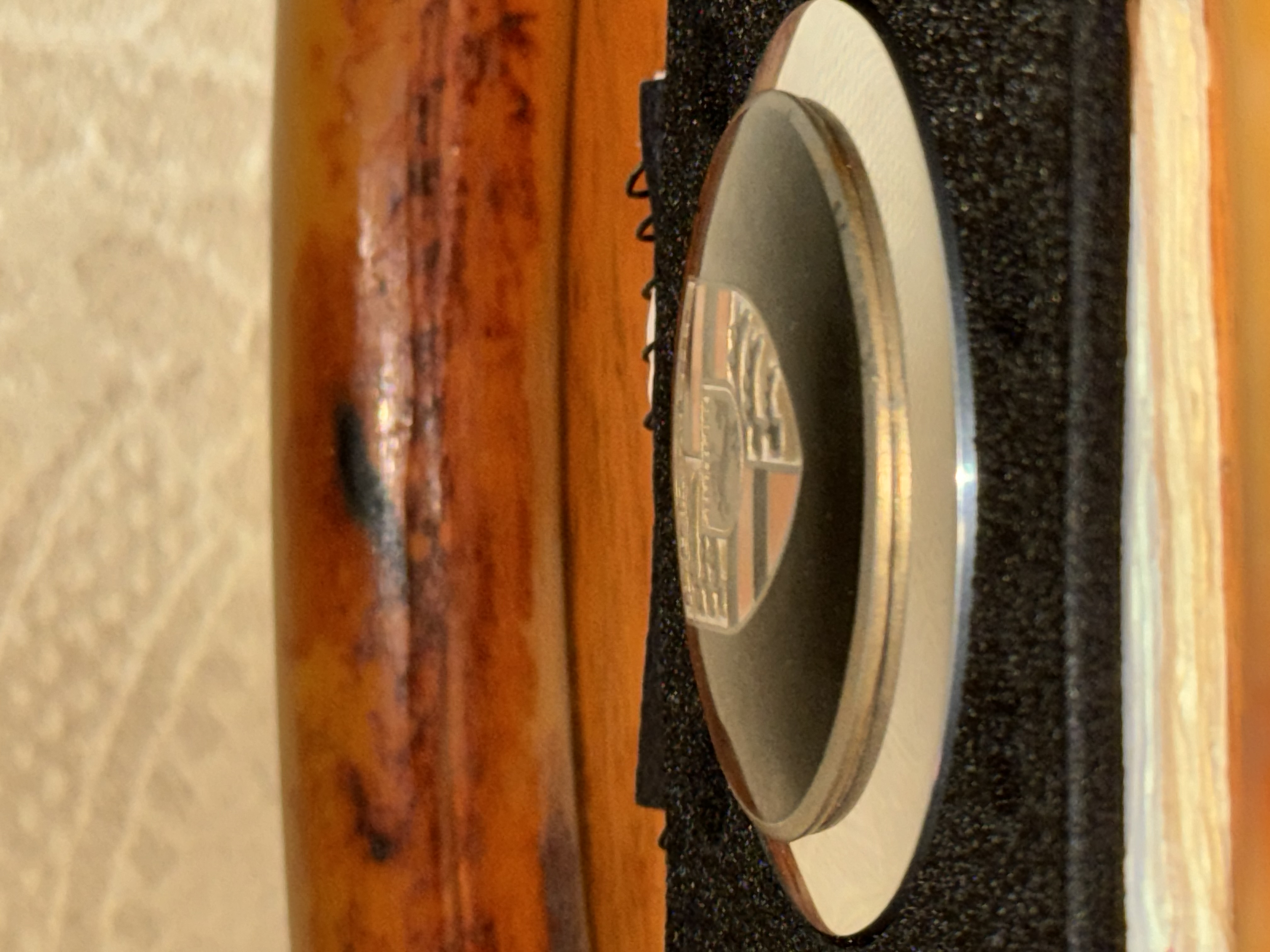

Well, nothing is easy lately smile.gif. Ok so when they say about 3” on the base, they actually mean 3 1/4” fat. Was admittedly bummed at first, then it was time to see if I could make lemonade. The base of this horn button with a little sanding will fit into the tube between the steering wheel and the factory column. So if I cut the top off the button housing I think I can end up with this:
I’ll paint it the same finish. So this piece will not just drop in. They fibbed

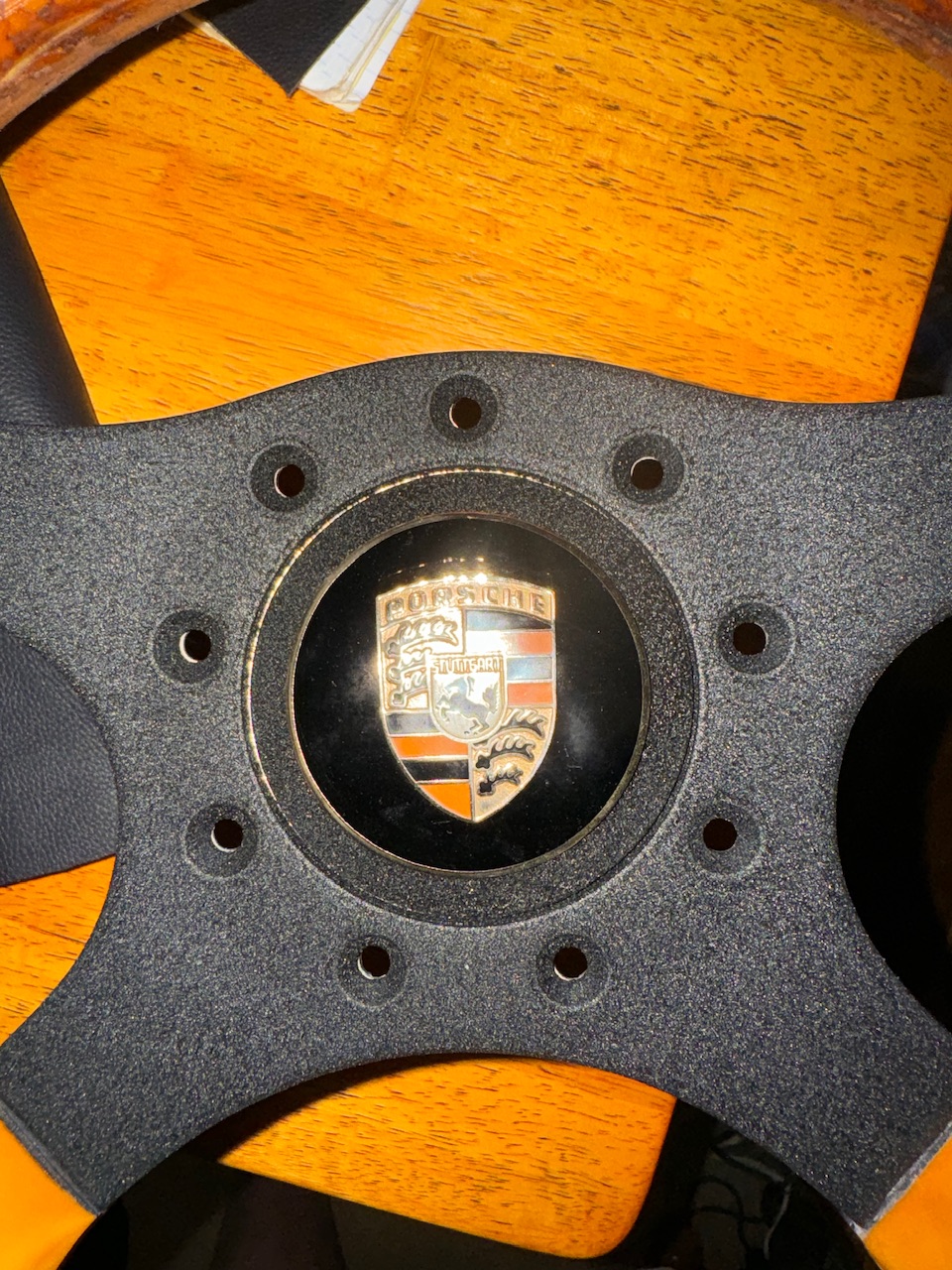

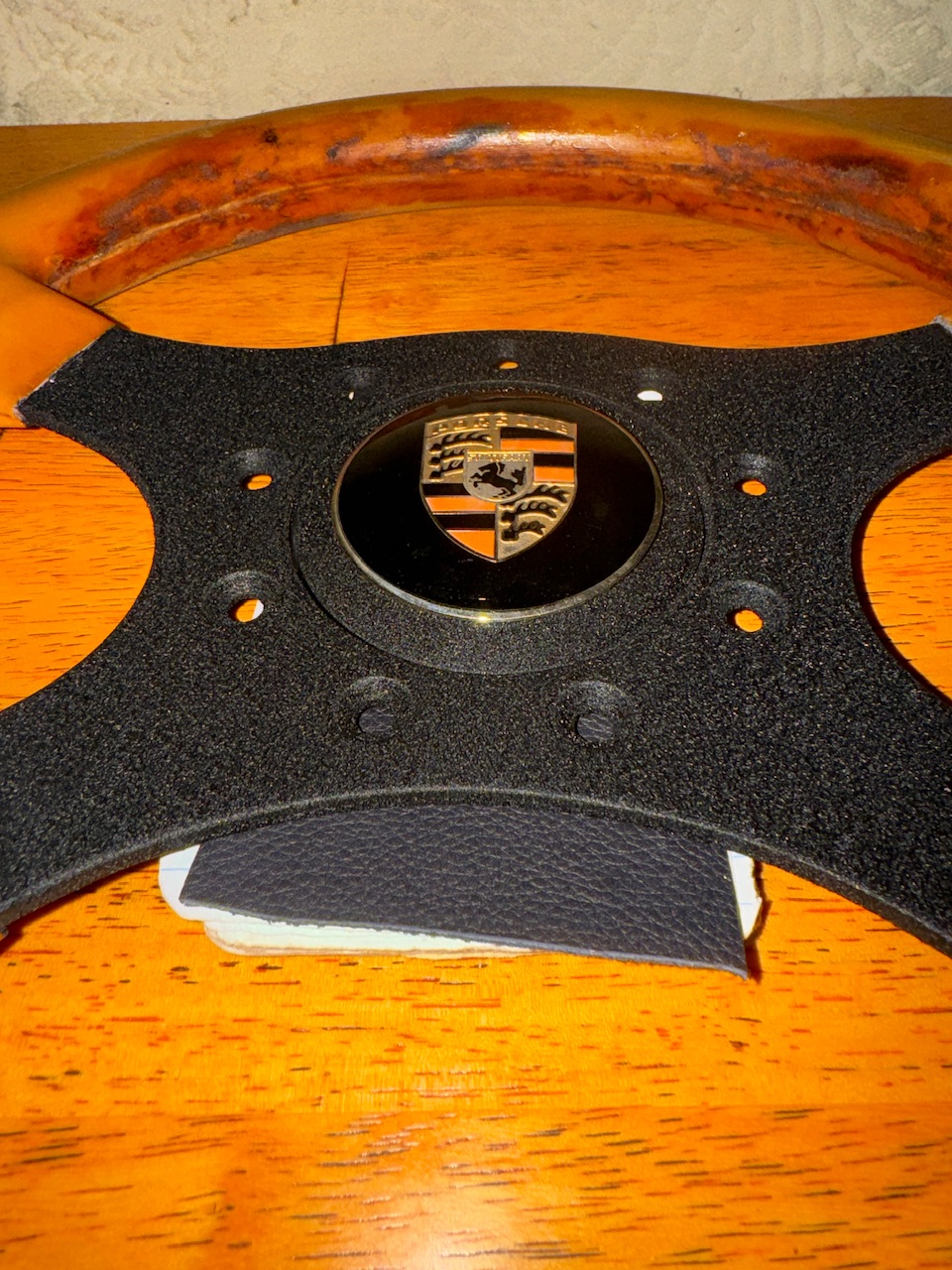

I may have to put this on. Even the radius is right. The car gets one of these on the rear. Opinions?
Shivers
Well, no body said that sucks. So I think I will do that, it mostly keeps the black with a touch of candy.
Shivers

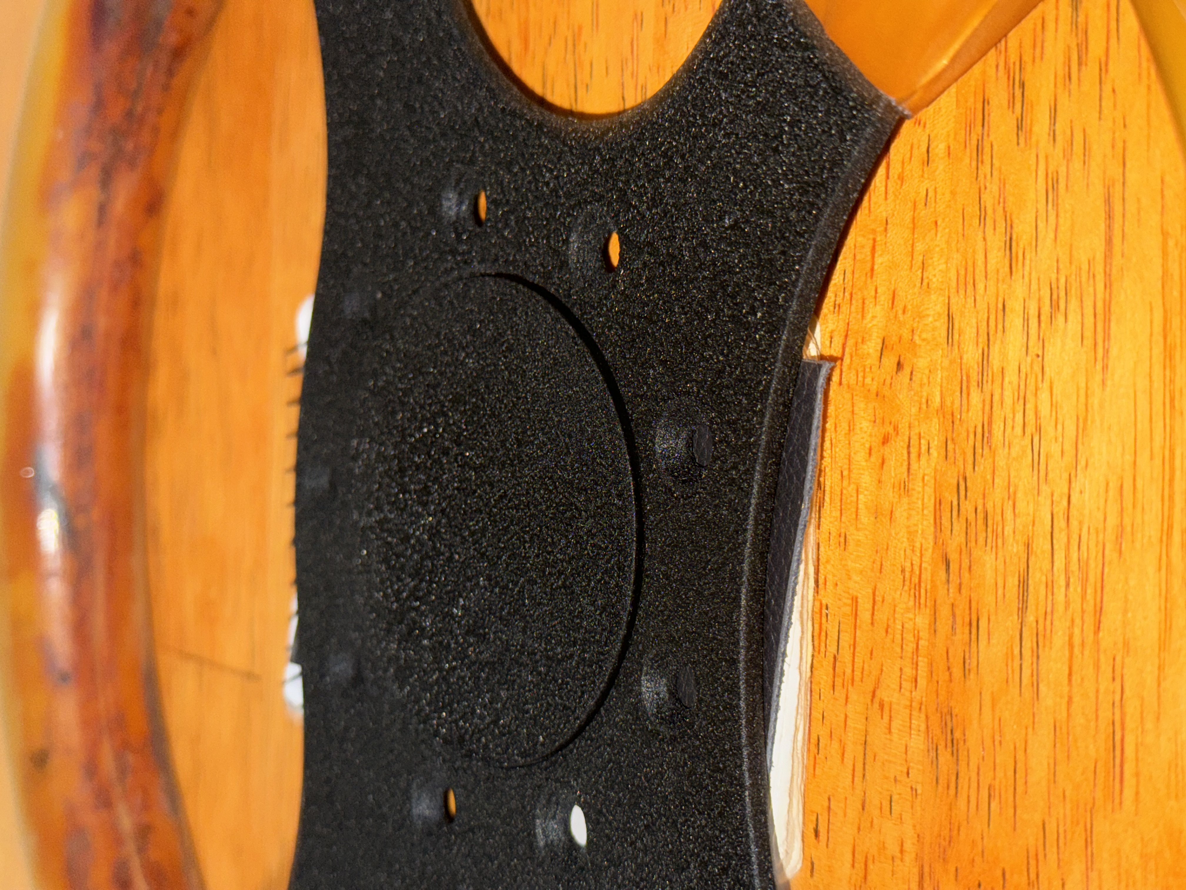

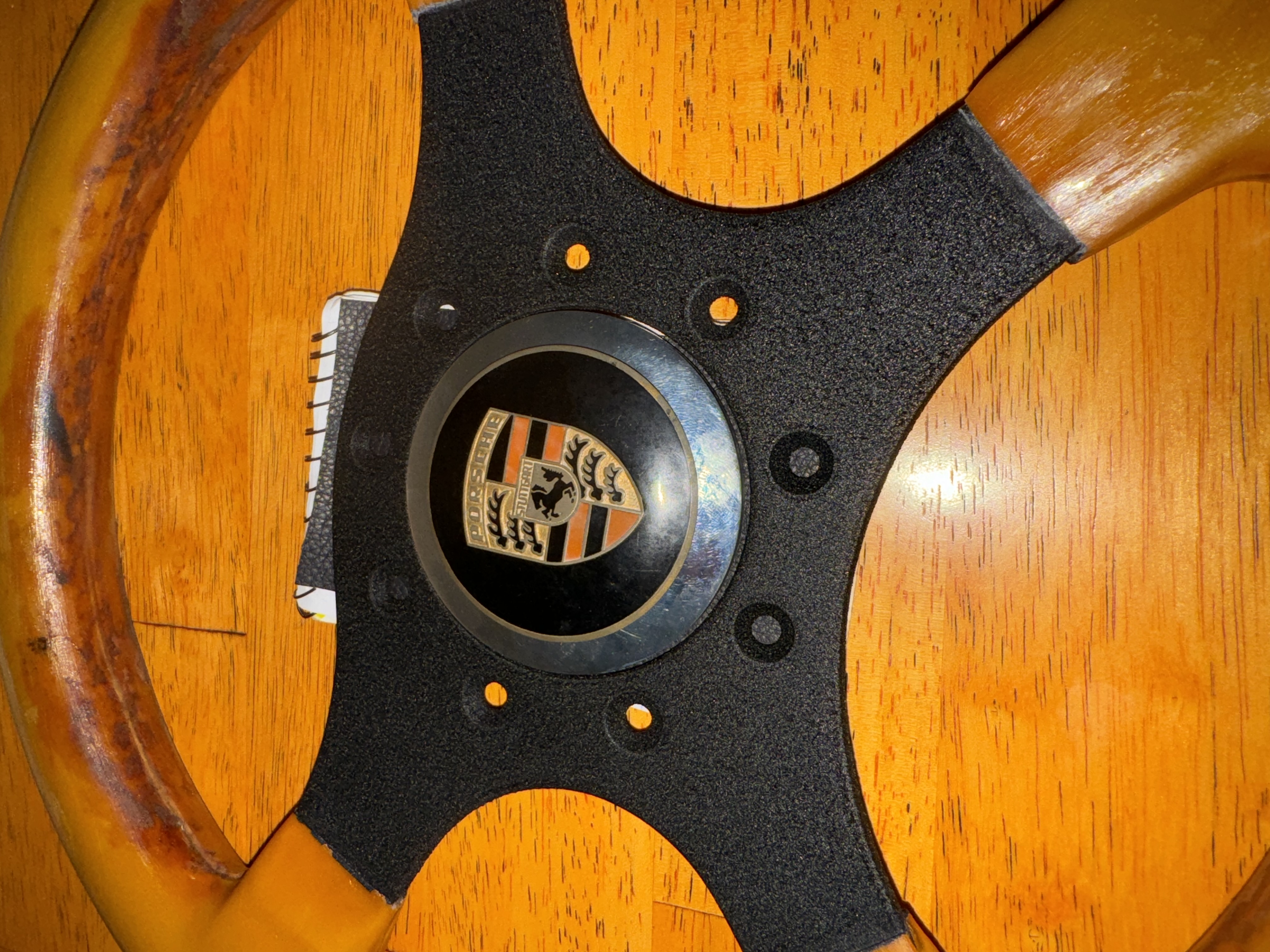

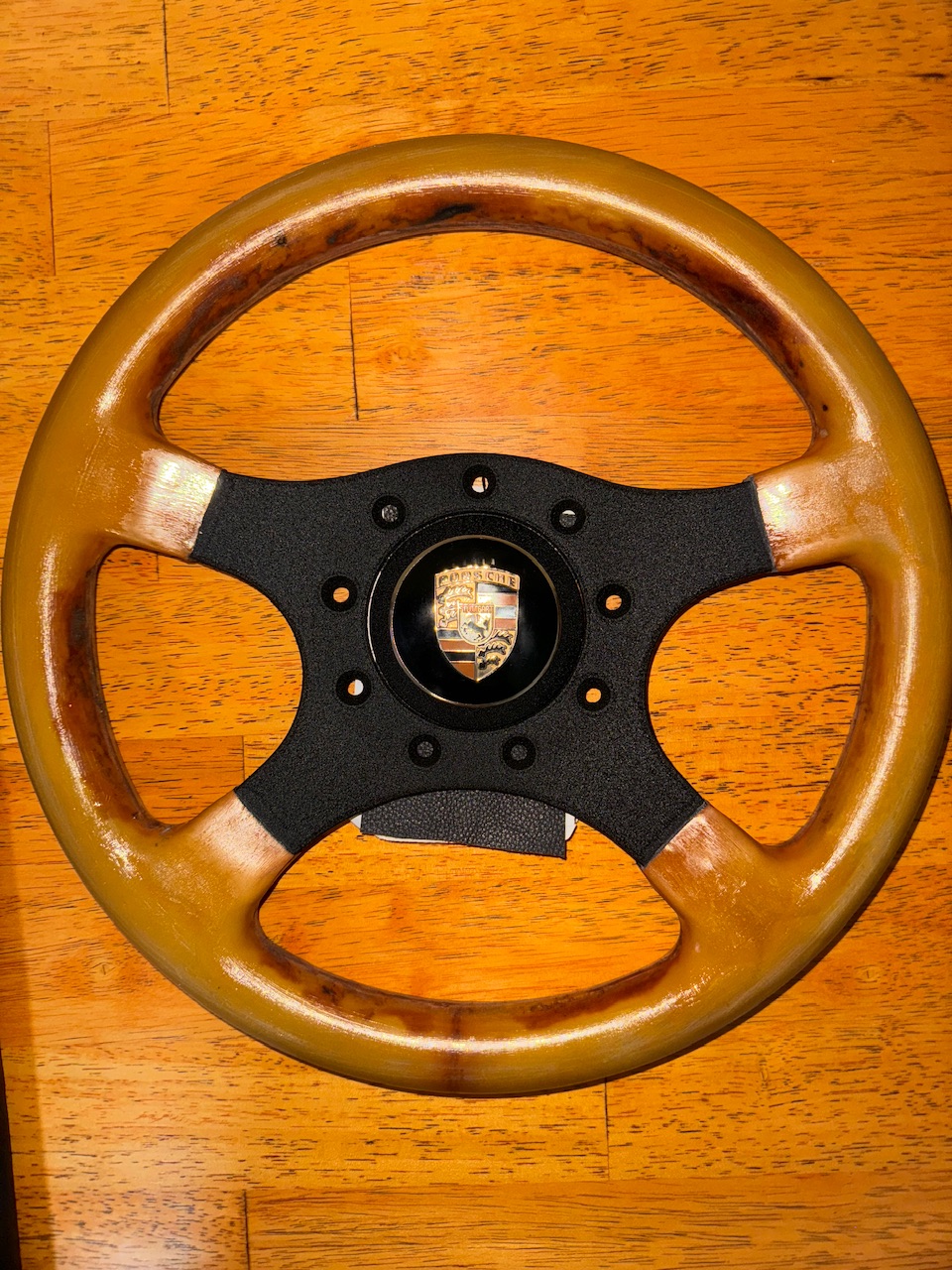

Easy peasy. My hands hurt like a mofo, but that is normal. A pic is worth a 1000 words, well there is 7000 for you. If you have a question please ask.
