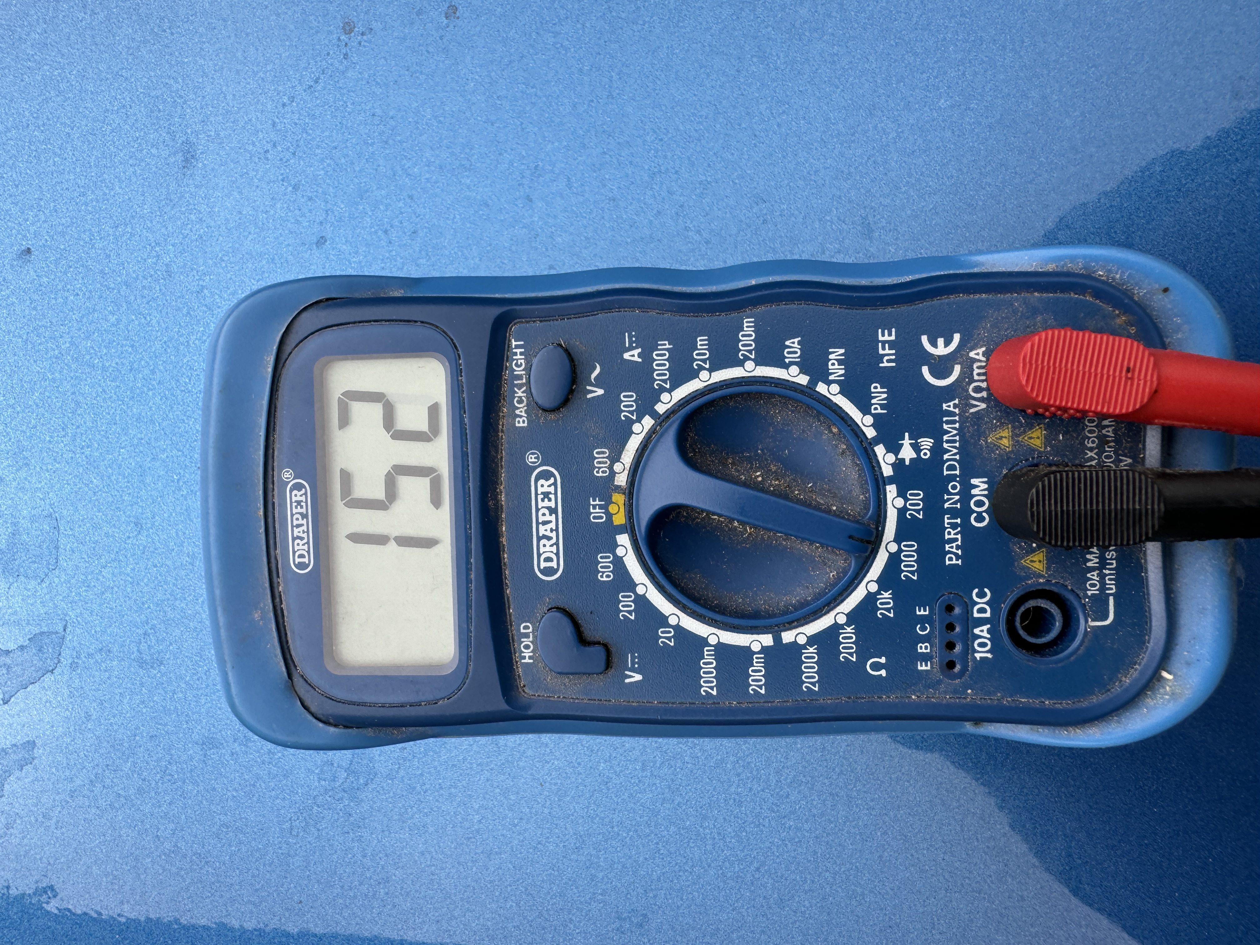

I’m not sure if this is relevant but when it does flood, if I unplug the injectors, turn the engine over, after a few cranks it’ll fire up and run for a few seconds on the fuel already in the system, then die. If I plug in the injectors then it’ll fire up and run. However it’s flooded so badly that the oil now smells of fuel.

Jun 22 2024, 04:39 AM
QUOTE(Halfnelson @ Jun 22 2024, 05:32 AM)
That really sounds like the CHT is open circuiting. I would find a good CHT (not the junk aftermarket ones currently available) and replace it. It is approximately $25.00 US, so it is a cheap investment to try to fix it.

Halfnelson
Jun 22 2024, 05:13 AM
Although the cht has been changed and I’ve tested it a couple of times, once when running ok, once when it wouldn’t start, I have an another new one to swap in. I’m also going to test it from ecu plug 23 to see if it’s something in the wire.

Tested the CHT sender... this was the reading.

Click to view attachmentMy car did this when I first got it.
An MPS begining to fail....cracked.
As far as the CHT....you need to note what temperature the OHMS reading was taken and for what CHT meaning what part number.

This was hot, not sure on specific temp but could measure next time. I did one at 60 degrees and it was right on the expected reading. It’s not the original sender but the standard replacement 1.7. That ends in 012.
Gonna start going through everything again methodically starting with MPS.
