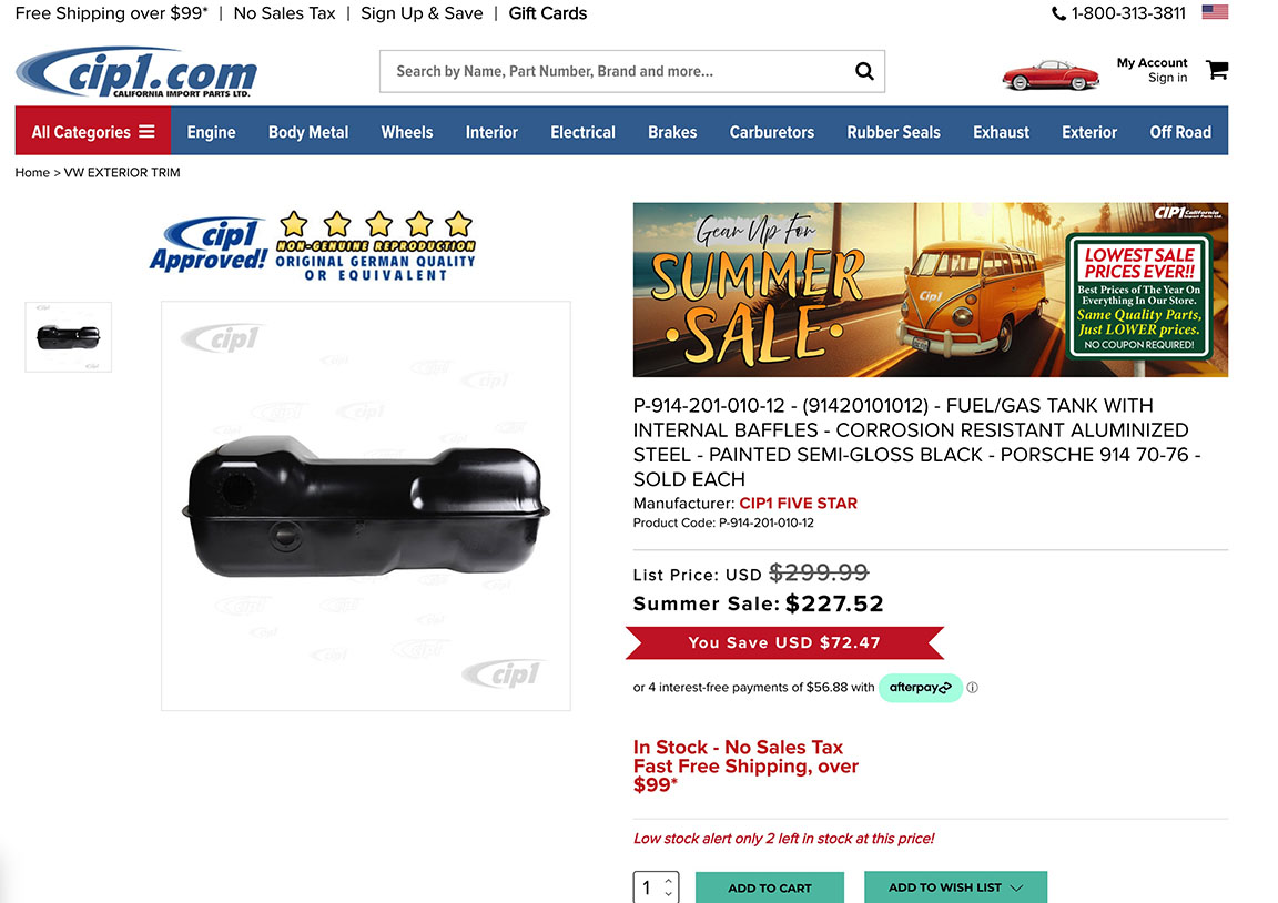

It would seen to me that you can get a new tank for $227. All in no tax no shipping.
The cost of solvent is several $, Not a big deal to install the tank on no fire risk and no solvent to breath. You can sell the old tank for a few $ later

I bought one from "parts geek" for my 75 BEFORE I even looked at the one I have.
Was about 250 all in...
Stupid cheap IMO.

This is a tiny amount of foreign substance at the bottom, the tank is great, no need to pull it or replace it. I probably don't have to do anything but i am. I will replace the screen since it is drained already. I already have scope creep on this item and too many other items to list. But yes I do have a list. The list grows but the progress does not.
